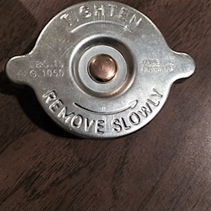

Maybe you have the same problem I had when I replaced the pressure cap on my brown "header" tank and experienced a leak - just like you have. What I found was that the new cap had only one seal, not two as is required.
My brown header tank is plumbed to an overflow tank behind the driver's side wing, as Carl has described. I think that the way it is supposed to work is, that as the coolant expands beyond a certain point, the pressure cap relieves and (1) the coolant flows from the header tank to the overflow tank and (2) as the coolant cools down a vacuum is created in the system and coolant is sucked from the overflow tank back into the system.
But in order to direct the excess coolant to the overflow tank, and then create that vacuum, you need a seal between the lip of the header tank and the cap, otherwise the coolant will escape from underneath the cap and drip from the header tank and you will never get a vacuum.
You can see in the photos, that this particular cap has only the primary (relieving) seal, but nothing to seal the header tank from the atmosphere - just a ribbed steel surface. So I was losing coolant, but never recovering it. The cap is a Quinton Hasell FC56.
I got the proper cap and everything now works as it should.
