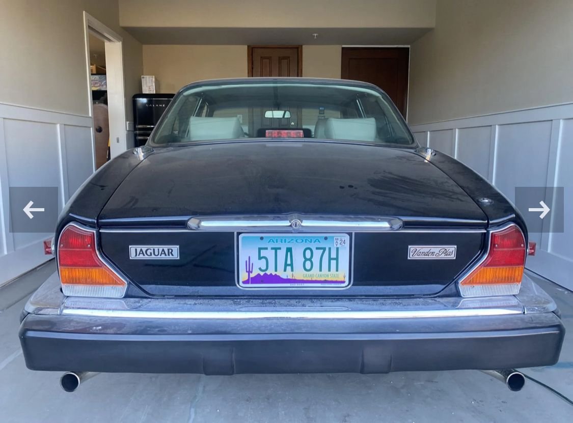

Hi friends, we are selling our Series III on BaT and had a prospective buyer point out that the badge placement is too "inward". Is this out of the ordinary or just a funky lot to come off the Jaguar assembly line this way? Thank you for your thoughts!
rear badge placement?

did they buy it?.....does it matter? looks just fine from here

They are too far inward… this is a VDP but I’m pretty sure someone will post an XJ6 image.

Ken monologuing,..........actually looks good in spacing - proportional to the # plate

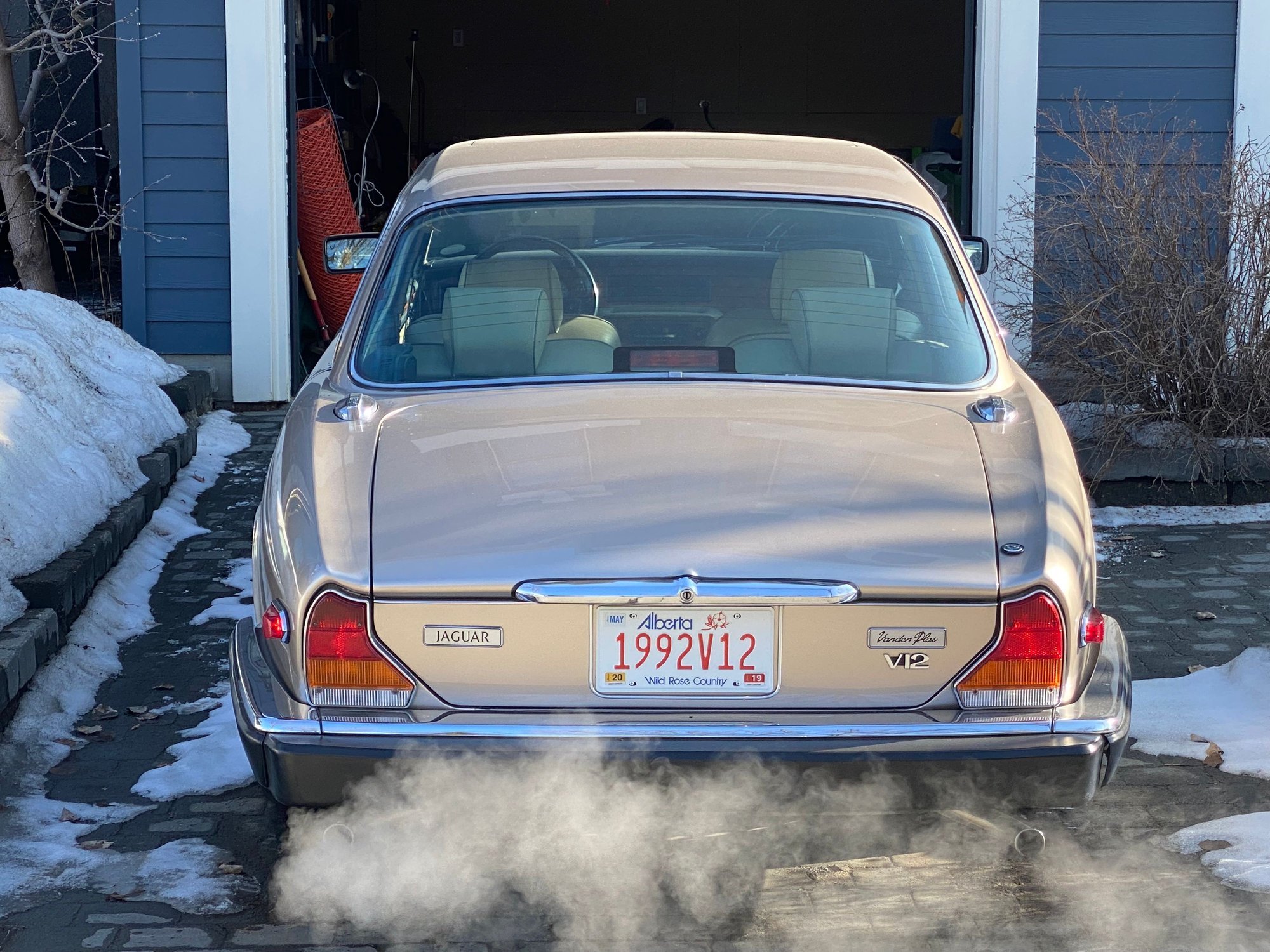

This one also looks good:
It’s the last photo in the BAT listing and is presumably the car in the garage behind the one actually being offered for sale.
The car in the sale actually also looks good in its photographs which only begs the question of why a car with only 24k miles has strangely placed trunk badges.

the XJ6 badge is not in its factory normal position. The original pin holes for the badge must have been bondoed over.

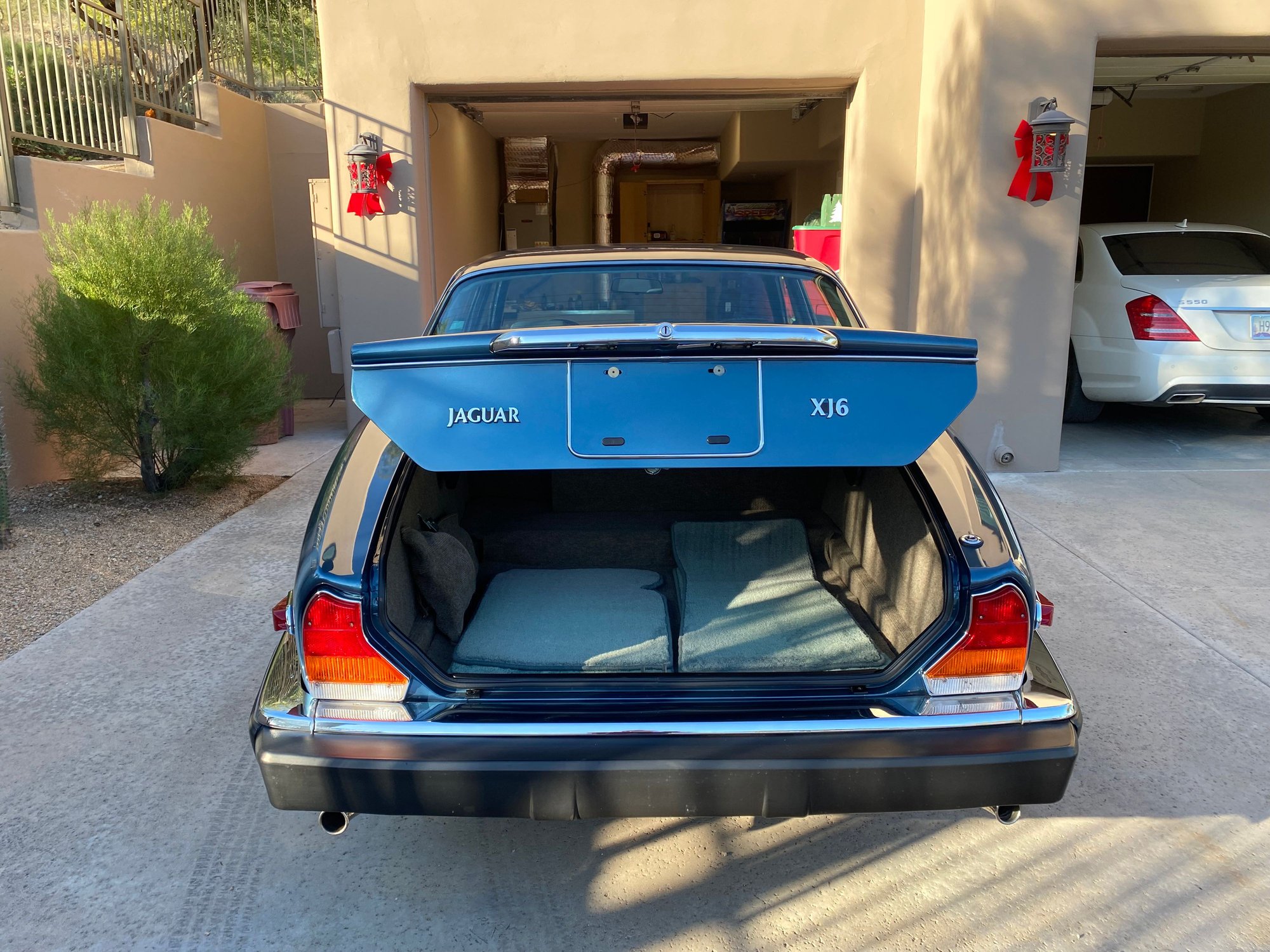

Friends, I did a little research on XJ6 rear badge placement. The badges on some of the later cars used a double-sided adhesive tape, and not pins – (see photo). I also confirmed that there is no evidence of covered pinholes on the inside surface of the rear deck on this car. Sadly, she is going to a new owner in 3 hours at the end of my BaT auction
