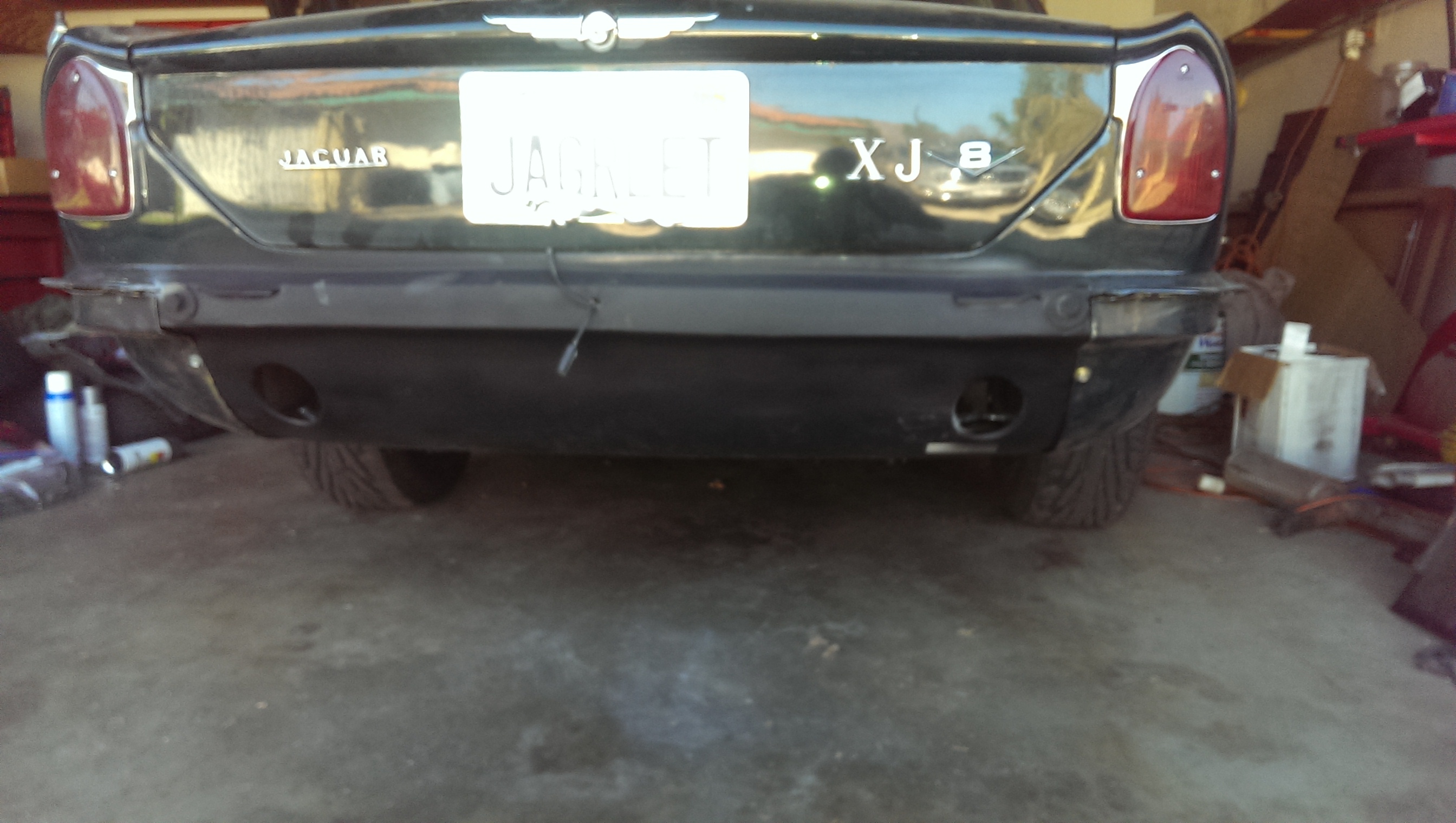

Default I got brand new one from SNG Barratt
David suggested getting the new one due to costs in shipping and the labor
in removal. Rear valance was less than $200.00 shipped to me...
It fits S1, S2 and S3.... it is now installed and I replaced it as the PO had welded the exhaust holes shut and they exited under the valance.
