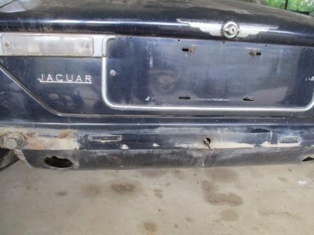

Two questions in relation to the rear valance or beaver panel on the XJ6/XJ12.
I have the rear bumpers off both my cars at present. The blue XJ12 will need some panel repair, the red XJ6 just repaired the fuel line from the tank to the pumps.
I note some numbers stamped on a plate fixed to this panel. What do they mean? They are not the same as the body number. The red car has one number J 026610, the blue car has two, J 024383 and 4P1637.
Finally I will need to remove the panel from the blue car. I am not that skilled in panel work, but what is the best method to cut this panel off, using what tools?

those valance panels are spot welded along 3 or 4 sides. you will need to slice through the spot welds with a power cutter wheel, then grind off the remaining welds.
Due to the close proximity to the tanks, I would remove the tanks and seal / move all fuel lines away from the work area. A grinder produces sparks when cutting through welds.

I actually did this job in the very late 80s, (1989, I think). I also fitted a new boot floor, plus the screw-on quarter panels. I first tried with a rather too cheap pattern valence. That did not fit ! The bottom of the boot where the lid comes down looks a straight line, but is curved very slightly horizantally, but the pattern one wasn't. OK you get what you pay for. As I was going on holiday, I cobbled it together using some self tappers, then when I was back, I managed to find a genuine factory valence that fitted like the proverbial glove. Take Jose's advice and remove all the fuel tanks and associated plumbing. I see these valances are available, but if not made on the factory tooling, one will only know how much fettling work is needed when offering the panel up to the car.

I used to cut those valances off pretty regularly... The thing that always surprised me the most was the number of metal panels that fold into the the rear valance. Particularly the boot floor lining towards the bottom, and the pieces that the side valances bolt to... All of that is pretty intermingled....
Then I found that SNG sells those panels pretty cheap, and outside of a few patch panels, I stopped trying to remove them for using them again...
https://www.sngbarratt.com/English/#...0%60valance%60
I'd probably go the route of a new one if it's an option. I think it will be an easier option for you...

Spot cutting "drill bits" are readily available through Eastwood, Amazon, and others. Here is just one retailer. https://www.autobodytoolmart.com/category/spot-welders

Plasma cutter works as well.
Cuts a hole through both panels, Ok if you are replacing one of the panels and can get access from the hole for welding! "Hole" can be tidied up with a drill if needed.
