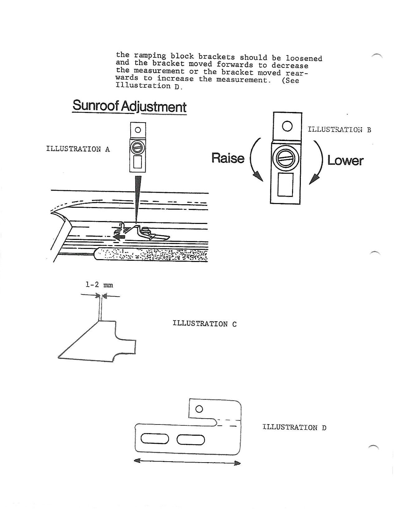

This should help.
Old May 15, 2025 | 10:43 AM
Coventry Foundation's Avatar
Joined: Aug 2018
Posts: 772
Likes: 391
You may need this if there is a problem.

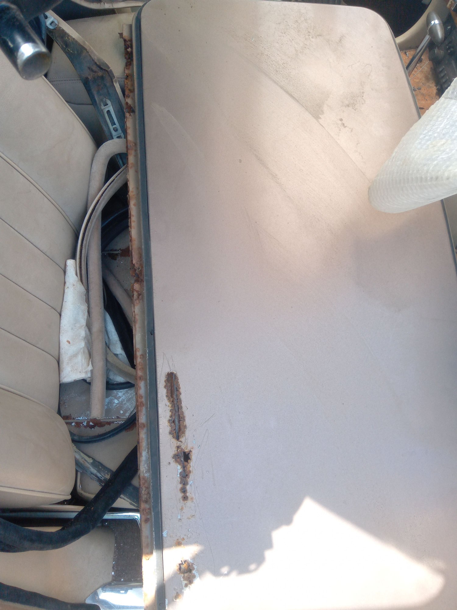

I have successfully remove the panel and ready for restoration, I may order a new rubber seal for it.

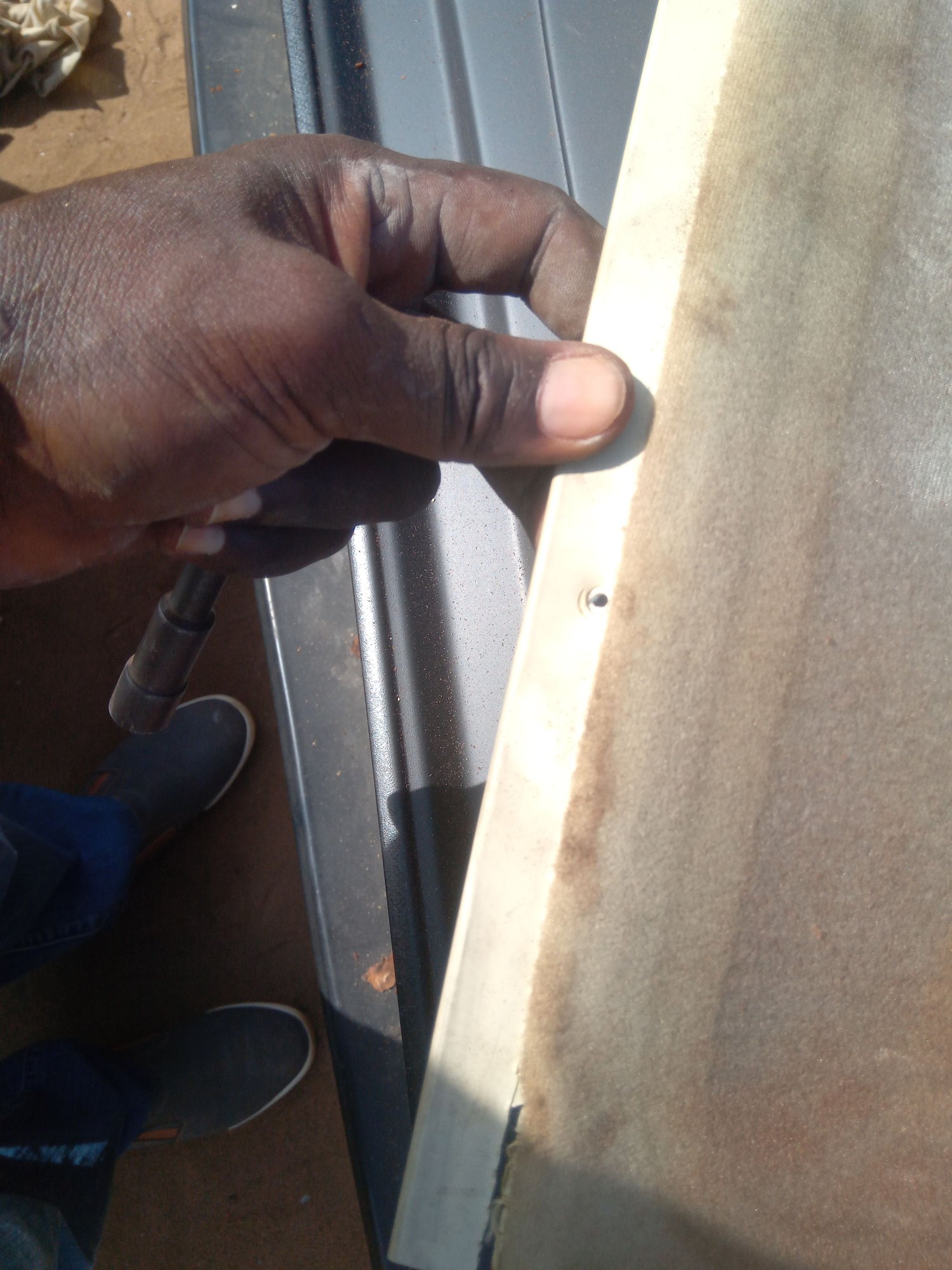

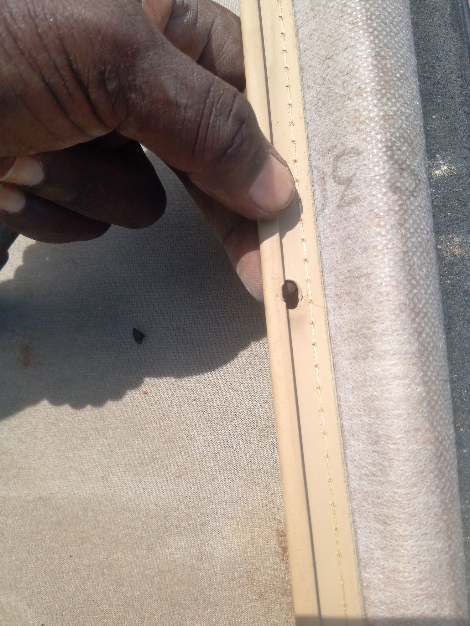

Please what's the name of this plastic hooking the sunroof panel cloth to the panel and where can I find it to buy because the one my panel have expired and been broken.
I want to relining the panel and I will need that or how did you do your relining?
