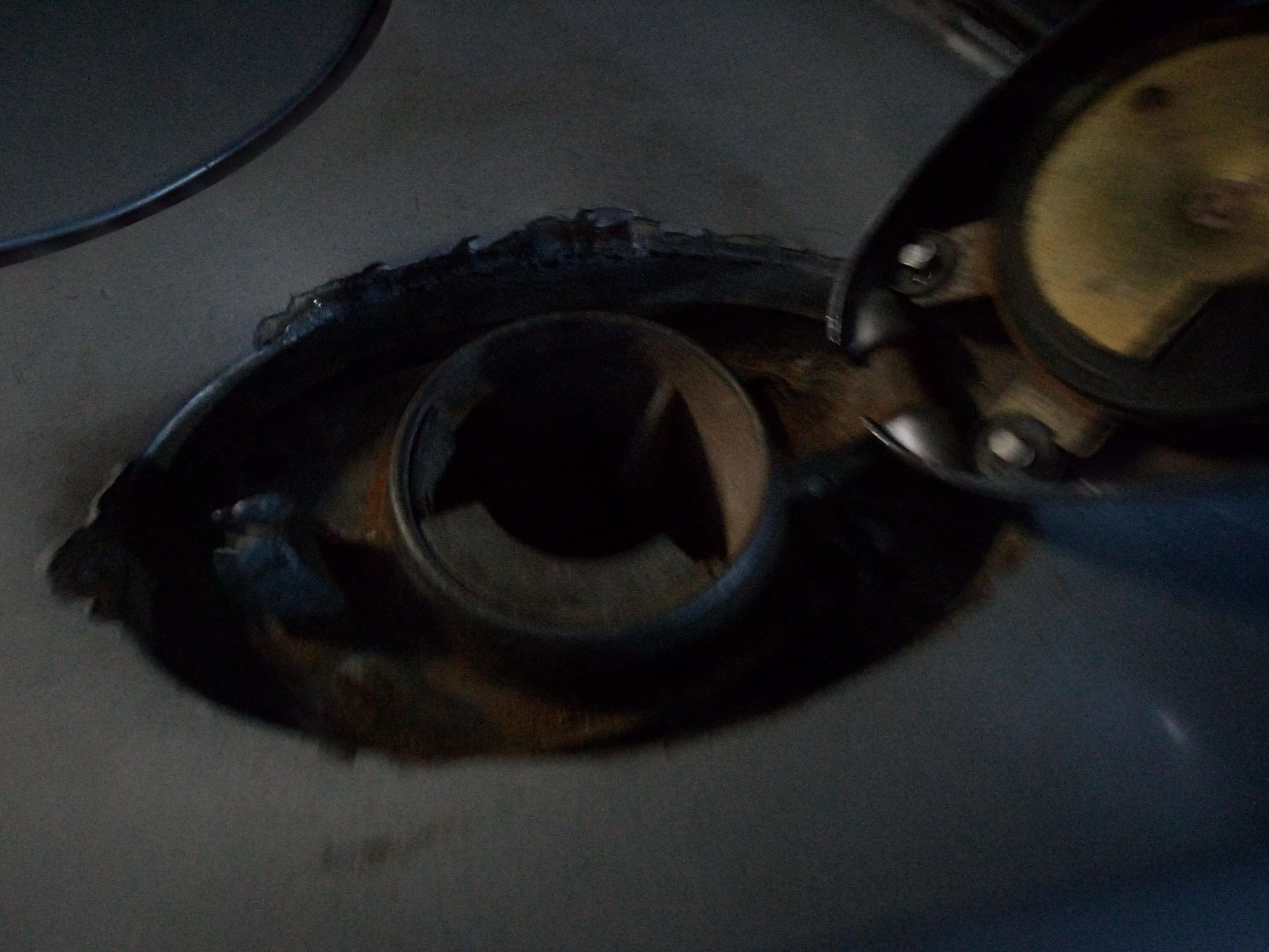

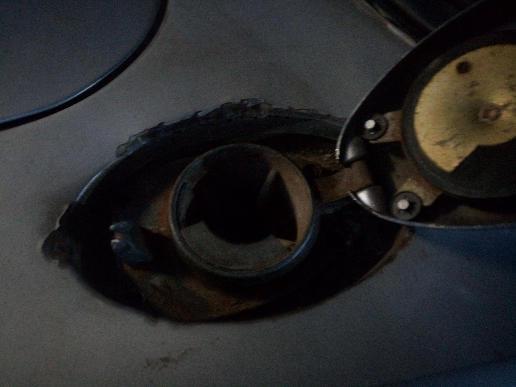

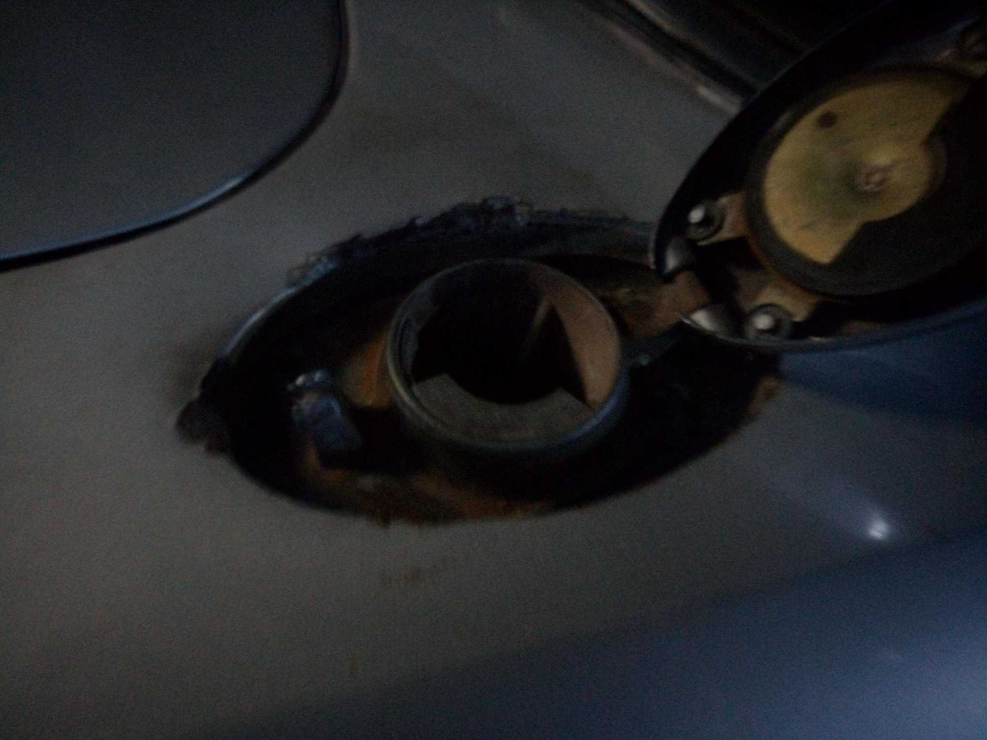

Just visited the shop and there is a paint damage as attach photos.
I took the photos this evening at about 6:35 so they are not so clear.
We are planning cutting the top body plate around the filler and weld it back afterwards because its been over a month now and tank is still not able to removed.

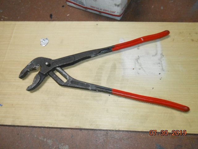

I had the same issue with one of my Series 3 cars.
4 screws hold the filler pipe to the body of the car. (I think you have already removed those).
Remove the chrome flap. It is attached to the filler pipe with a roll pin.
Reinstall a couple of bolts to hold the tank firm.
If the tank is loose, trying to turn the filler pipe will also turn the tank so nothing will happen.
With the tank fixed to the body of the car, grab the filler pipe and turn clockwise and counterclockwise.
There is rust accumulated there. You have to break the rust free in order to get the filler pipe to move.
Trying to lever the filler pipe upwards will not work. The O-ring fits into a small groove in the tank.
I used this to remove mine.
this is what I used to remove my filler pipe. 16 inch adjustable locking pliers.
