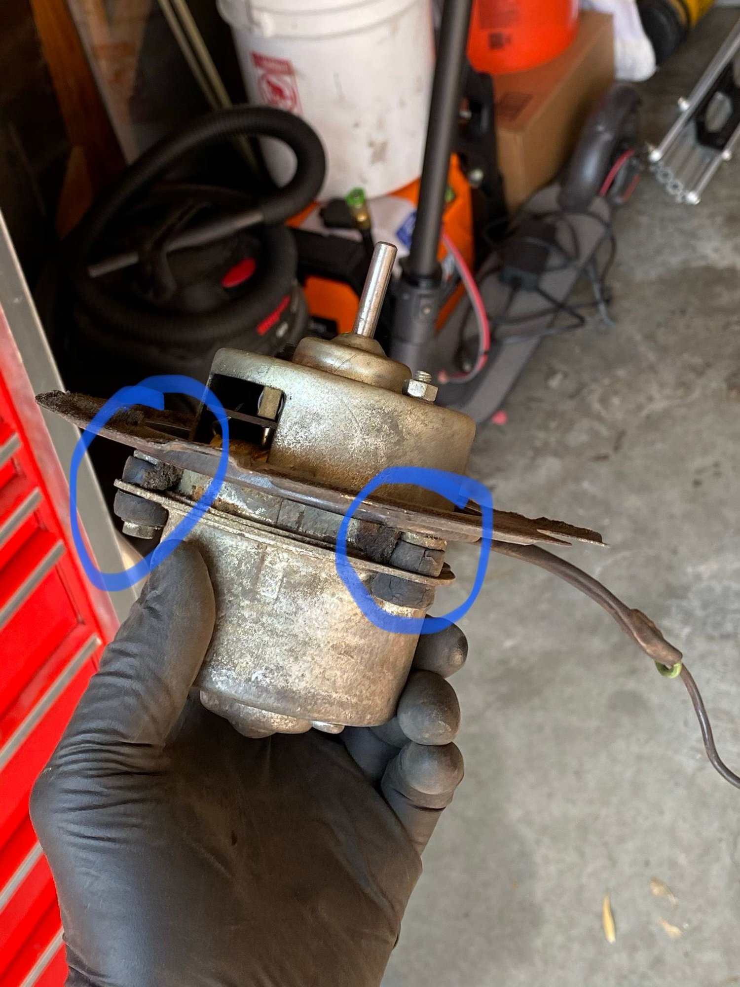

Does anybody have a part number for these guys? Mine are hard as a rock and I can really feel/hear the fans in the cabin. Series 1 ‘70

Try cutting off short pieces of appropriate I.D. vacuum tubing, the all rubber non-reinforced type.

buffers or isolators they are called.
measure the outside and inside diameter and the height of the best one.
you can find generic ones online using the measurements and searching for "rubber buffers".
depending on their size, to me they look like sway bar link bushings repurposed.

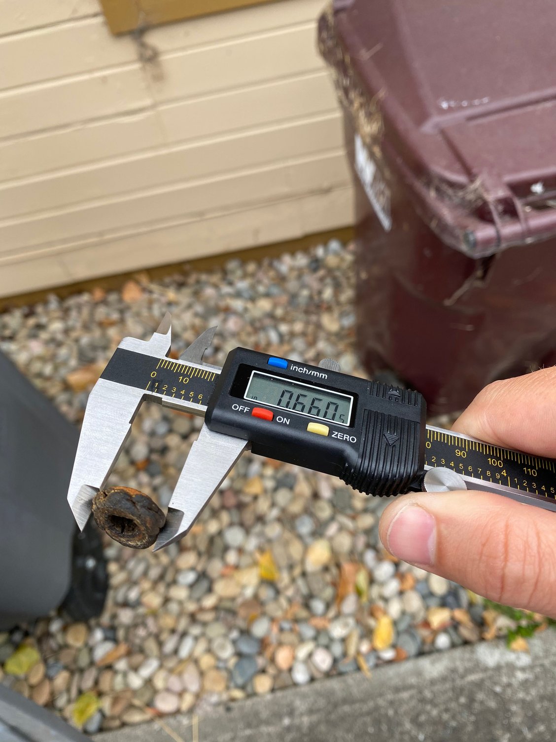

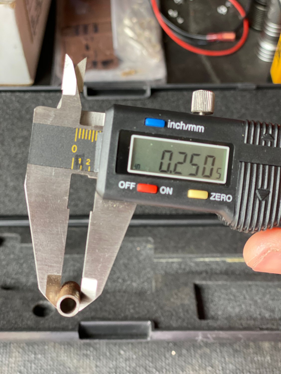

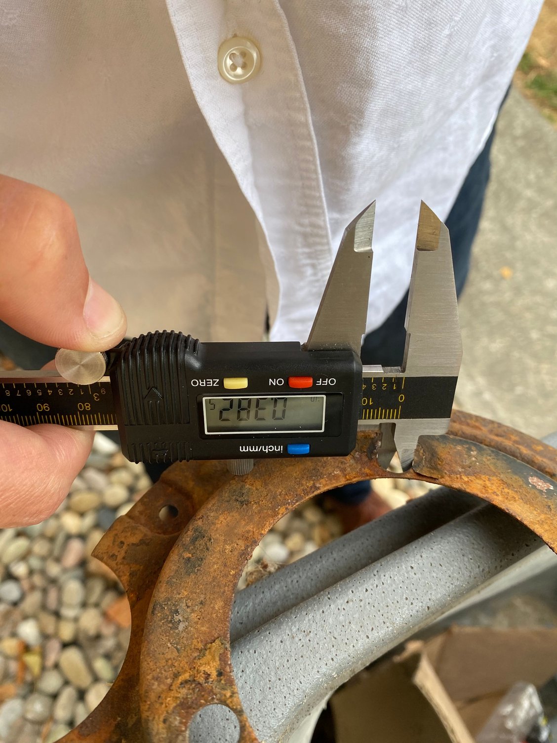

Some dimensions taken from a similar dimensioned but different year spare motor that I picked up just in case below:
