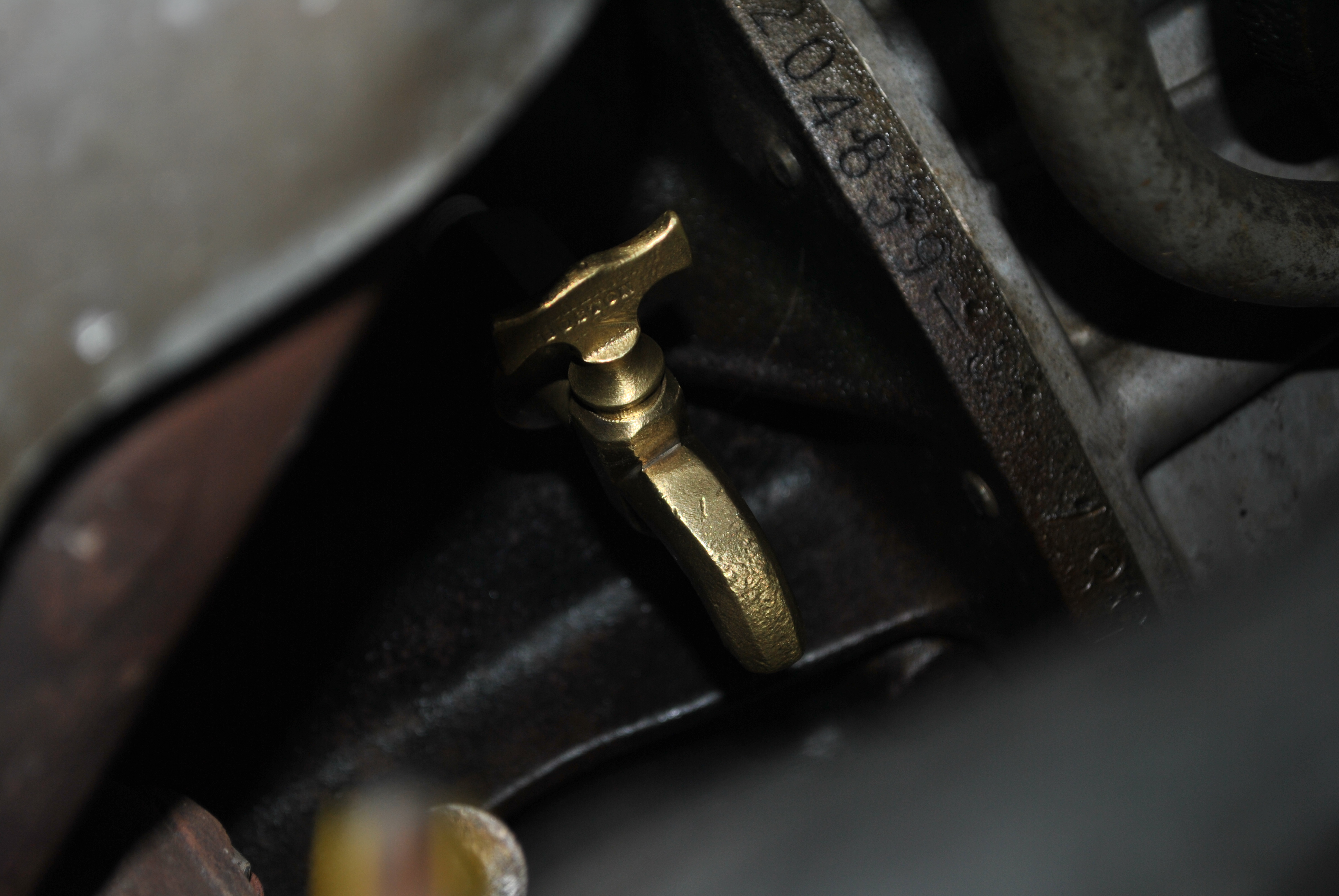

I like the little faucet to drain the coolant from the block.
I thought I was the only one.
Attachment 212159Attachment 212160
my '65 S type has two, one at the block like yours, and one at the radiator drain. My '84 XJ-6 has a 19mm bolt instead, so my heart is broken.
