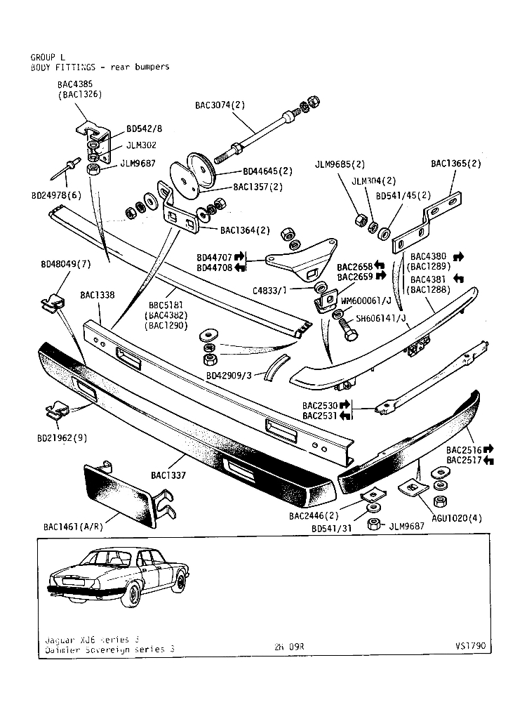

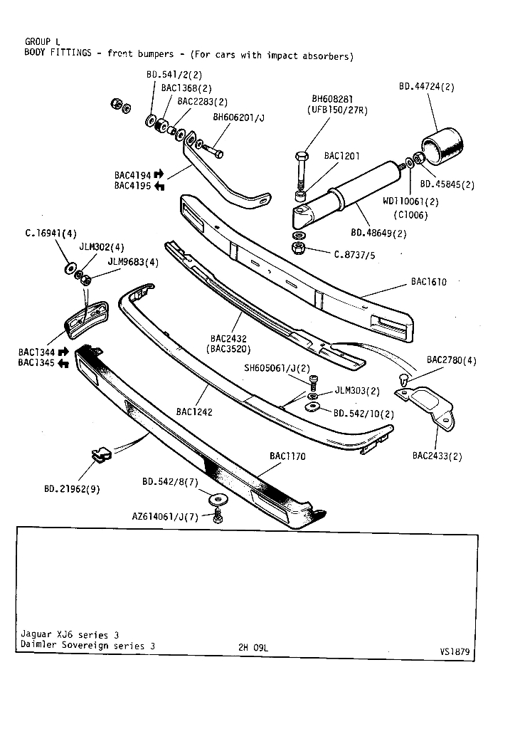

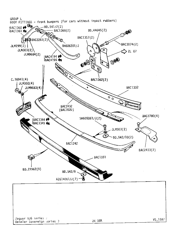

I’ve found a few threads regarding cutting/modifying existing USA spec bumpers to replicate the slim Euro look for our cars however, has anyone swapped actual Euro bumper parts onto their car?
I’m wanting to convert my USA bumpers to Euro spec by using Euro parts. Does anyone know what parts and part numbers I would need for this?

Here are some pics that might help
As you can see some of the parts are the same.
I don't recall, offhand, anyone doing an actual full conversion. It might be difficult and expensive sourcing and shipping the parts.

Doug! You are the man. I was reading one of your threads from way back about this. I’m going to search the internet and see if I can source any of the parts.
Looks like Euro’s don’t use bumper shock absorbers?
