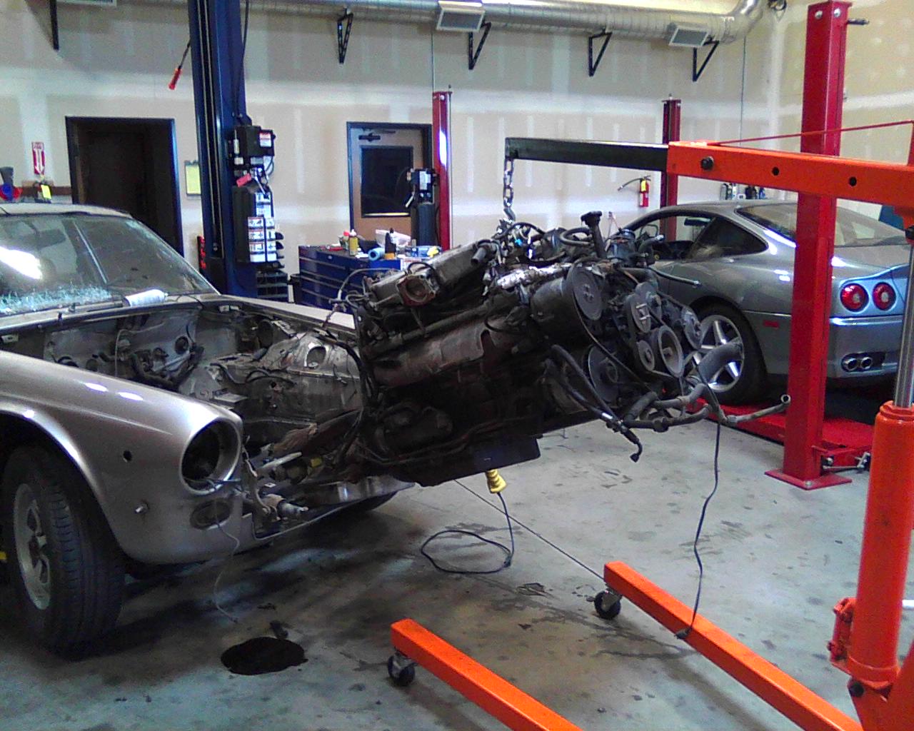

Thought I'd start a thread outlining my Jag project: taking a standard issue Series III XJ6 and swapping in a V12.
In the pics below you see the $1500 white 1985 XJ6 recipient car. Nice car, not perfect but better-than-typical cosmetics and interior, new headliner, working climate control, and a few other good features. I did discover a couple small rust problems so I shipped it of to the body shop to have those fixed.
Meanwhile.....
The other pic is the V12 engine a 400 trans coming out of the 1988 VDP donor car....which has already been stripped of all V12-related necessities plus anything usable and/or worthwhile...including some "VDP" style trim bits such as door panels, reading lamps, and such. The car came with a full set of refinished wood, including the VDP type dashboard. The motor runs just as sweet as can be but the body is rusted beyond any practical repair. The owner gave the car to me rather than send it to the scrapyard.
This a tight budget project. My goal is to have a great driving Series III V12 with a few upgrades for $8000 or less, all in. Anything that truly needs repair, replacement, or refurbishment will get it. Anything that doesn't, won't....with just a couple exceptions for things that are labor intensive once the car has been fully reassembled. The starter, for example.
DD
Attached Thumbnails Ser III XJ6 to V12 project-150430_0001.jpg   Ser III XJ6 to V12 project-1985-xj6.jpg

The engine bay and the V12 engine itself will be fully prepped and detailed---that's half the fun !
All wiring and vacuum systems will be repaired/refurbished/replaced as needed, yes, along with fuel hoses.
Old 4.2 Jag engine is sufficiently worn out that I'll scrap it. I'll save externals for resale.
I have a great local starter and alternator rebuilder. He gets all my business. Much better than off-the-shelf rebuilds from the parts stores these days.
DD

The only suspension difference is the front springs and the anti-roll bar.
I will buy new front springs because the ones on the donor car are rusty enough for me to feel a bit uncomfortable using them.
I have salvaged the larger "V12" front anti-roll bar.
Brakes are the same and rear suspension is the same....although I am adding a rear anti-roll bar from an XJS.
DD

Thanks for asking---I've been meaning to post an update.
Progressing slowly but surely. Work and home projects have slowed me a bit.
Within the next week or two I hope to have the car at the shop to remove the existing powertrain. Space is limited so, after that, it'll return home where I'll work on detailing the engine bay, install the V12 wiring harness, and a slew of other smaller tasks. The it'll go back to the shop for installation of the V12 engine and drivetrain, 3.31 differential, etc.
The V12 engine has been cleaned, new cam cover gaskets, starter and alternator rebuilt, throttle bushings installed, and so forth. The radiator has been treated to a professional boil-out and cleaning. I had the injectors professionally cleaned as well. The fuel rail is assembled with new hoses and he supply and return hoses have been redone as well.
As for the car itself I've been picking away at small projects: repairing the cowbells, new fuel hoses in the trunk, installing 7" headlights, repair door locks...things like that. The XJS lattice wheels have been stripped and repainted and new tires installed. Refinished interior wood is ready to install. Hopefully I'll have time to re-dye the leather in the next few days. Then the seats will be seat aside as installing the V12 wiring means pulling up the carpets. For fun I installed chrome speaker rings.
The nooks and crannies of my house are filled with parts that have been cleaned/repaired/repainted/reconditioned as needed. Once the engine is in place it should be fairly quick and easy to reassemble the bit and have it running.
A hundred-and-one small tasks. I just keep plugging away and checking them off the list
DD
