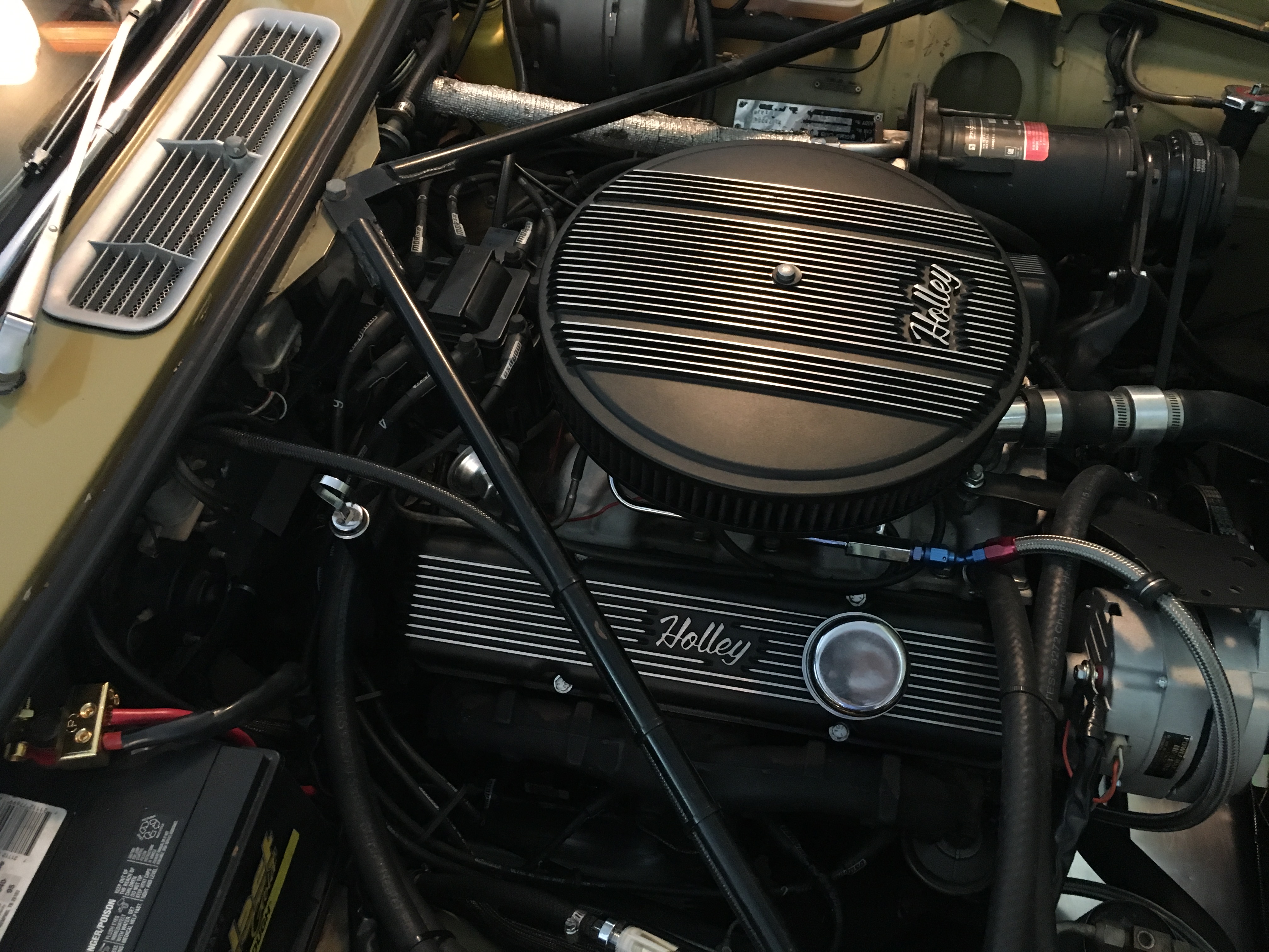

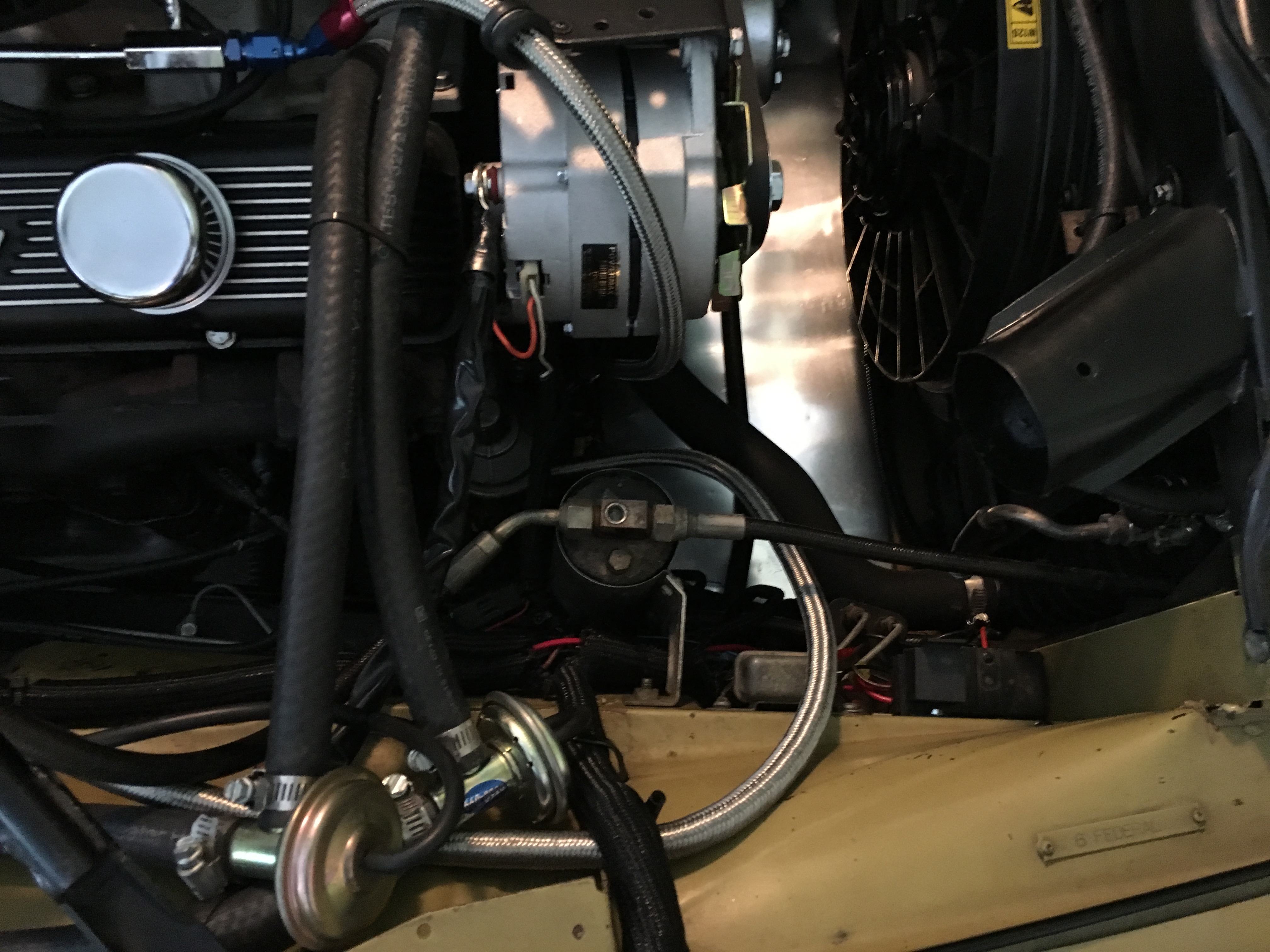

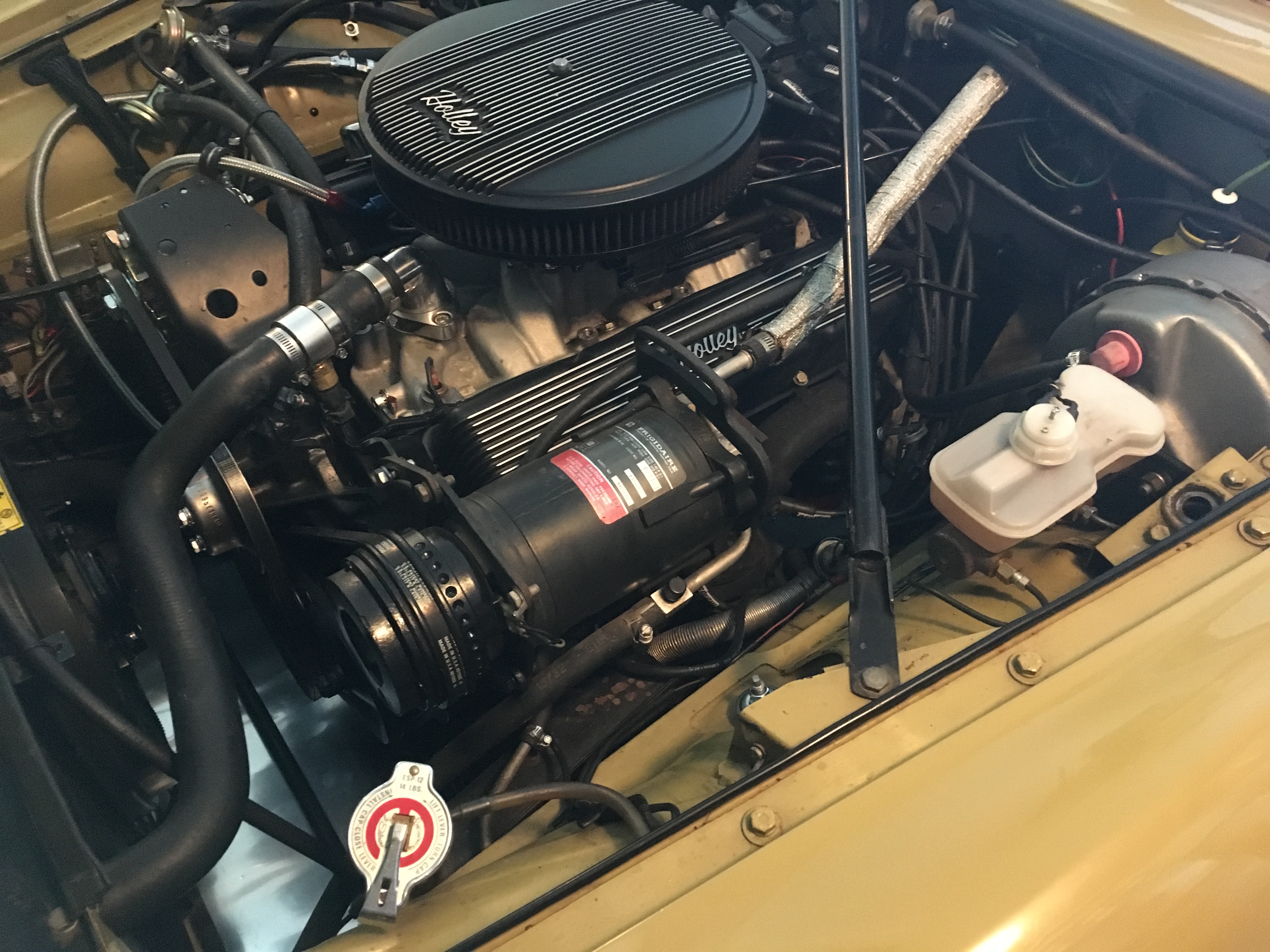

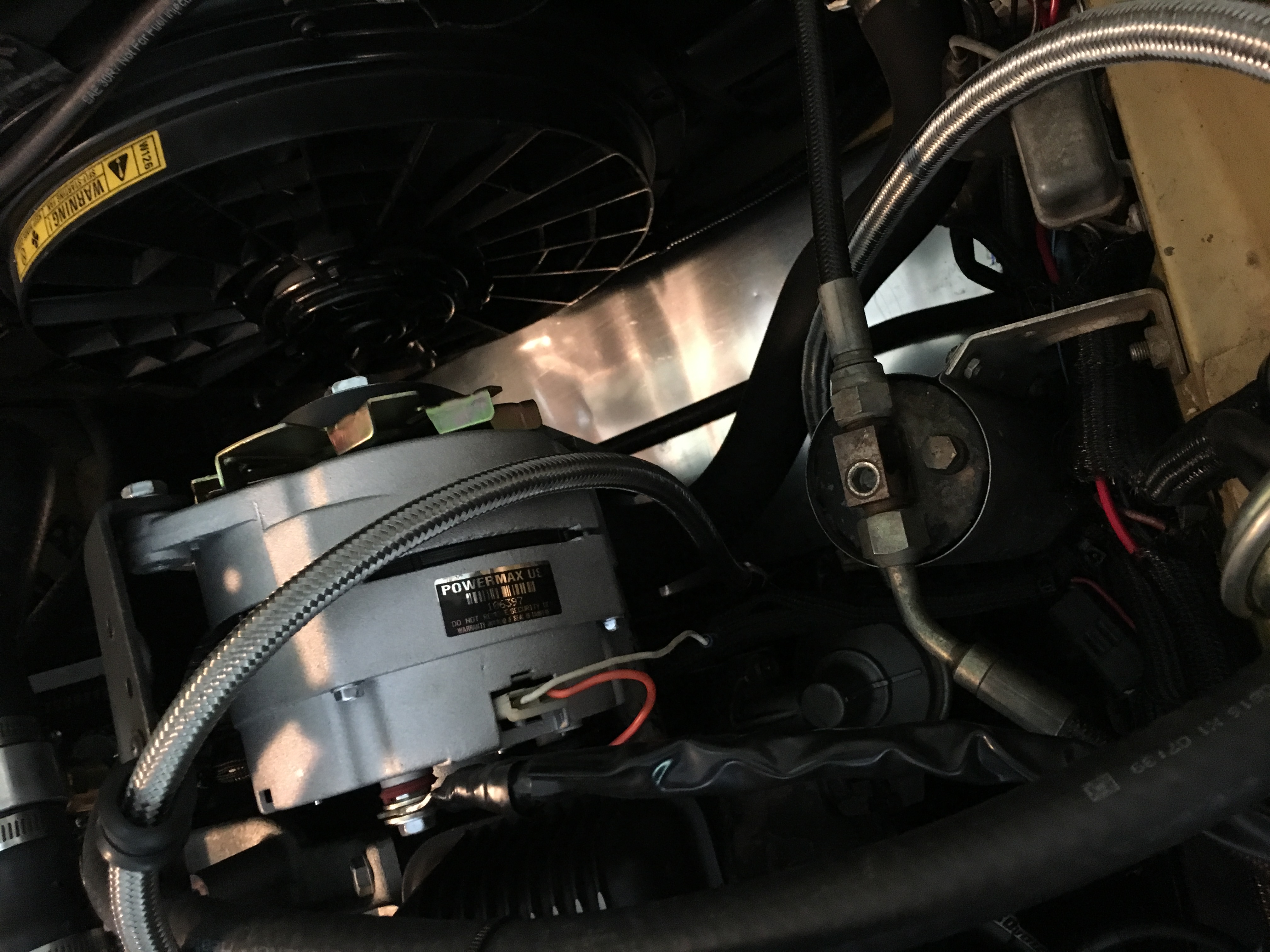

Key to good AC performance is replacing the condenser with as large a one you can fit of modern cross flow design. Make sure the hoses are correct for R134 (the best stuff to use for easy of availability and understanding) and the expansion valve is working and correct for R134 fluid (stock ones need to be adjusted with the screw to allow the correct amount). I have a Trinary switch mounted that turns on the dual Ford fans when the AC is used, plus a trans cooler. The front of the radiator is sealed up to force the incoming air through the condenser and radiator with AC foam.
Fans can be replaced with GM fans for more air flow (that makes it feel cooler) and the extra air flow from the new center vent(s) will help in the comfort. The dual vents get their air from the bottom of the evaporator for one vent and the other from one the rear tubes that go through the center console to the rear passengers.
I use a Sanden compressor and have all the mods that Robert mentions above and more... get 39-40F air temps in the side vents and cooler temps in the two center vents. Part numbers and photos are available...
