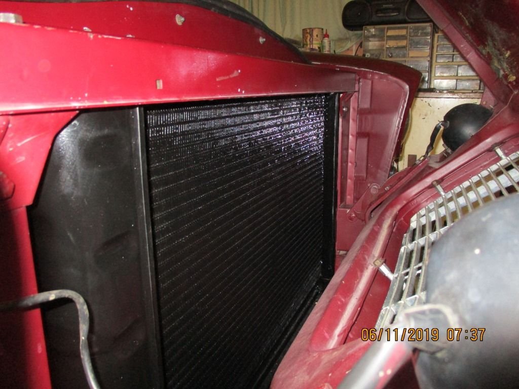

Latest work has been to replace the 47 year old radiator that was starting to weep at the seams. The inspector had noticed it when I presented the car for its on road, saying it would let me down on a hot day. $750 later I have a triple row 108 tube radiator with twice the cooling of the original 58 tube.
Fitting the fan was a pain - very hard to get to the 4 screws securing the coupling to the water pump pulley.
Of course now this is fixed another problem has arisen. The drain plug in the bottom cross tube/transmission cooler is leaking. And it is not just a matter of some sealant. The brazing has cracked around the thread housing. So off this comes next.

I spent $750 recoring my radiator 12 months ago and went from 3 rows to 4....great result.
Another problem arises, how normal.....good luck!
Woo woo ! Sounds....ahem....pretty cool
I was working on my car recently and it oddly dawned on me, since owning so many old Jags, how adept I've become at balancing a nut on my fingertip so as to get it started on a bolt or stud that can be seen or be felt....but never both at once
Life with old cars, eh?
Eventually, though, the new-problem-cropping-up syndrome becomes a less and less frequent occurrence.

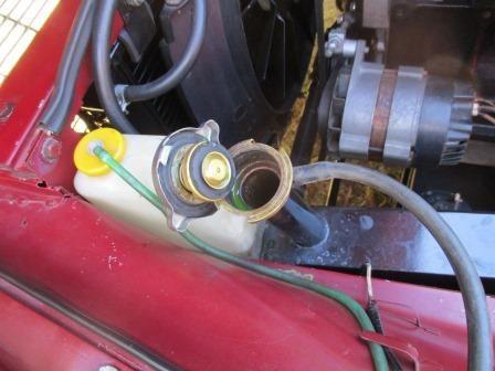

Took the car down to the "Terribly British Day" in Queenbeyan, the down to Cooma over the weekend. Total round trip was 362 miles. Car was running great with no problems - until I stopped for a quick break and a nature call. On return checked under the car and coolant flowing everywhere. I thought this cannot be happening, having renewed almost every component of the cooling system. A quick check revealed that the coolant was coming out of the expansion tank cap! Not the overflow hose, but the cap. I had bought a replacement stainless tank as the original had a rusted out bottom. It did not come with a cap, so I had put my original cap on it. Seems that the cap does not reach fully into the neck, so not compressing the pressure spring properly. Additionally I had probably overfilled the system. No further problems, but I have repaired the original tank and may fit that.
After showing the car at the "British Day" (see regional thread), I drove out of the grounds and immediately detected something wrong - the car would not shift properly, in fact it was ranging between 2nd and top gear quickly and erratically - would only hold top once up above 60mph. As I drove along - thinking the worst (new transmission?) I realised it must be either the vacuum control or the kick- down switch. Stopped the car and examined underneath, the vacuum connection looked OK. Disconnected the kick-down switch and drove on. Smooth shifting and no ranging. I have never heard of this happening to any other XJ before, but can see how the switch making and breaking could lead to this condition.
The good news was that for the 362 miles I averaged 24.5mpg, (proper gallons for our American friends). And I was not hanging about, cruising at 70 mph with a few bursts up to 85mph on some of the hills so as to give the engine a bit of work to do.
