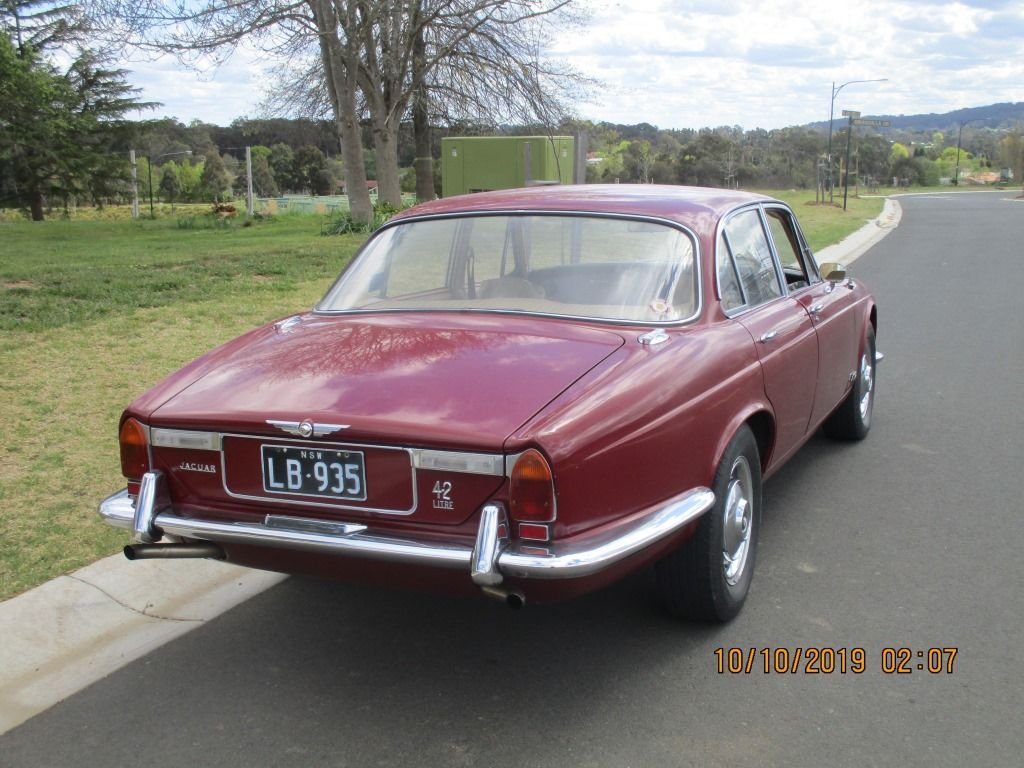

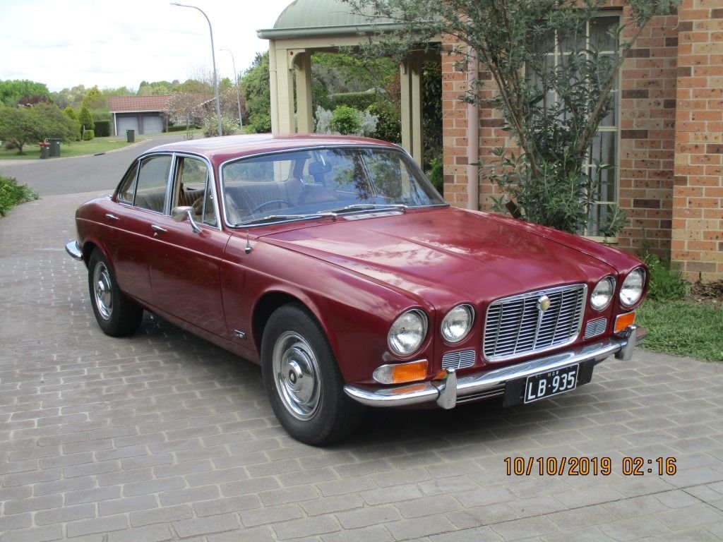

On the road at last! Car was inspected for registration yesterday and the inspector was most complimentary remarking that it drives beautifully.
Looking back I started this in December 2016 - about the time I joined this forum. The car has been off road for over 18 years and while in storage suffered a bit with rats eating wiring under the bonnet, brakes seizing up, rubbers disintegrating etc, etc.
The car has been thoroughly overhauled mechanically - this car is not a paint job as can be seen from the photos. Paint is the last thing I will do.
Many thanks to all on this forum who have helped solve various problems along the way thereby encouraging me to finish it.

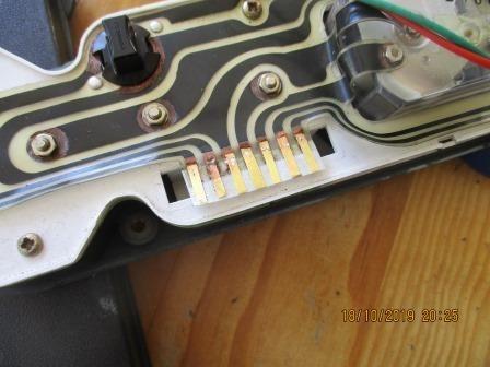

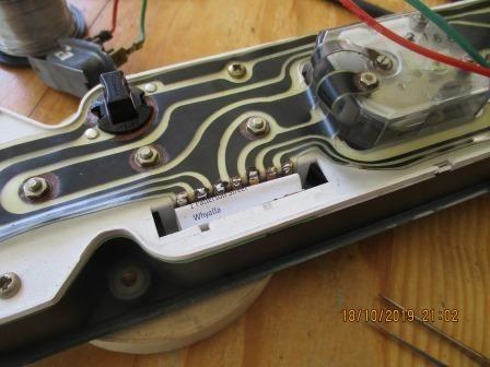

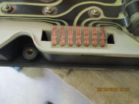

In getting this car on the road, one of my aims is to get everything on the car working as it should. I have had the car 36 years and in all that time the Kienzle clock has never worked.Before the car was laid up for 18 years the battery indicator (it is not an ammeter) also gave up.So I decided to investigate.In doing so, I pulled the 7 pin plug that connects to the primitive printed circuit board that the Series 1 has behind the instrument panel.Had a look, could not see anything obvious.Result on plugging back in that none of the gauges or the panel lights worked!
After much investigation, it was determined that the printed circuit connections to the 7 pins plug had all failed – if you look closely at the photo you can see cracks in the copper “fingers”. This can occur when the plug is pulled in and out a number of times.I strongly suspect that my 7 pin plug had been worked on prior to my ownership, perhaps to try to get the clock working.
With the connections being so damaged, I firstly tried to just solder them up. Big mistake – my soldering iron was too hot and made a mess of the whole affair.Second attempt was to cut thin brass shim into fingers using a finer soldering iron and solder them on.On checking continuity this failed when the tab was folded over.Final attempt was made with the circuit board tab folded into position, just enough solder to ensure a good connection.
Amazing that this approach worked. All my gauges are working now, including the clock!This clock is over 250 pounds to replace!I will say that this job has taken many days to get this result.

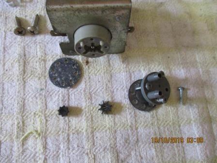

Finally, the windscreen washer. Thanks to Grant Francis from South Australia who had a repair kit for the Trico pump, my washer is now sending huge squirtsof water over the windscreen and onto the roof!I shall have to tweak the washer jets.
In the photo, you can see the difference between the old and new impellers.
