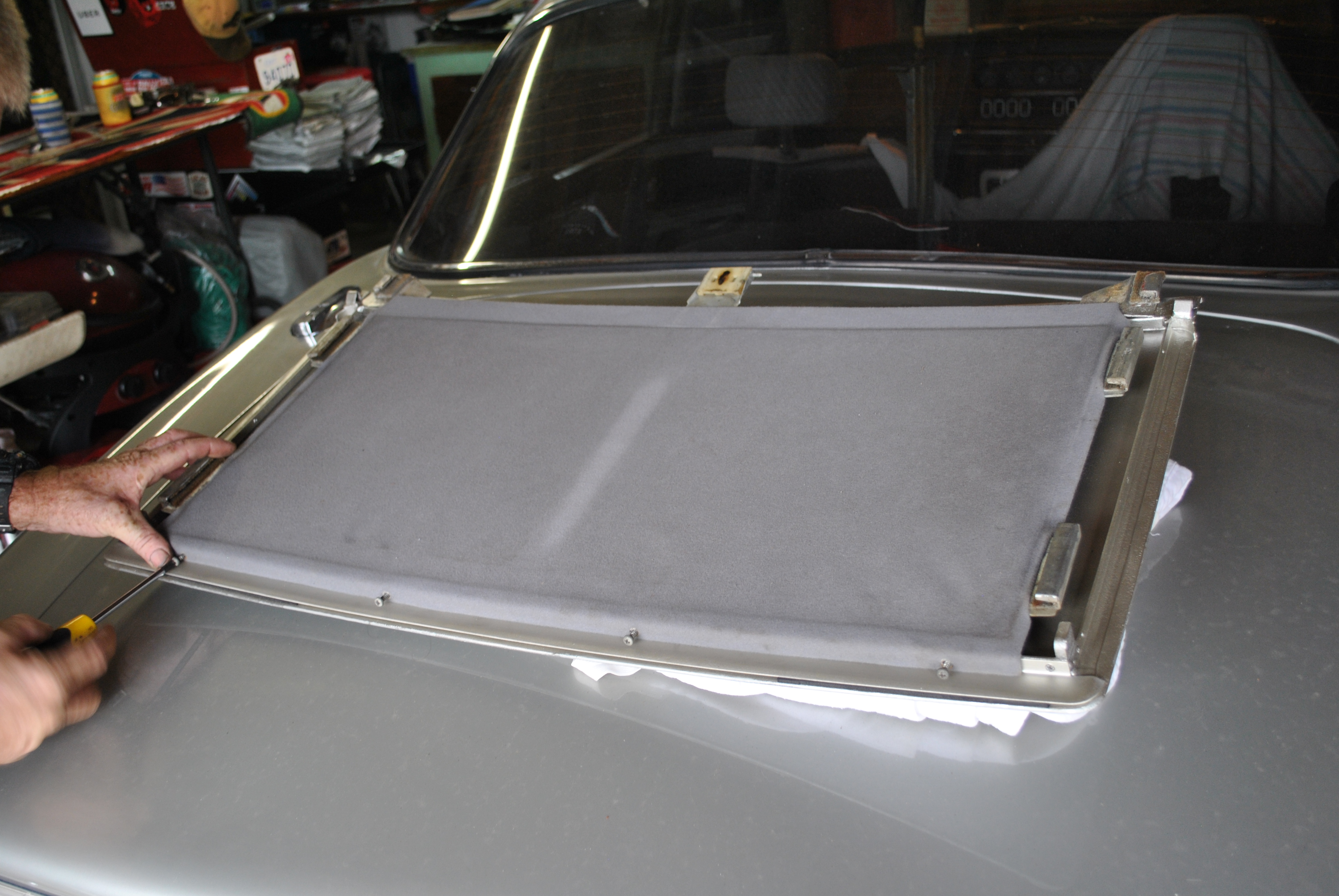

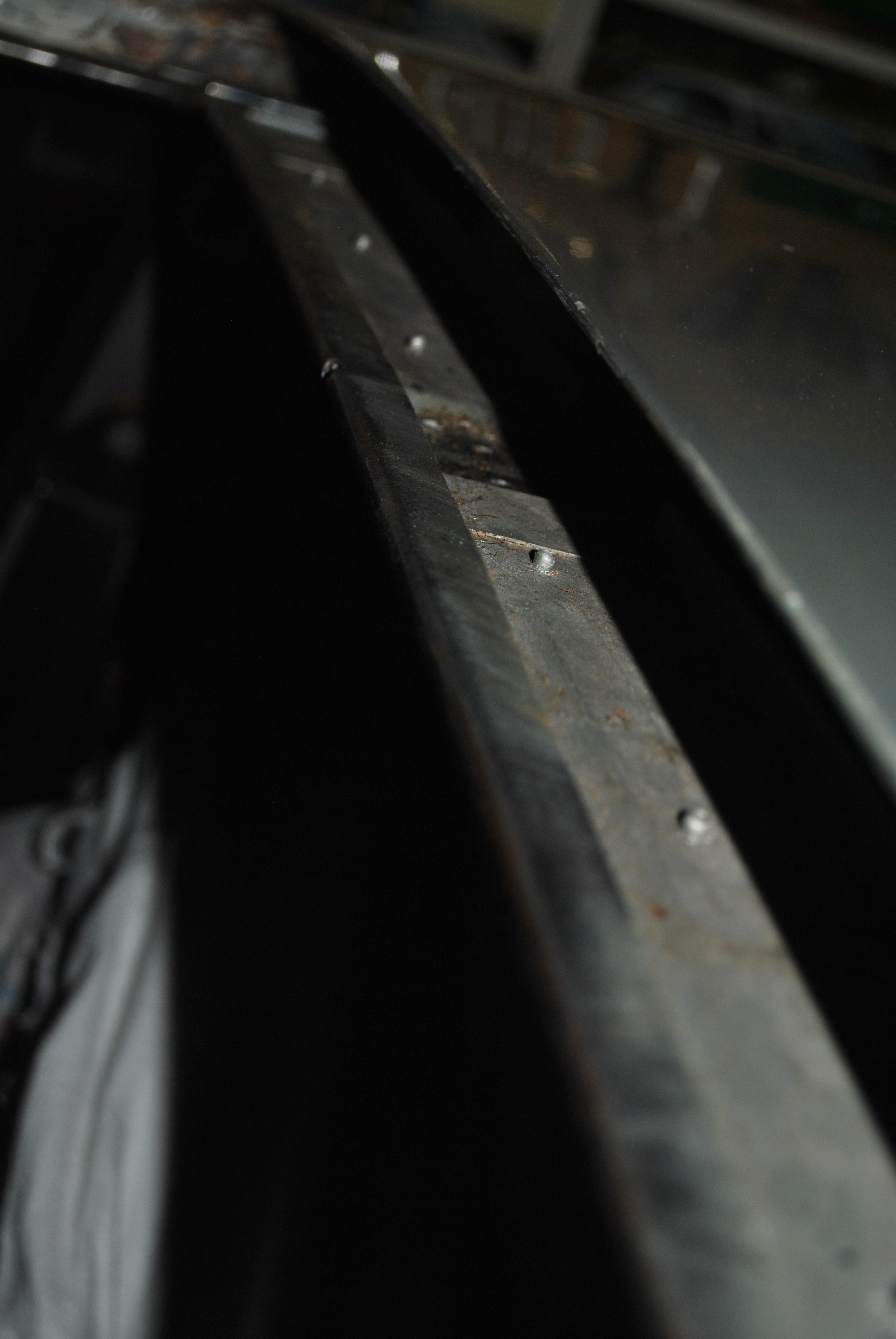

Old Feb 24, 2018 | 07:20 PM
  #45
o1xjr's Avatar
Posts: 28,386
Likes: 6,340

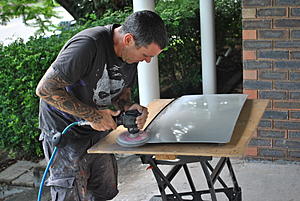

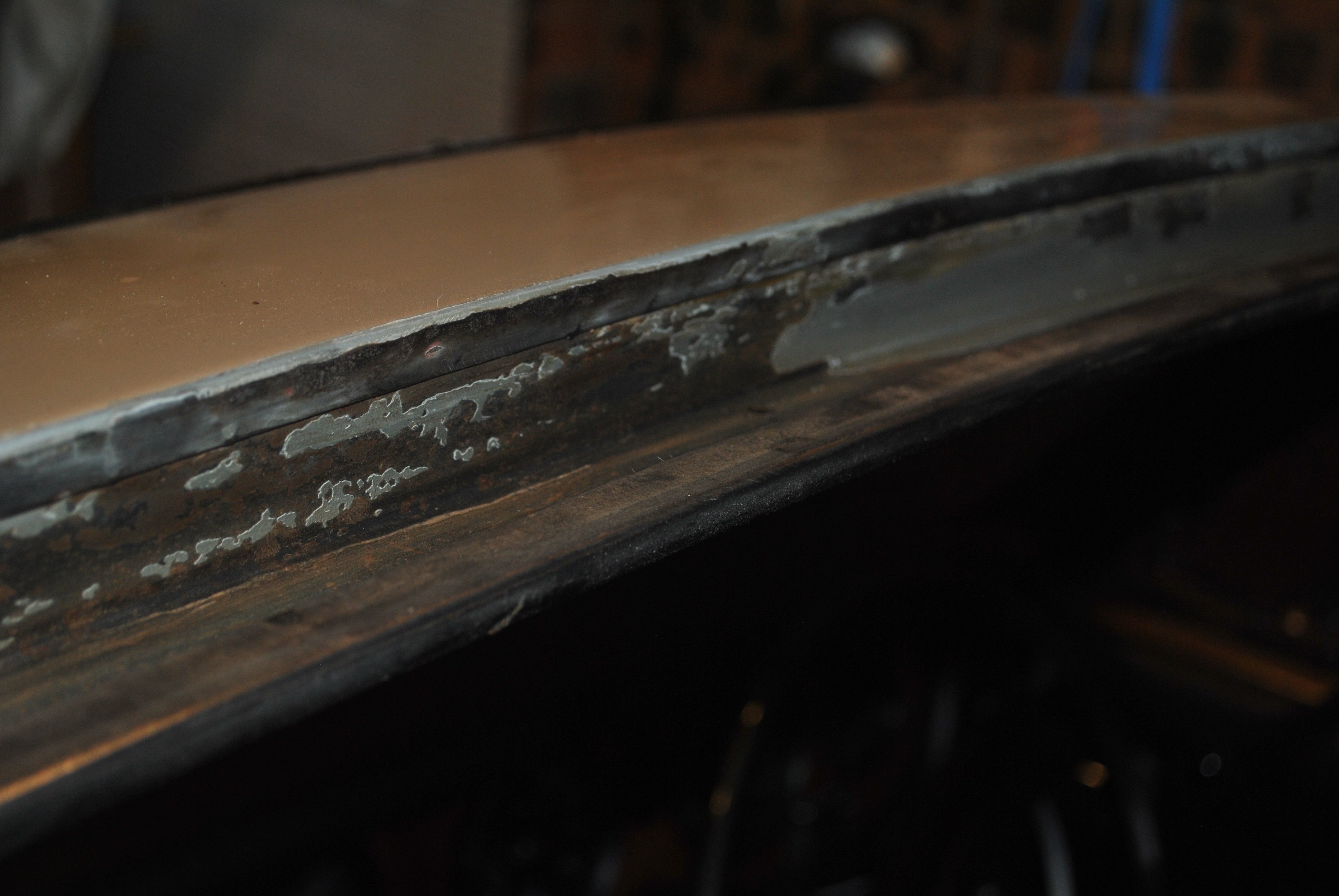

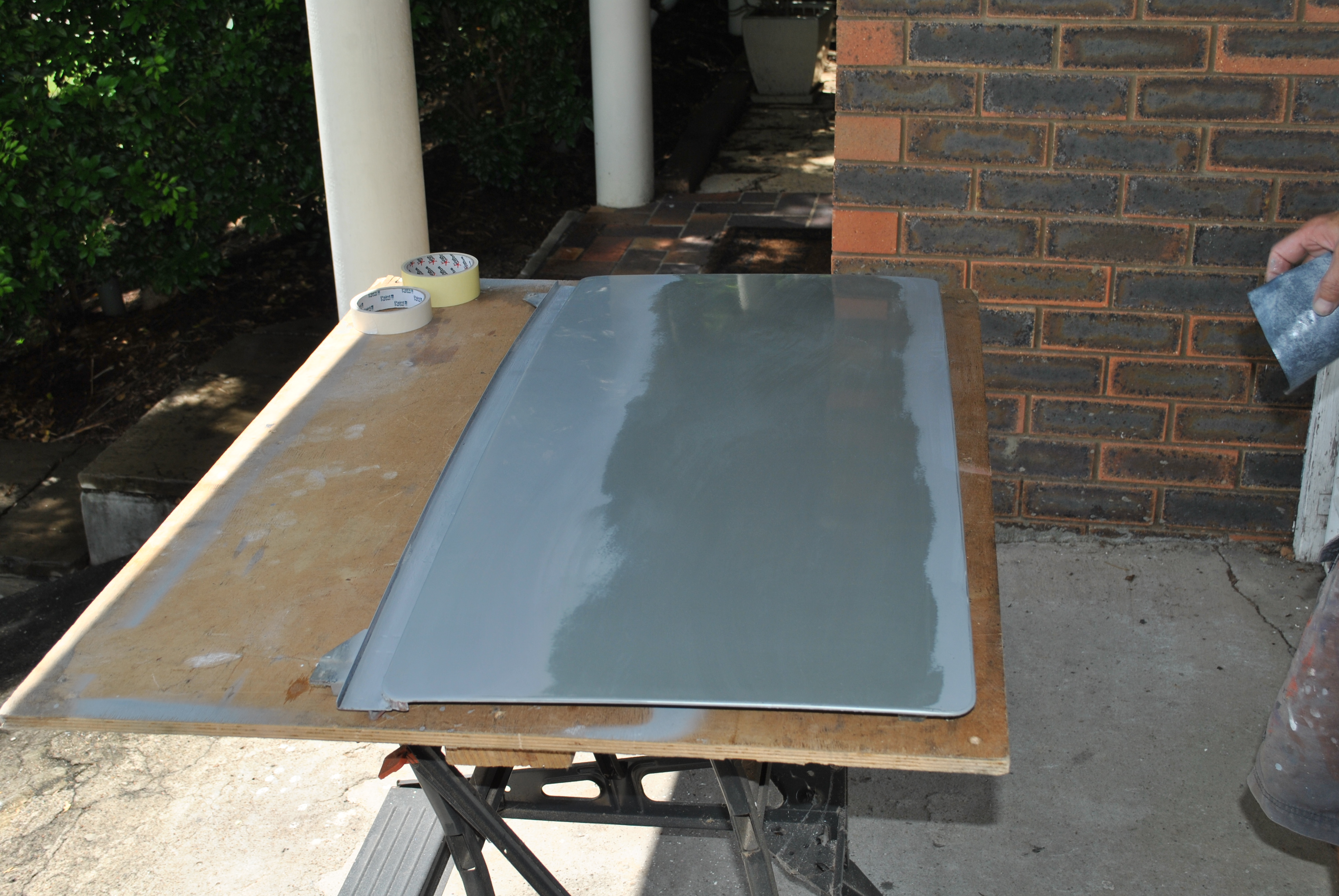

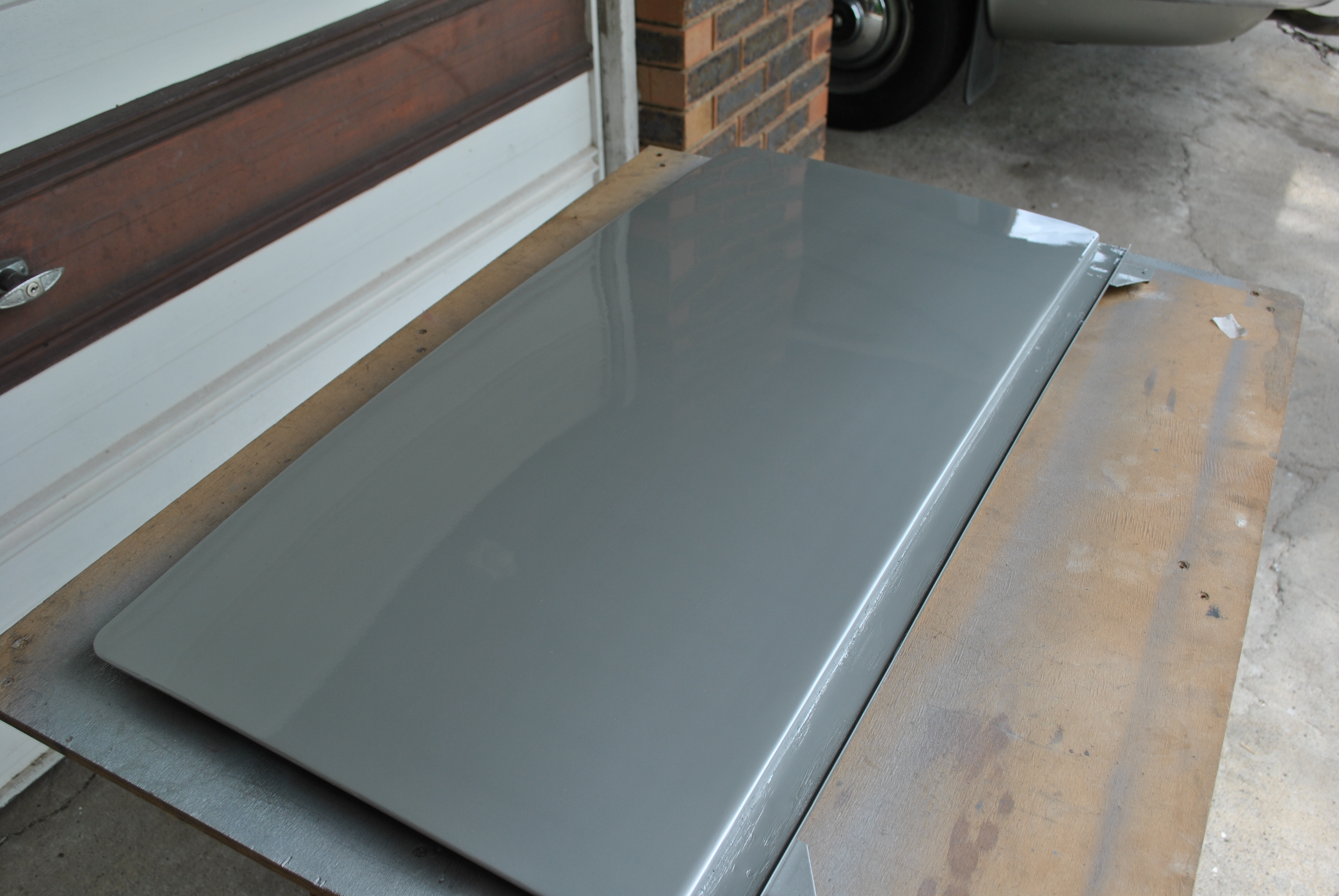

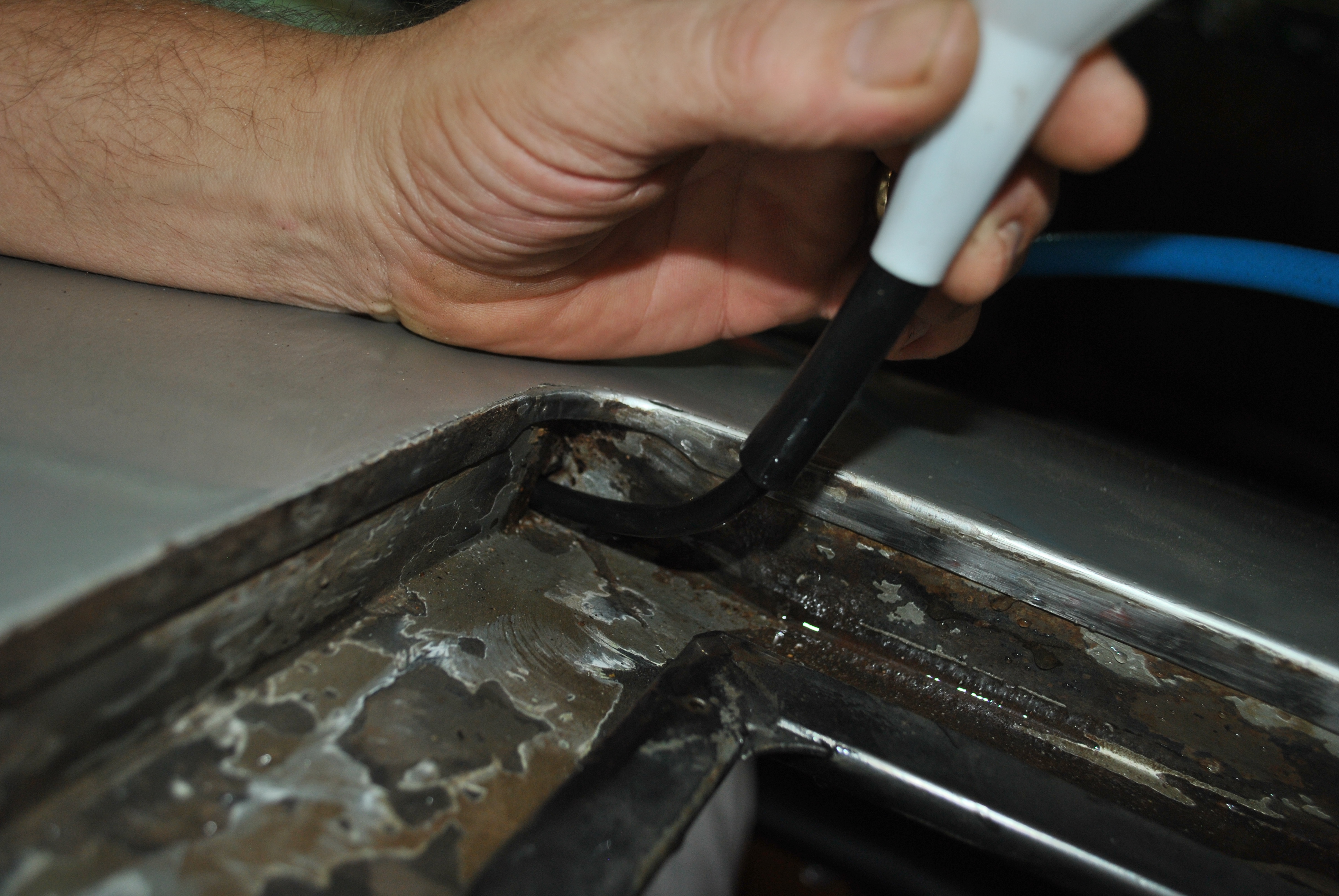

Work in progress.
Series 1 Sunroof repair-dsc_1473.jpgSeries 1 Sunroof repair-dsc_1469.jpgSeries 1 Sunroof repair-dsc_1471.jpgSeries 1 Sunroof repair-dsc_1472.jpgSeries 1 Sunroof repair-dsc_1474.jpgSeries 1 Sunroof repair-dsc_1475.jpgSeries 1 Sunroof repair-dsc_1476.jpgSeries 1 Sunroof repair-dsc_1477.jpgSeries 1 Sunroof repair-dsc_1478.jpg
Old Feb 24, 2018 | 09:12 PM
  #46
o1xjr's Avatar
Posts: 28,386
Likes: 6,340

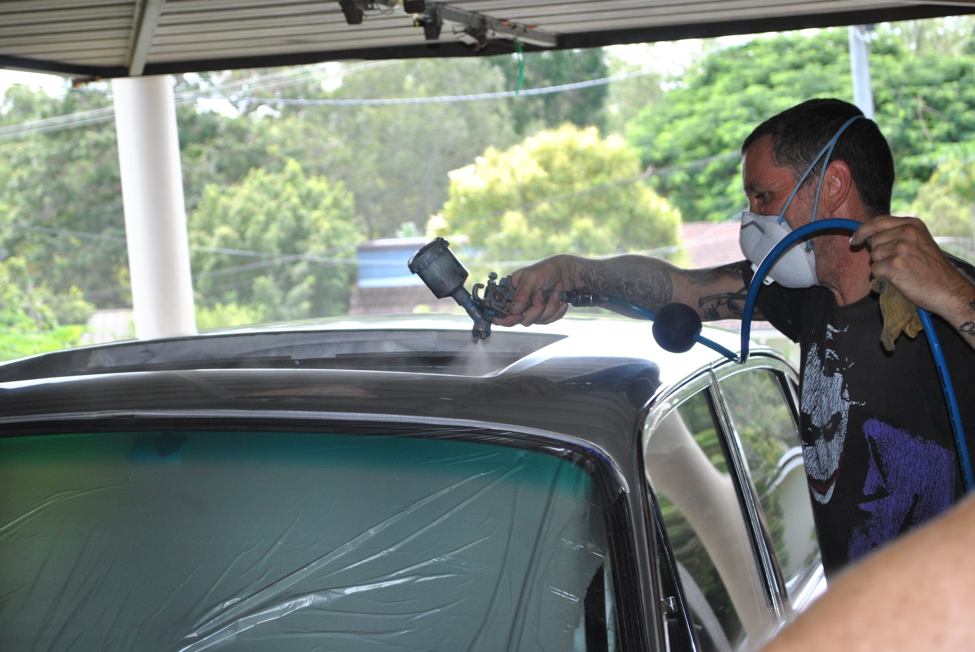

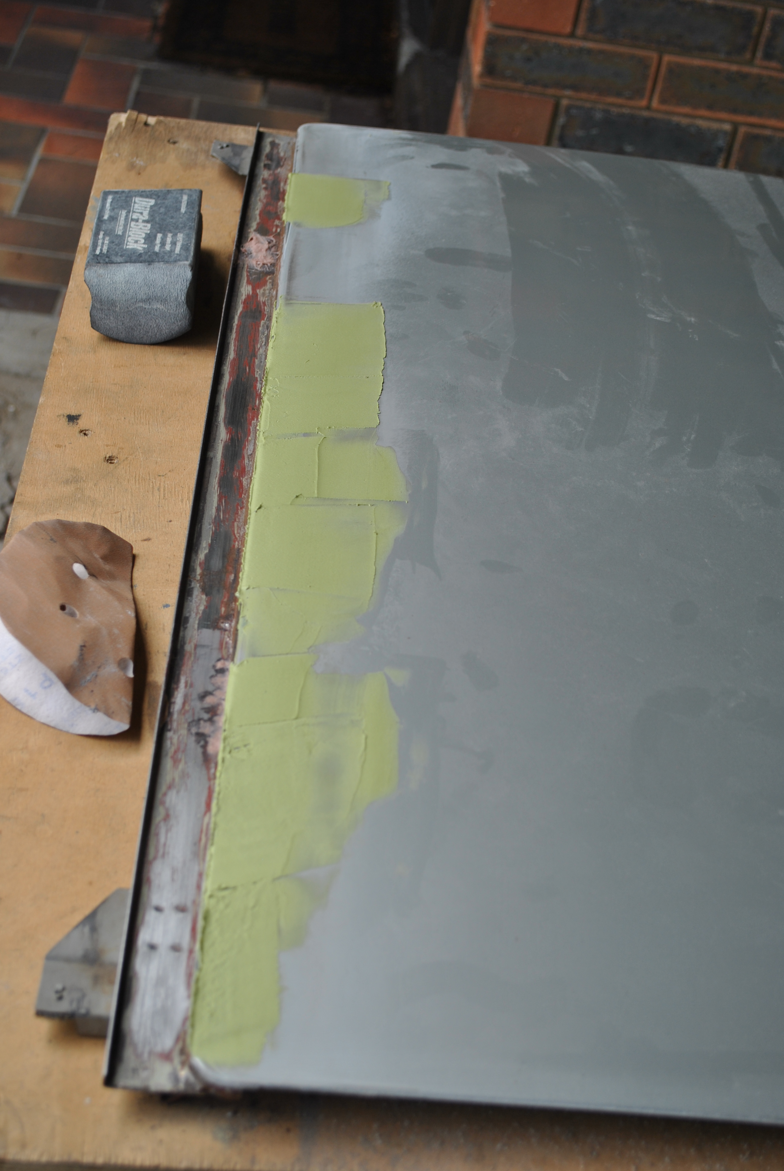

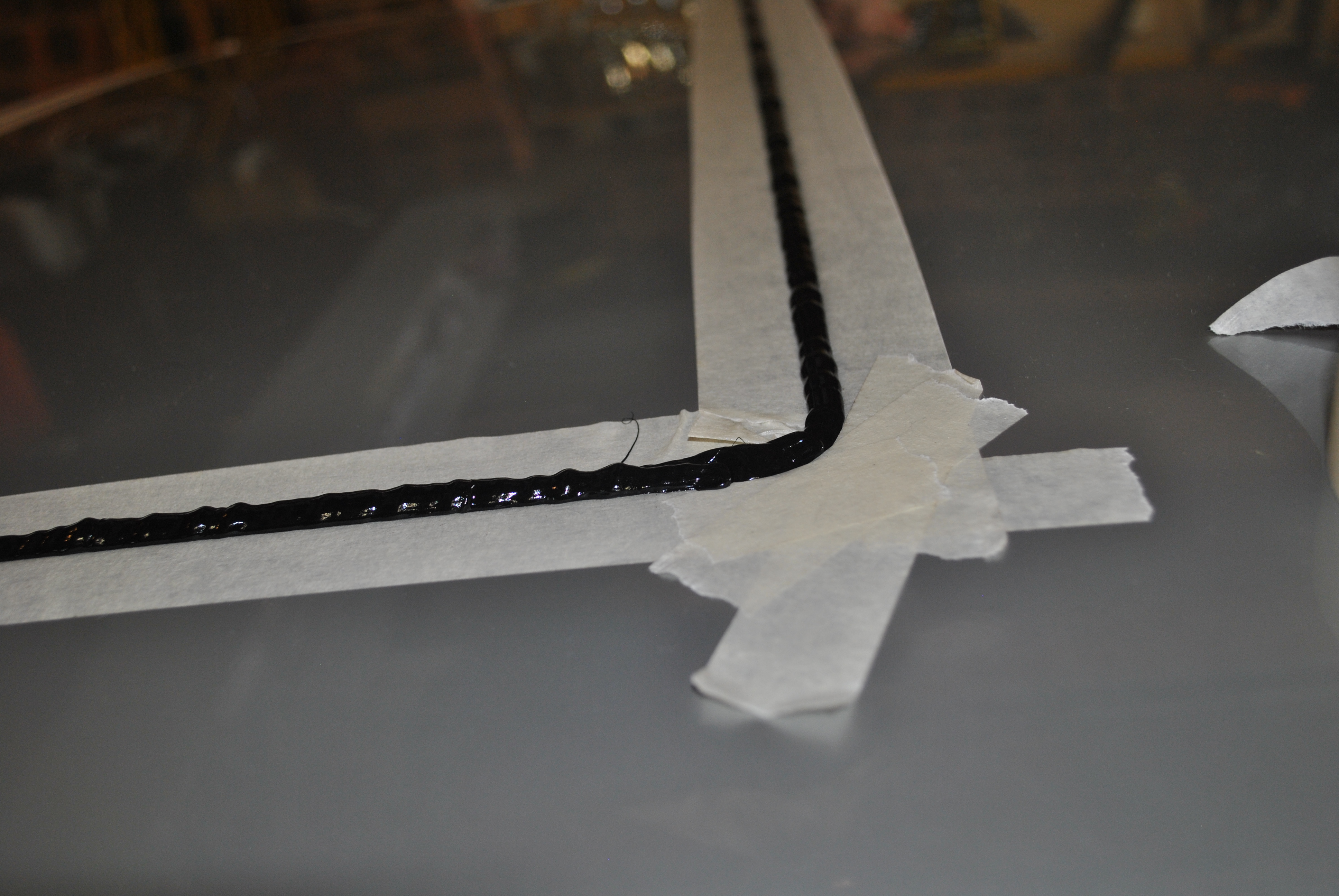

Five hours work for $200, can't beat that.
Series 1 Sunroof repair-dsc_1479.jpgSeries 1 Sunroof repair-dsc_1480.jpgSeries 1 Sunroof repair-dsc_1481.jpgSeries 1 Sunroof repair-dsc_1482.jpgSeries 1 Sunroof repair-dsc_1483.jpgSeries 1 Sunroof repair-dsc_1484.jpgSeries 1 Sunroof repair-dsc_1485.jpg
Old Mar 2, 2018 | 04:01 AM
  #47
o1xjr's Avatar
Posts: 28,386
Likes: 6,340

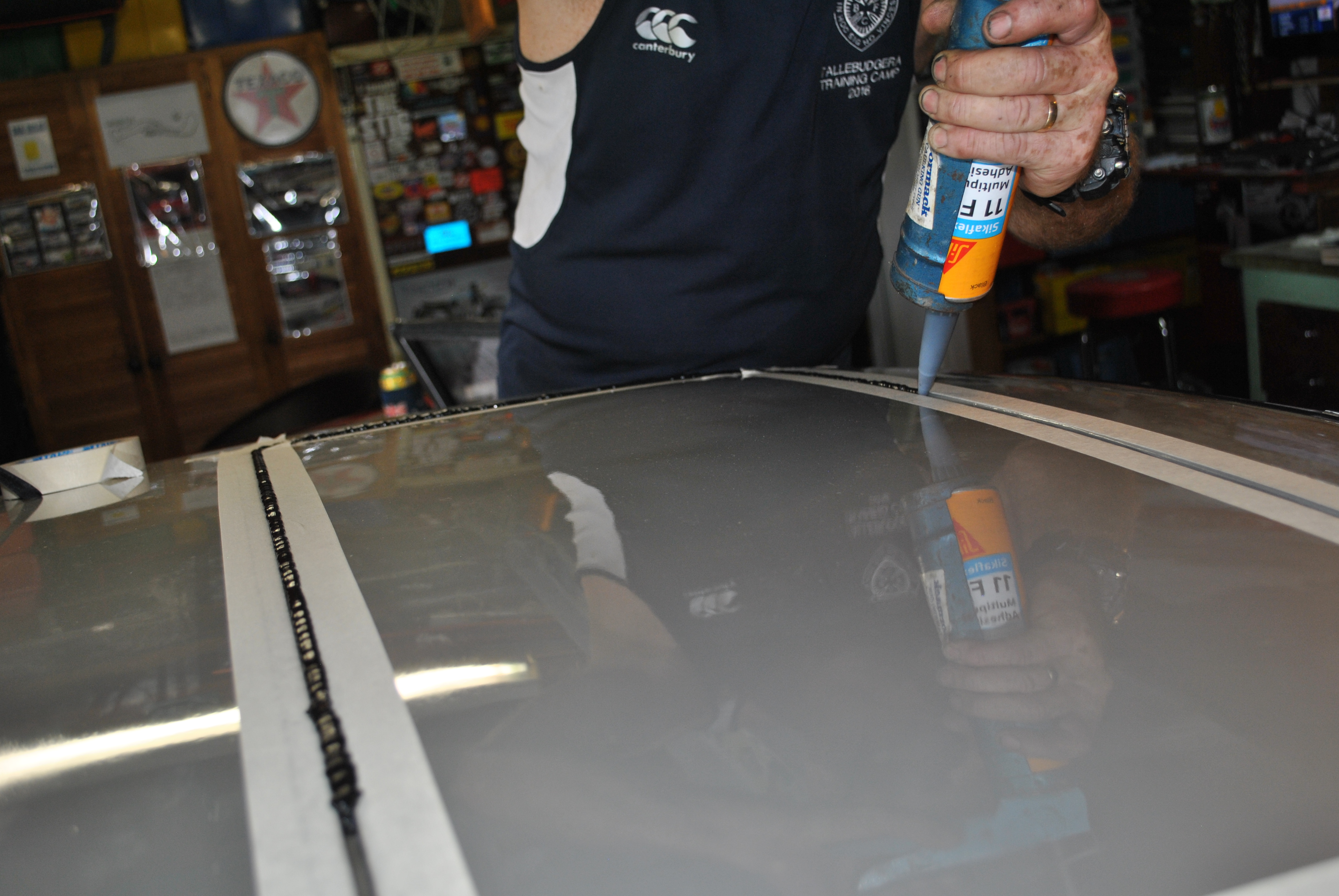

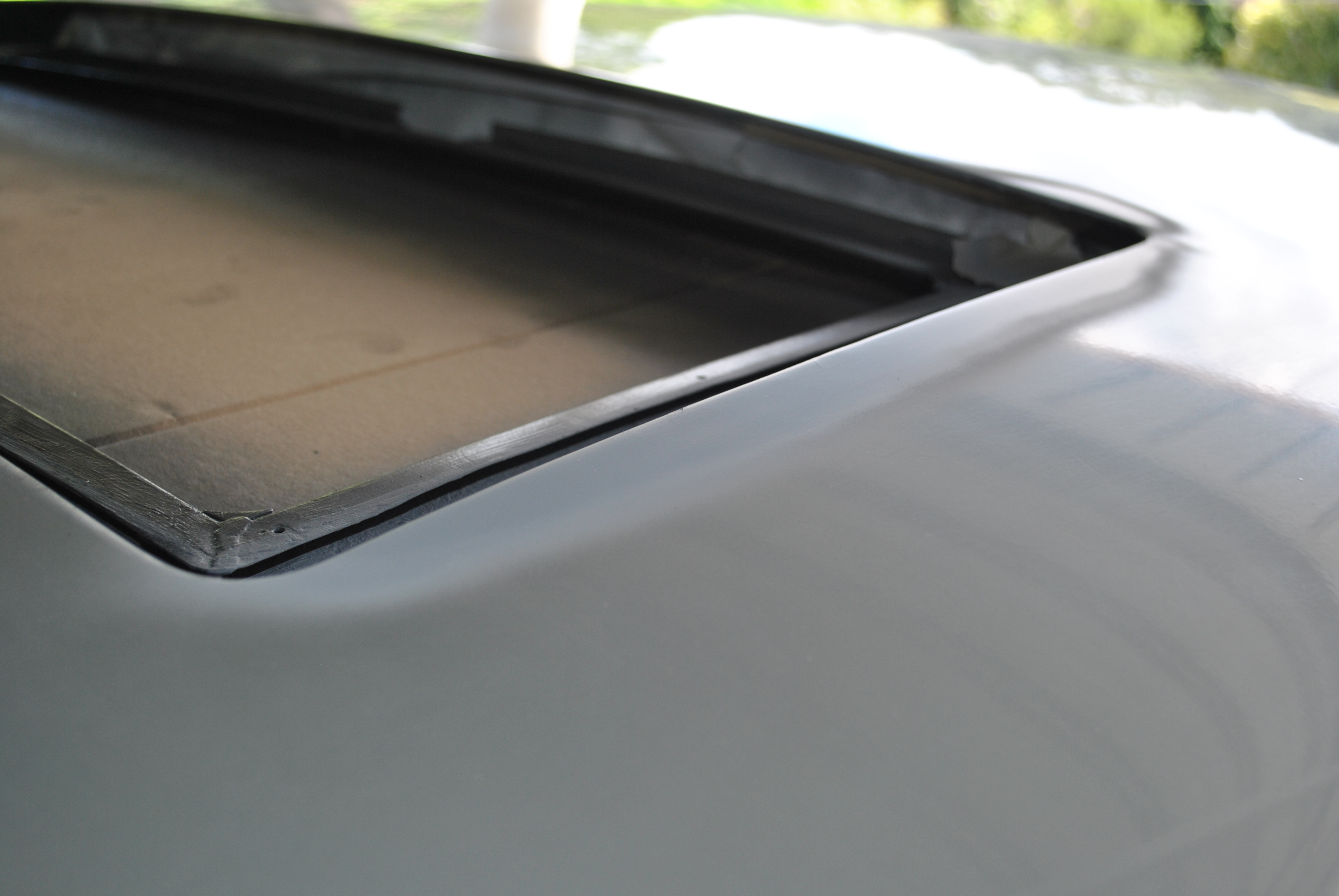

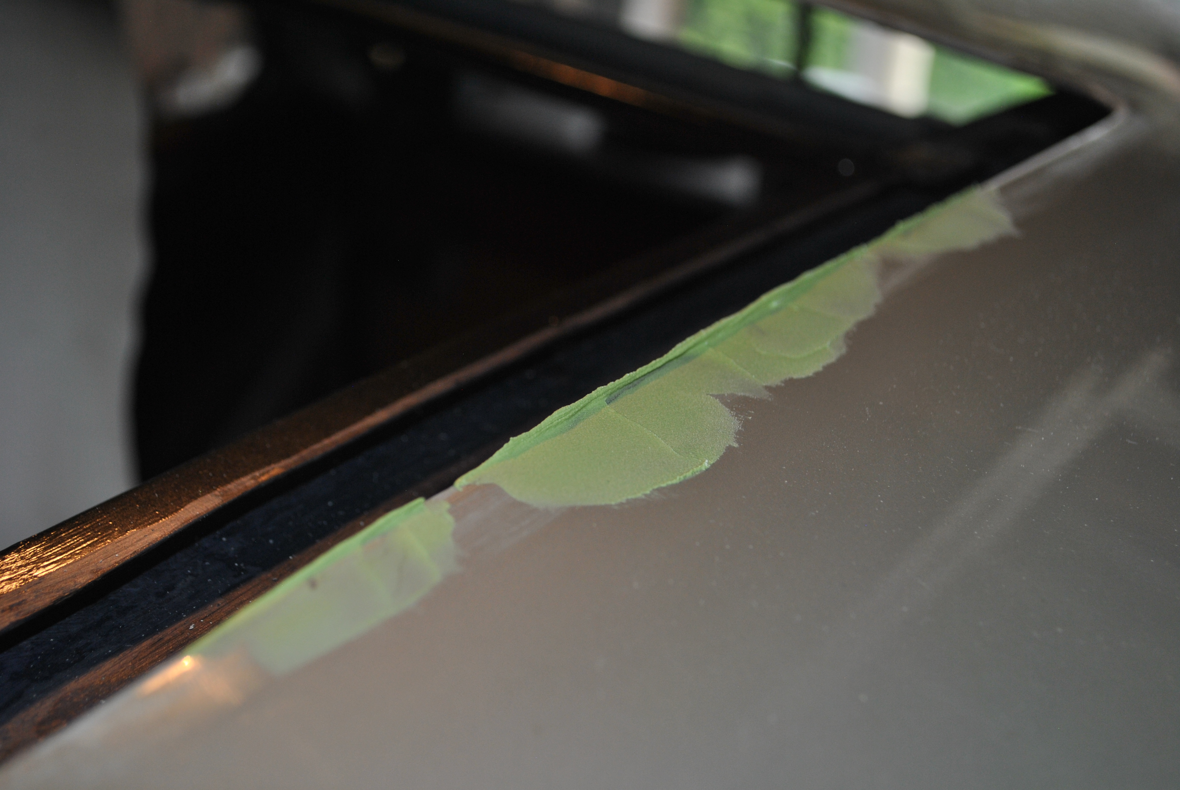

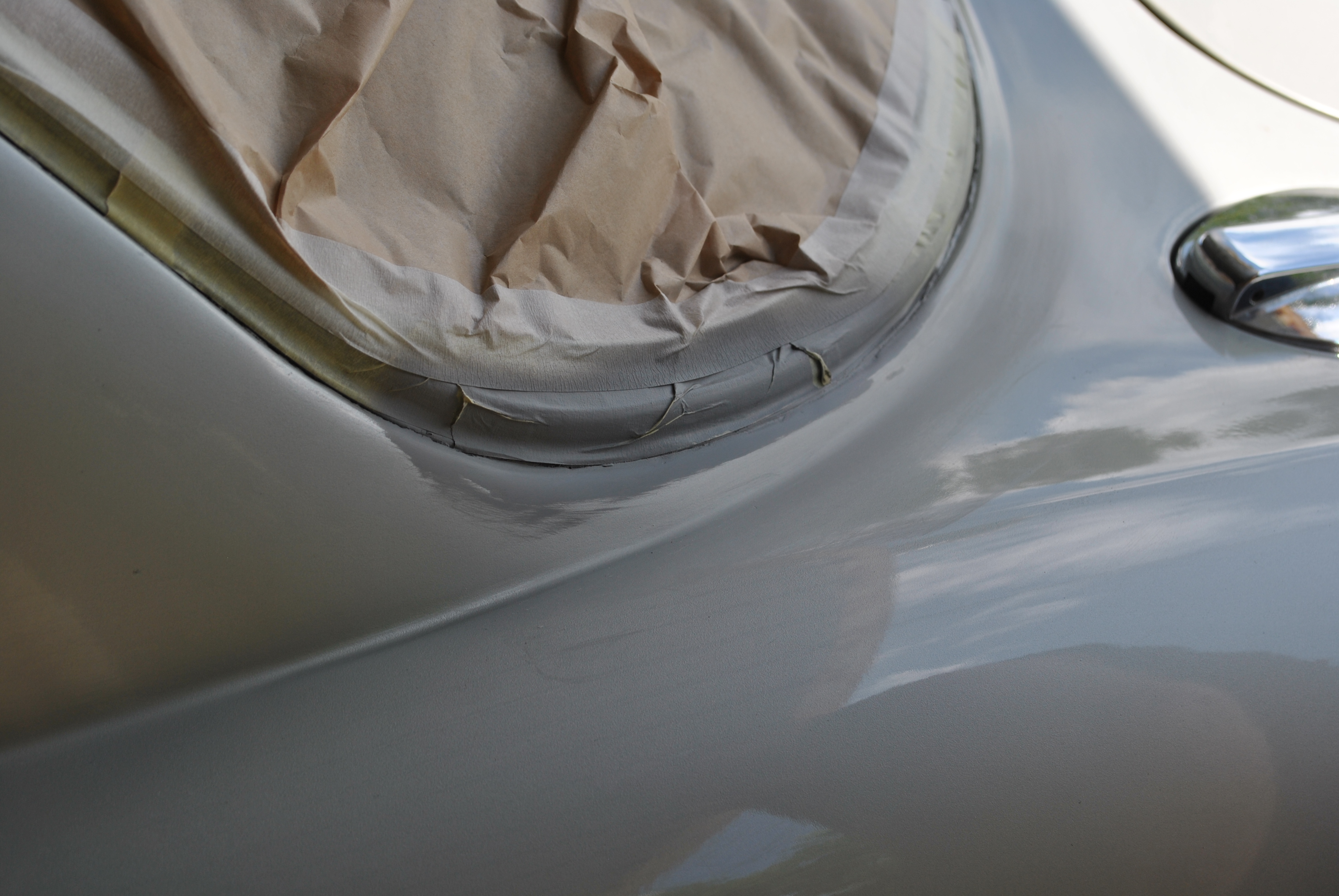

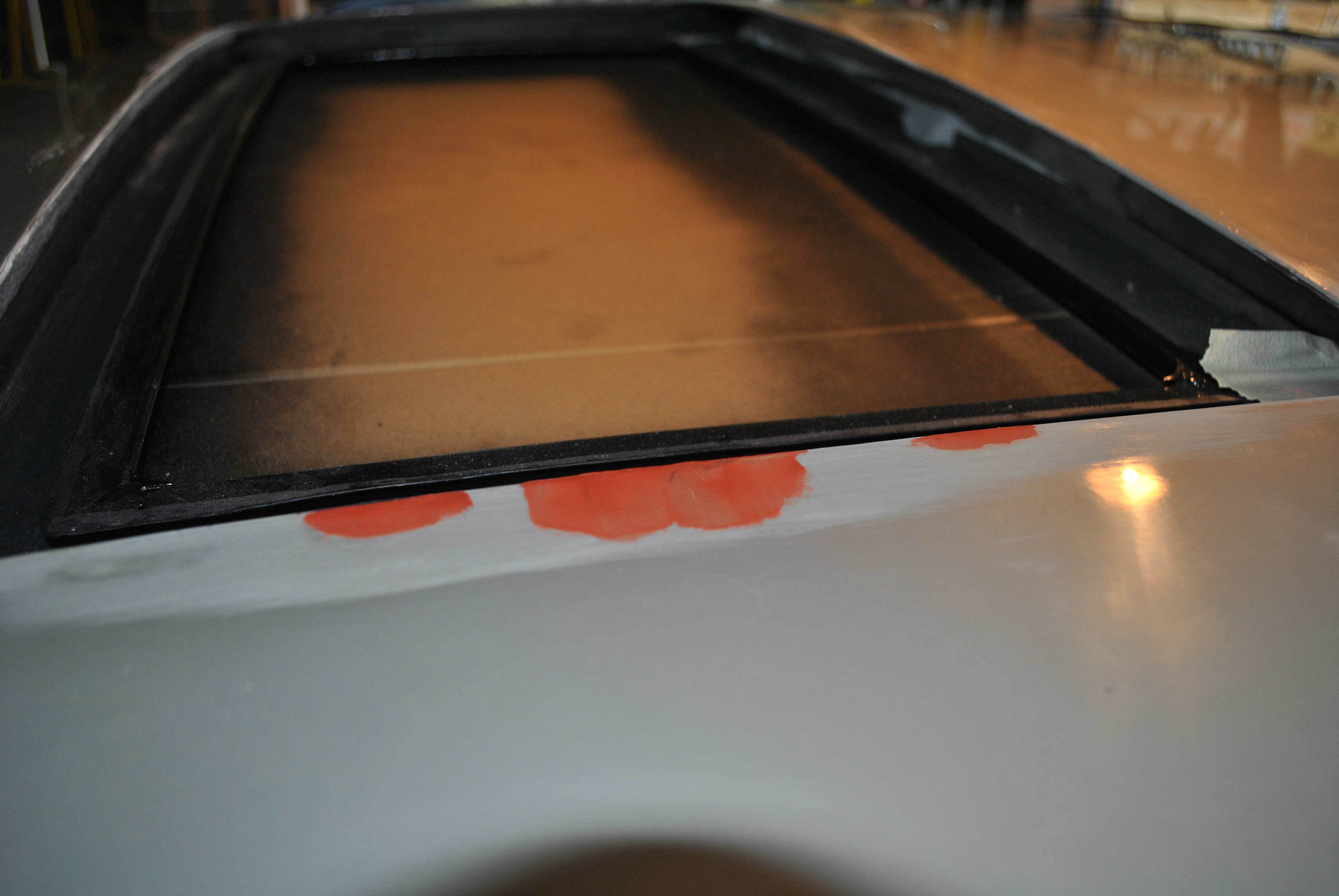

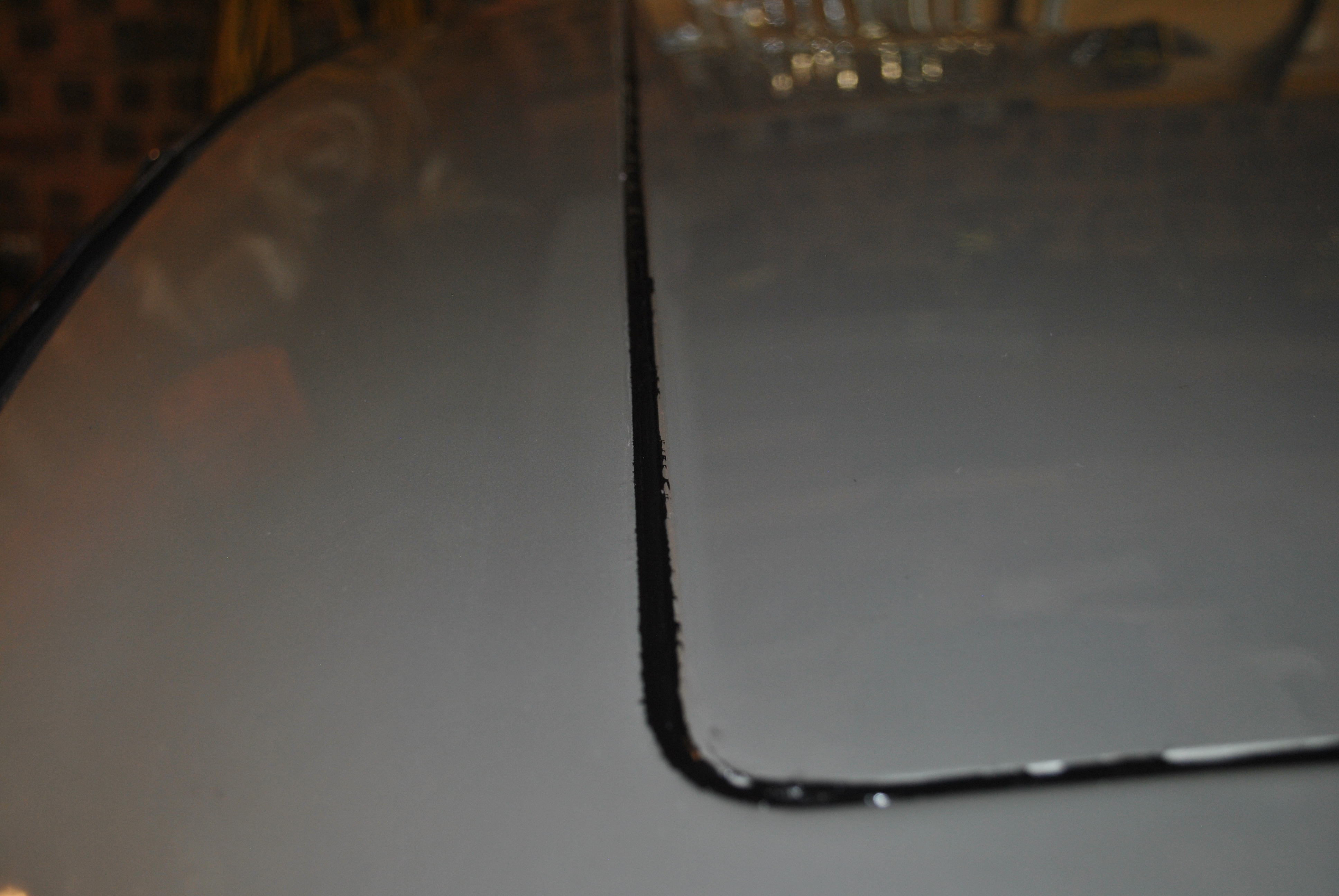

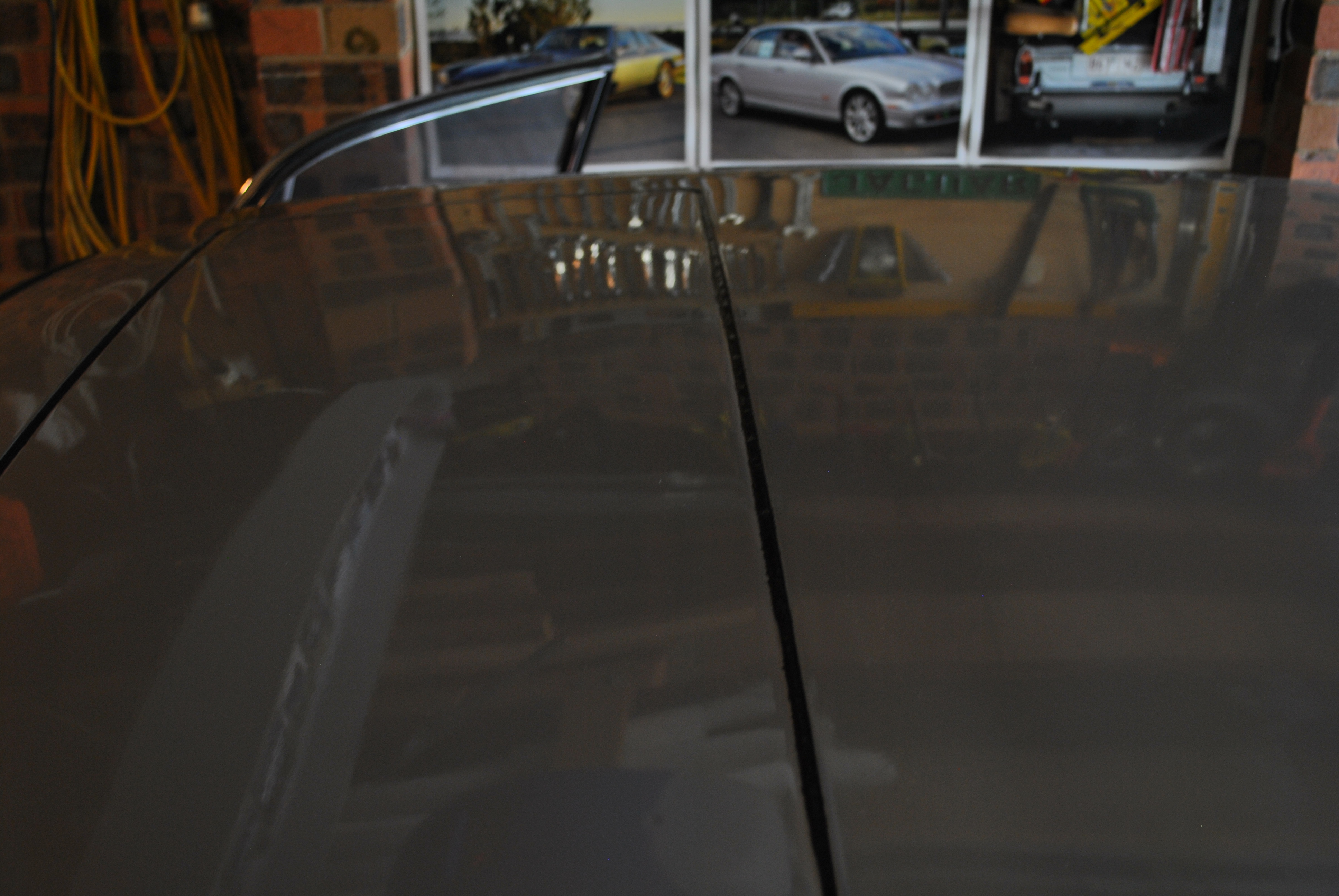

Four weeks to the day, the hole in the roof is filled. No luck with finding a seal. I posted the S3 seal back today. Tomorrow we will seal it up and put the interior back together.
At least the rust has been stopped.
Series 1 Sunroof repair-dsc_1488.jpgSeries 1 Sunroof repair-dsc_1489.jpgSeries 1 Sunroof repair-dsc_1490.jpg

Shame of all the hard work to end up with a sun roof that can't be opened...
Isn't there a way to make a seal from a standard rubber?
Old Mar 2, 2018 | 06:51 AM
  #49
o1xjr's Avatar
Posts: 28,386
Likes: 6,340
Expired all options, the 3 local guys that do sunroof repairs don't even want to look at it. (warranty issues for leaks we assume)
We will assemble and seal it up for now and continue to chase options for when the BIG repaint gets done.
Could be a couple of years before that happens.
As it happens the drive cable for opening and closing broke today, so no worse off than before. If we eventually find a seal we can deal with the cable then.

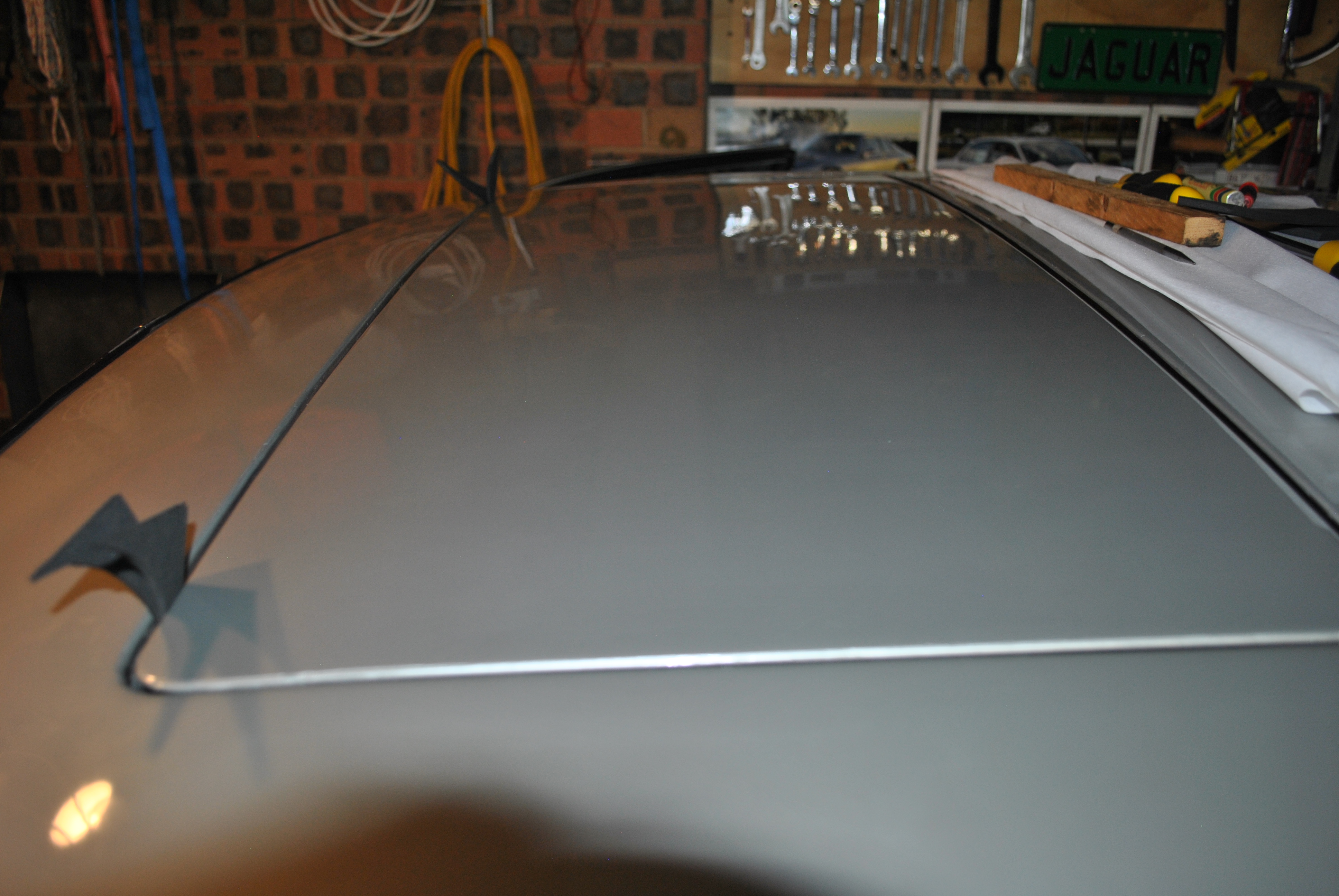

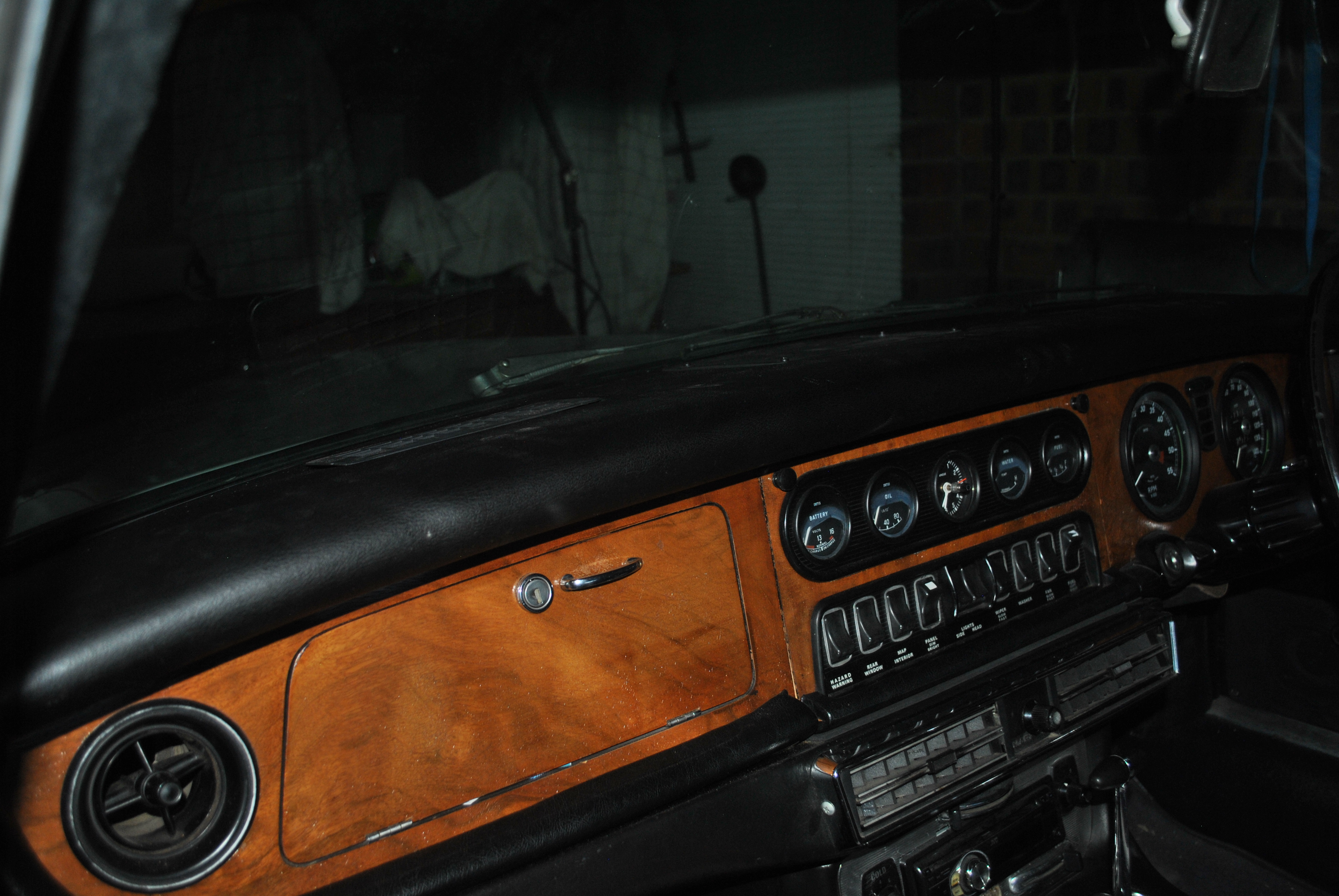

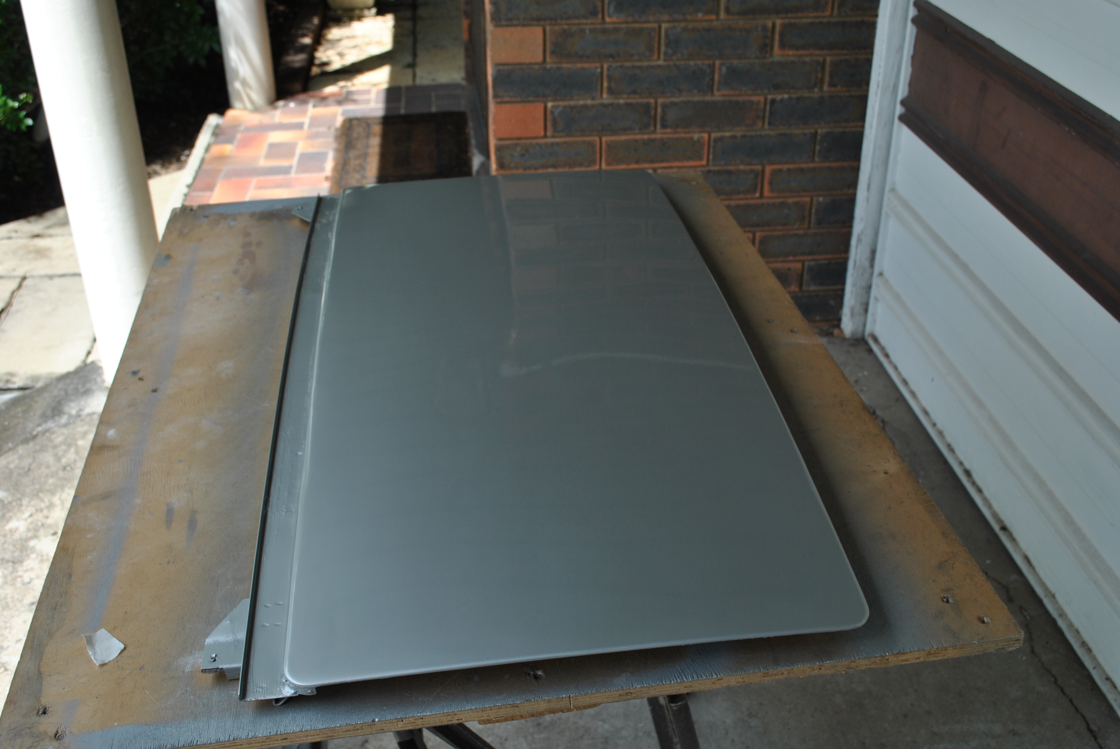

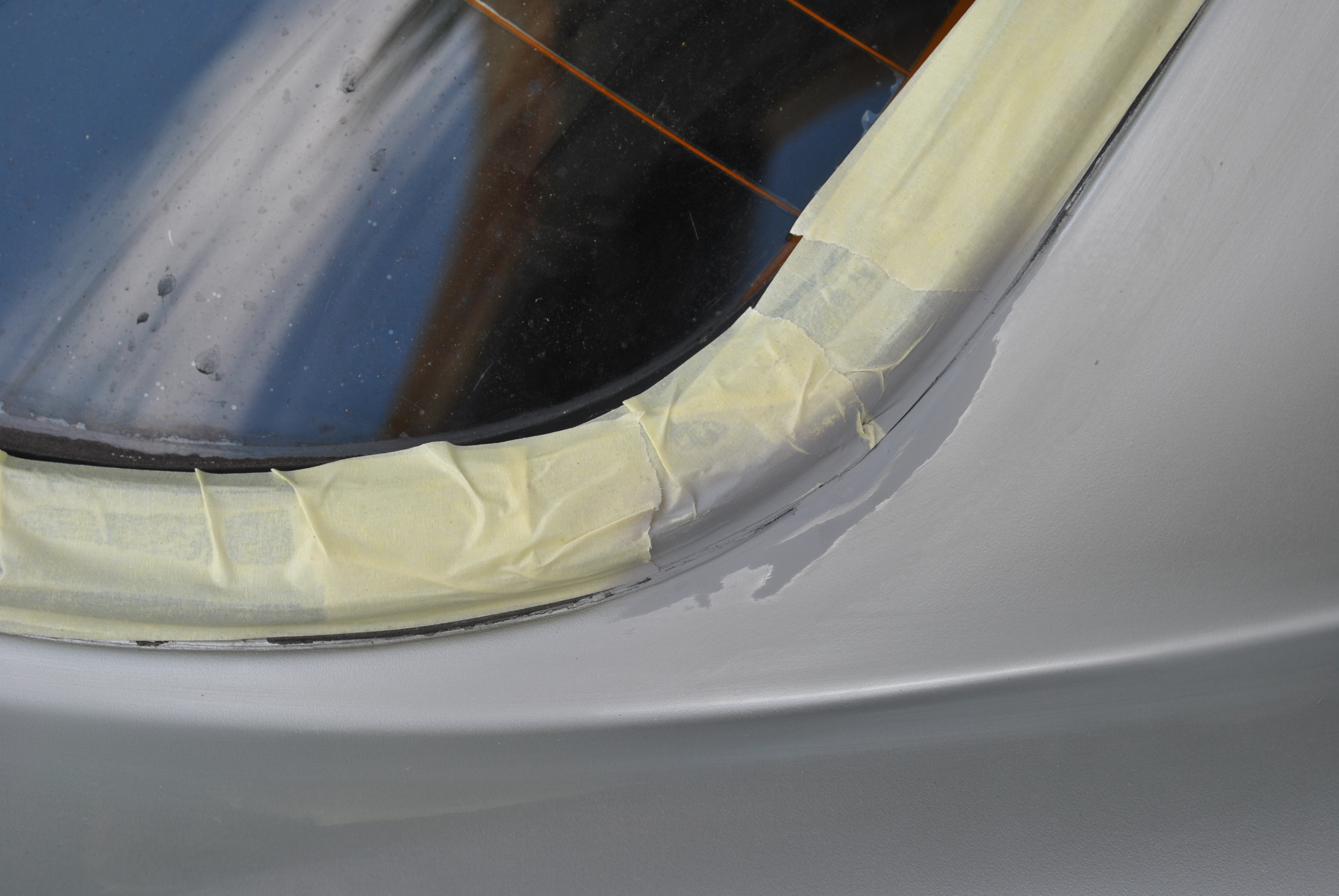

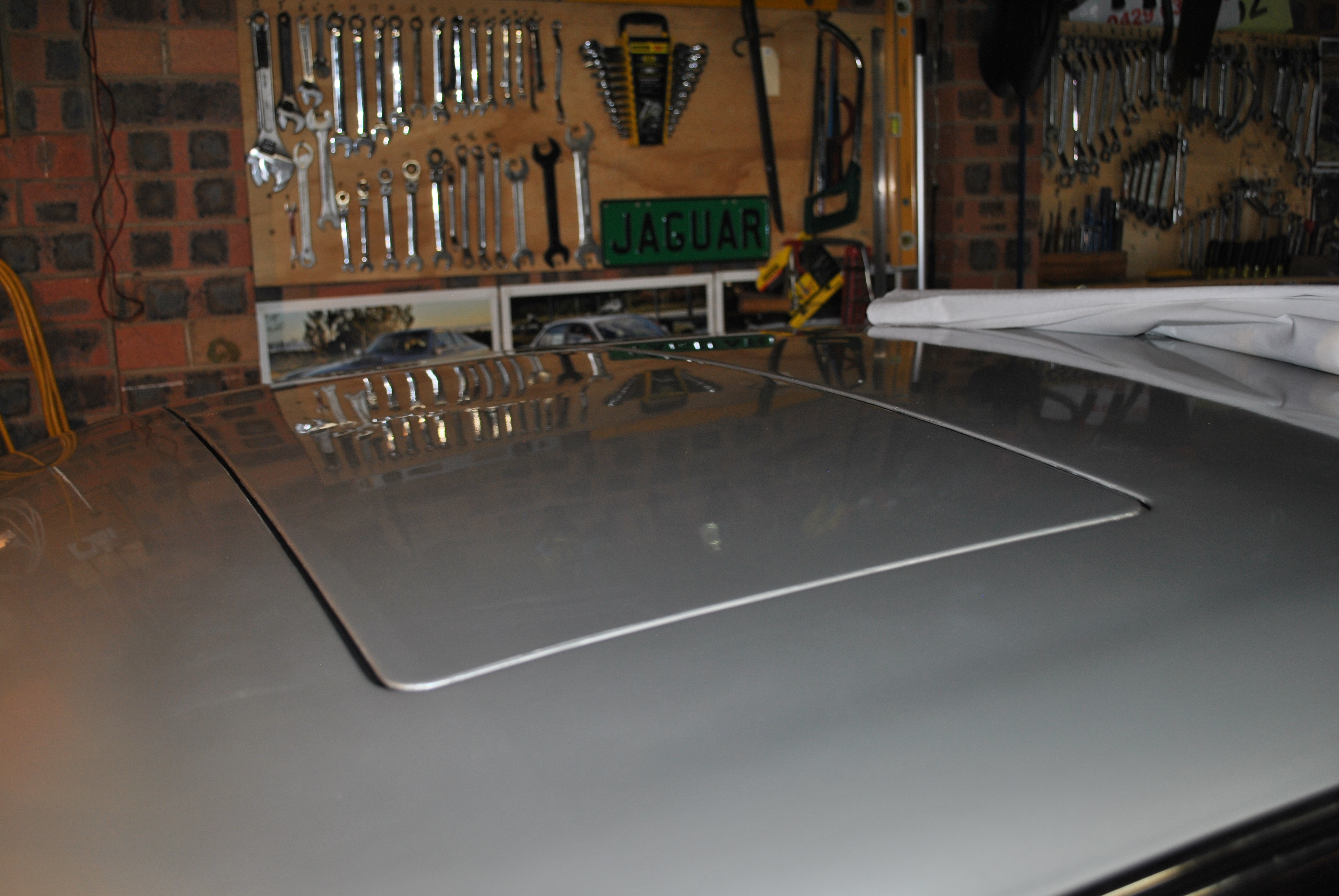

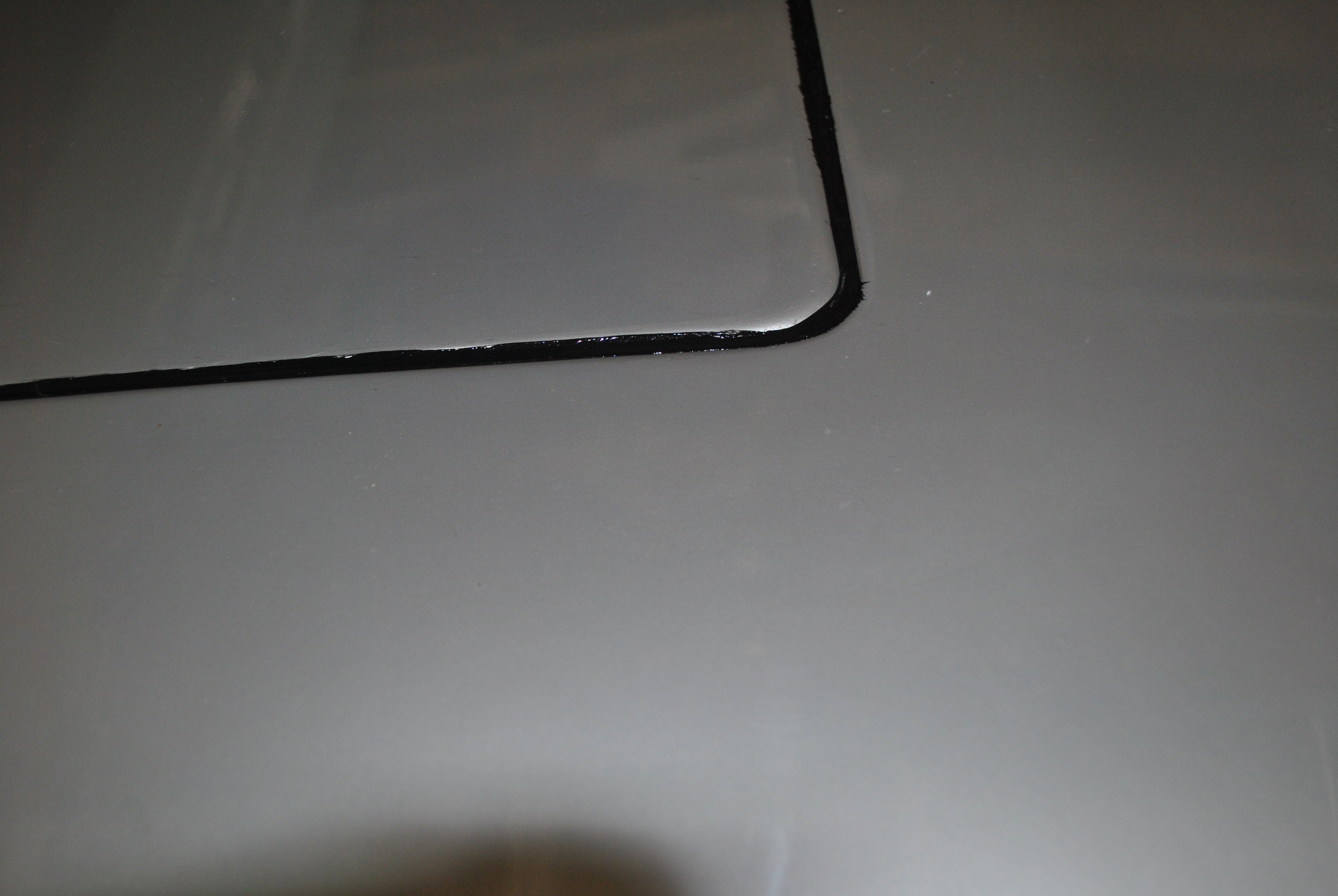

Job finished, new dash pad in as well. Have had the dash pad for 3 years but never had a need to remove it before now. The Dr called the shot. Old one was getting a little tired.
Series 1 Sunroof repair-dsc_1491.jpgSeries 1 Sunroof repair-dsc_1492.jpgSeries 1 Sunroof repair-dsc_1493.jpgSeries 1 Sunroof repair-dsc_1494.jpgSeries 1 Sunroof repair-dsc_1495.jpgSeries 1 Sunroof repair-dsc_1498.jpg

Not the best finish i was hoping for but sure it will buff up good.Big week but final result is all we could hope for. No water getting in there again. lucky we went for a drink to celebrate the finish. Clarke can drive Fireball again. I think he missed her.

[QUOTE=o1xjr;1851989]Job finished, new dash pad in as well. Have had the dash pad for 3 years but never had a need to remove it before now. The Dr called the shot. Old one was getting a little tired.
I'm sure we can re-furbish the old dash pad so it can be put into storage as a good spare if ever the time arises that we need it. It only needs the covering to be re-glued in a few places.
