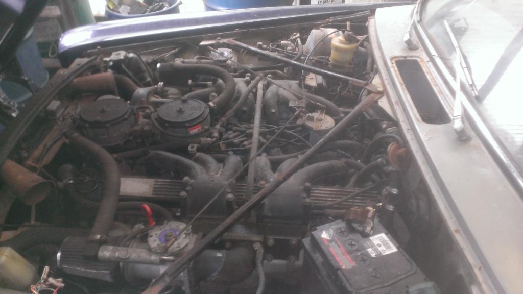

Hi all,
Yesterday I took possession of a rather sad looking 73 XJ12L. It comes with a healthy V12 that is on dedicated LPG with twin vaporizes and gas research throttle bodies. It also has twin LPG tanks and has had the petrol tanks removed along with the carbies and the fillers installed neatly under the filler flaps.
The car comes with a spare set of screens, full set of mint seats, spare bumpers, full door and screen rubber set, almost mint pepper pots and too many other spares to mention. It does need the sills completely replaced and the inner sills patched up but apart from that I got mint bolt on's with it (doors, wings, bonnet, boot ect). So although there is a bit of work it shouldn't be too hard or expensive to end up with a mint and quite rare classic XJ.
The donk with its LPG system
A wee bit crusty, through the inner sill too!

Thanks guys, I could not resist buying it when it came up, if for nothing else then the pepperpots for my series 3!
Fraser, you are right, the original bolt on's had plenty of rust in them too but the car came with a full set of absolutely mint guards, doors, bonnet, boot, chromes ect so this rust and some under the boot is all I am left with. Ive had it on the hoist and had a good poke around and was pleasantly surprised. What ever under body coating jaguar used has done an amazing job at preserving the car! all around the screens and filler caps are basically mint, of course with very small rust bubbles under the screen rubbers. Come to think of it where the floor pan meets the firewall in the wheel well is a bit questionable tho.....

What is the metal like around the rear radius arms mounting to the body ? This is the start of a U-shaped box section that goes all the way round the back of the wheel arch, and is well known for rotting away at the bottom 4". Also there is a cross member under the radiator, another well known rot point, and also an upright box at the front of the inner wheel arch, yet again a rot point. You need to have the wings off to inspect properly. Back of the rear wheel arches will be rotted out, I'm sure. I am only going on what I have personally seen over the years. I had a Series 3 for 14 years and did a lot of body work.
Trending Topics
The area around the radius arm was the first bit I inspected up on the hoist and its like the day it left the factory thanks to the undercoating. There is no wool over your eyes on the rear wheel arches tho I must admit. The bolt on panel that runs from the wheel arch under the tank are absolutely rotten to bits, however, the car came with mint ones. I had a quick poke at the rad cross member and it looked solid.
i know where you are talking about the rust on the bottom of the A pillar where it meets the sill as this is the only structural rust in my series 3, its basically rusted half way off! Ill fix this up one day when the mig is warm.
I really did expect much worse, the sills as you see are an issue. I almost didnt buy it because of the rust in the inner sill but at that stage i had basically committed to it and now looking at it, its going to be quite easy to fix with the interior and outer sill out of the way.
I spent an full hour under the car with a screw driver looking for rust but apart from the boot floor I found no more then i knew about and much less then I expected originally being a British delivered car.
