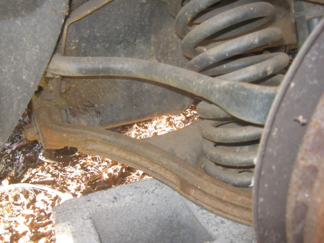

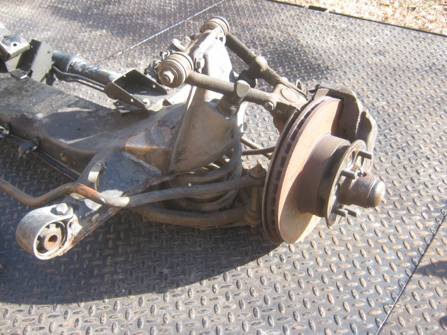

I'm going to say no... The suspension on the XJ40 was completely redesigned, so that none of the parts should be interchangeable...
I'll attach some photos.. These are off an X300, but similar to the XJ40... (I think)..
These will show the difference of the design of the upper wishbones...
When you are doing the changeover from the S1 to the S3, you have to change the uprights and axle carriers...

Here are some of the Series 3 Front Suspension... I'm thinking there is enough of a difference that the axle carriers would be different as well..
