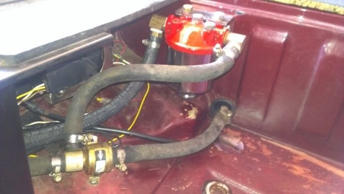

I've flushed the tanks, replaced the tank strainers, fuel pump, filters and pressure regulator. I have installed a large Fram filter prior to the pump (see pic).
I'm only getting 28-30 psi regulated pressure and 75 on a dead headed pump. Have not yet checked pressure during the times when it stalls out. I know regulated pressure should be 36 psi, but thought it should still run at lower speeds.
My thoughts now are that I've done all the right things, but not in the right order. I've installed a new pump (again) and will replace the intake filter element and recheck pressure prior to starting and driving it. If it stalls again, I will check pressure at that time also.

When you replaced the element in the pre-filter, how did it look? Clean? Dirty? So-so?
Rusty fuel with a little residue. Bought several extra elements. Wished I would have installed this filter prior to replacing pump.

I'm thinking the new tank strainers are catching allot of the residual rusty stuff still in the tanks but changing from one to another makes no difference, so ?
