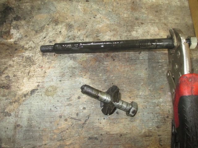

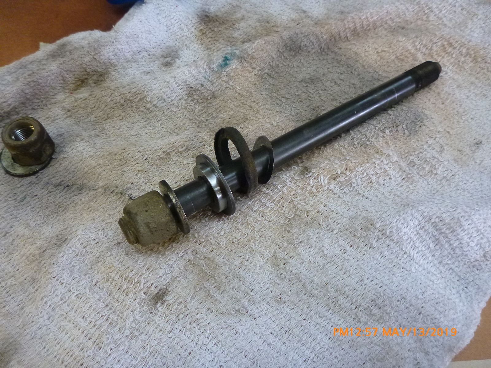

I've always regarded Spare Parts Catalogues as far more helpful than Workshop Manuals & I just had my thoughts reinforced again!
When I received a screen shot of the rear suspension I saw that the lower shock mountings are done via a single long pin with threaded ends. It was then obvious how to proceed:
1. Remove the nut & washer on both lower shock mounts & swing the spring/shock assemblies aside.
2. Attach a vice grip to the exposed pin
3. Attach a nut to one end (to protect the threads) & hit the nut with a hammer while twisting the vice grip. Finish the job with a punch just smaller than the pin diameter
The pin drifted out very easily.
The radius arm mounting bolt will now slip out with the hexagon cut off only just clearing the stump- it was the proverbial bee's knee of clearance!
The only hang up is that the spring was under slight tension & so the unit got longer when free of the pin so a spring compressor will need to be deployed to reattach the spring/shock units

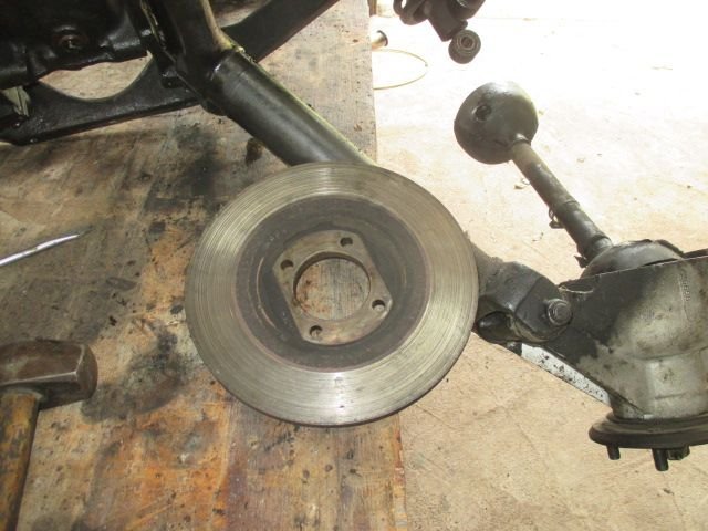

Well, thanks for that. I now see that with a DOUBLE jointed driveshaft a C/V joint would be superfluous.
Back onto the topic, I have discovered that when the uni joint on the disc is disconnected, the wishbone swings down & pulls the joint away giving clearance to remove the disc. *Thanks Dave!*
BUT, as the photo shows, the disc fouls the longitudinal arm of the wishbone and won't detach unless:
(a) the bolts are removed *Dave, can you please elaborate. AND the bolts are stuck fast. More heat required??*
(b) the wishbone pin is driven out and the wishbone slid forward to create more clearance.
Which way do I go?

Isn't funny when you write down what the problem is & you suddenly see the solution
By getting the IRS cage upside down you can pivot the swing arm out of the way & the disc comes off.
I'm happy to say we have stopped going backwards & can start to go forward

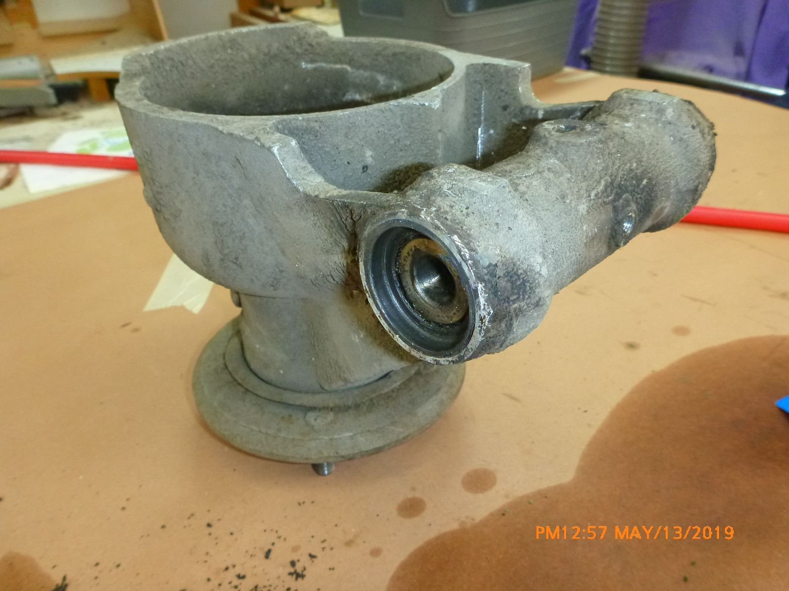

With the IRS on the bench, I have lubed all the grease nipples bar 2: both the outer swivel link pins on the rear hubs.
I cannot get grease thru and I'm using a MacNaught air powered grease gun. I've put new nipples in and have poked the holes with wire and given it plenty of heat via my oxy acetylene torch to no avail.
The housing is alloy so the link pins must be swivelling in brass (?) bushes, yes? Am I correct in assuming that the bushes have a hole that lines up to the grease nipple hole?
Do the bushes have a history of twisting such that the holes no longer line up so that pushing grease in via the nipple can't get thru any more?

The outer hub/fulcrum arm has tapered roller bearings, not brass bushes. The grease nipple in the middle of the outer hub casting pumps the cavity full of grease and eventually through the roller bearing. There isn't anything inside the casting that would block grease as the cross pin (big bolt) has plenty of clearance in the cavity. I wouldn't get carried away with using heat, there are seals outside of the roller bearings that could be damaged. If you have replaced the zerk fitting and still can't pump grease, the only thing I can think of is the cavity is already full and the grease is trying to flow through the bearings and pushing against the seal, all of which is held snugly in place by the fulcrum yoke. Look closely at the hub/outer yoke joint to see if a small amount of grease is escaping there. Also notice if the hub/yoke pin might be turning in the yoke (shiny area on yoke, no dirt caked around nuts, etc), if it looks like this might be happening, big trouble. The bearings might be rusted/seized to the pin and causing the pin to turn instead of remain stationary. I think this is unlikely.
Here is a picture of the bearing(s) in the outer hub.
Lower outer fulcrum pin through outer hub.
Old Sep 30, 2022 | 01:55 AM
  #37
geodon's Avatar
Joined: May 2019
Posts: 63
Likes: 16
From: Victoria Australia
Thank you!
That explains a lot and is a big relief.
I was expecting grease to come out of the ends of the pins like one would get when greasing king pins etc. But, as you have explained, the seals will stop this happening!.
You are quite correct in that I get a small amount of grease leaking out so it appears all is OK

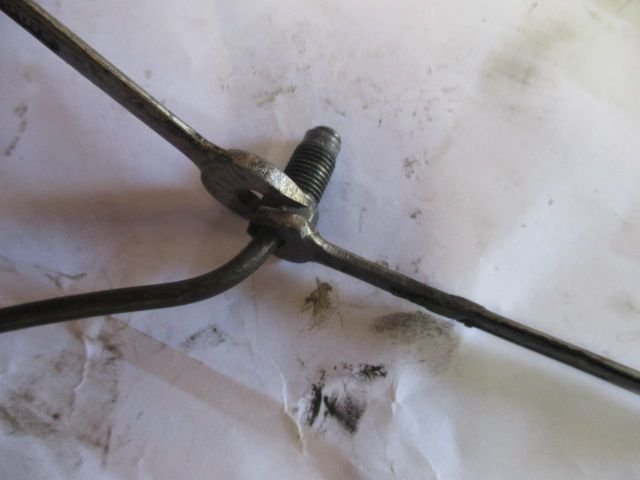

Default Getting 3/8UNF Hydraulic Connectors to Start Threading
Well after literally decades of frustration getting these damn things to start I think I have discovered a way to get them to go on 1st time every time.
Two open ended spanners, 1 small one to fit over the pipe ( I used an 8mm), one for the hex head on the fitting usually a 7/16AF
Make sure the fitting is absolutely perpendicular to the hole.
Use the 8mm spanner to push the fitting firmly into the hole & turn the hex with the 7/16
Worked magnificently for the cross pipes on the rear callipers. At one stage, I considered removing the callipers to put the pipes on!
