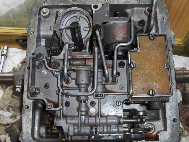

This thread on the Rover P5 Club Forum should be of interest to those that have the B-W T-66, which is an evolution of the the T-35 used in the Rover. You can see the details of the innards of the transmission.
For the T-35 in my MGC, I was initially very nervous about dropping the pan, but after I did it, I realized it was no big deal. 15 bolts, a new gasket, and you know that the cable is properly adjusted for certain. No worries about stretched cables, missing/moved crimps, etc.
