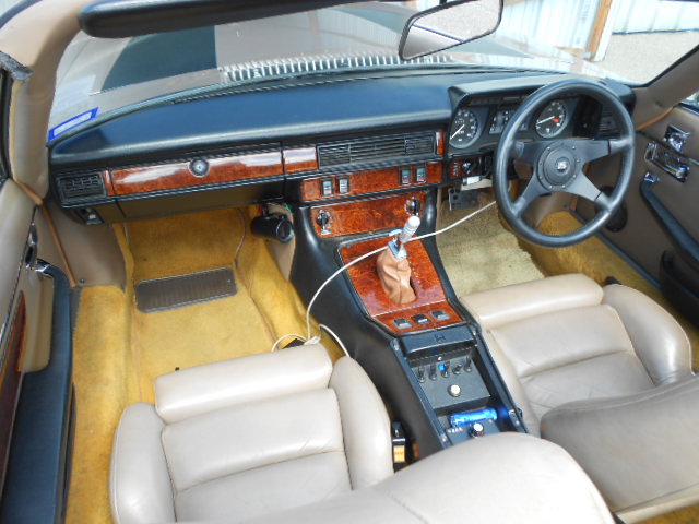

Originally Posted by JessN16
If you like it, it's the right one
Personally I think it's too much wood ...and in the wrong places.

I agree, its all about what you want, i have the nardi wheel! I used to lose points at jcna concours because its not original, but i didnt care! I love the look, so it stayed!

I love the Nardi wheels. Had one in my Series III years ago. The style is Jaguar-ish

pic of my steering wheel.
has a nice feel to it, slightly smaller than the original bus wheel.

The V12 I am probably going to buy tomorrow also comes with a Nardi wheel like in the picture.
