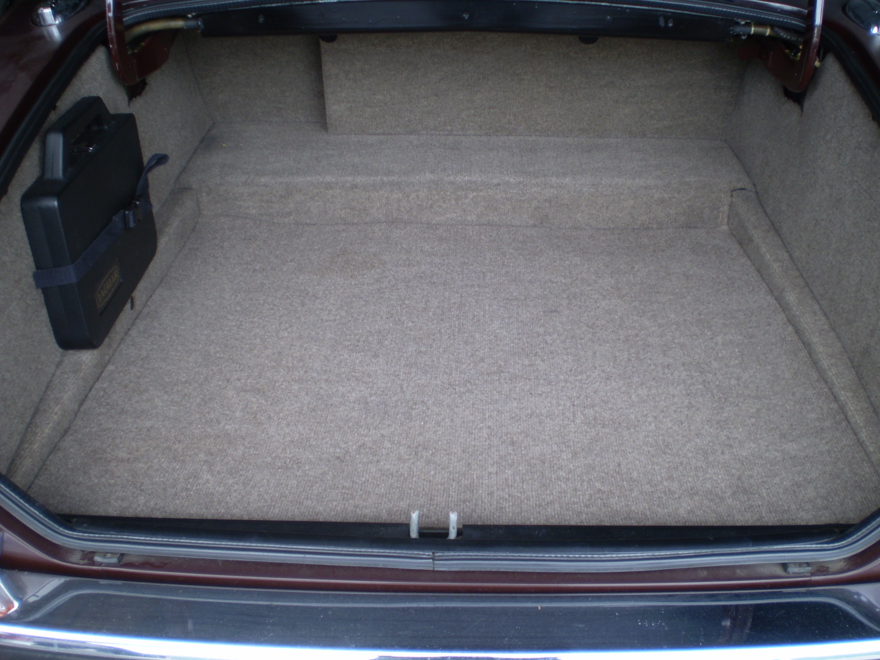

that's what I did, I found a brand new XJ-R "donut" and fixed the problem forever. The XJ-R donut is a heavy duty spare, not a flimsy donut.
David Boger got me a Series 2 hold-down and with an added spacer, made it work, the original hold down is way too long to use with a donut.

I am not sure of the year, but I purchased it in 2011. I somehow recall it being from a 2009-2010 XJ-R which was being parted out in my local Craigslist. The bolt pattern fits fine in my 1984.
leaves plenty room for the jack bag and the panel fits flush.

by the way, that horrible orange color of the spare "donut" wheel is the XJ-R factory original color, I suppose the factory wanted it that way to remind you it's a temporary spare. The tire itself is a very heavy duty Pirelli tire.
as far as I know, all Jaguar wheels have the same bolt pattern but I don't have one of each model and year to confirm. If a plus/minus 2010 XJ-R wheel fits my 1984 XJ-6, it is a fair conclusion to say that all years prior to 2010 will fit.
also some salvage yards in the USA like Pull-a-part, and You-pull-and-save give these donut spares away free. Otherwise I paid $20.00 for mine, it had never been used.
