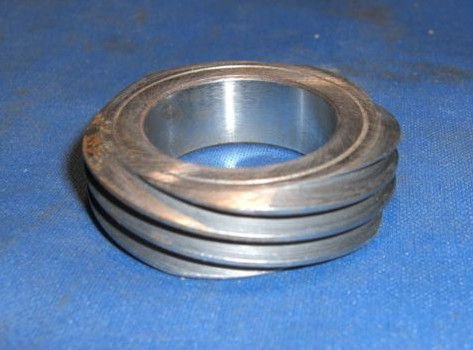

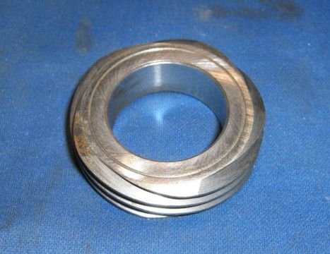

I found a couple of pics out in EBay of a C43875 in Europe that the Seller ended. Here are the pics, but I'll be darned if I can find any page in any Jaguar Series III parts manual showing that part???

In my catalog (RTC9885CF August 1985) it's shown here:
Group D Plate 1E 7L
DD

Only having a parts manual for a Series II which had BW65's, I don't have access to any Series III parts manual except online. And this is what I show for Group D 1E 7L. Maybe I should just start research a ratio adapter (with proper reduction).
