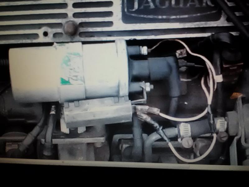

i have no idea how to boot a pic, but im hoping i attached the right photo.
ive read over the checklist and this is where im at.
ive had a starting issue for some time. sometimes it will click once and then nothing.
in the pick i hope i added.. i took the 2 white wires from the part (which i think is the starter solenoid) and it would crank and and keep cranking but not turn over. I plug them back in and car starts right up. but sometimes it doesnt start right away.
could a break in either of these 2 skinny white wires (the one going into the bottom connector has electric tape in the area of the break)
No, that's the ballast resistor on the ignition coil. The starter solenoid is on the starter itself
Neither of the white wires at the ballast will cause a "no crank" problem but they would cause a "cranks, but won't start" problem
