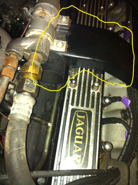

Another question while I think of it .....I'm hoping to clean the engine bay up a bit and wondered if I can safely remove this this black metal part that runs over the top of the motor ( i think this is part of the AED? ) and doesn't appear to be hooked up to anything...

That hot air duct can go in the recycle bin.
