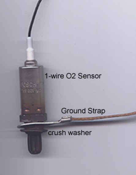

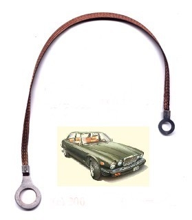

A fix (now forgotten) but which used to be popular in the 1990's, is to add a Ground Strap to the 1-wire oxygen sensors. It stabilizes the idling and makes it more "positive" (no pun intended, no snake oil either). (2-wire O2 sensors in 1986 and 1987 XJ do not need this fix, they already have a separate ground).
By now, these cars have deteriorating Ground due to grease and rust at the manifolds, so adding a dedicated ground to the O2 Sensor has the desirable result of "energizing" the signal to the computer from the O2 sensor.
I added a Ground Strap to mine around 1995 and the result was inmediate, a more stable idling, even faster starts as a side effect.

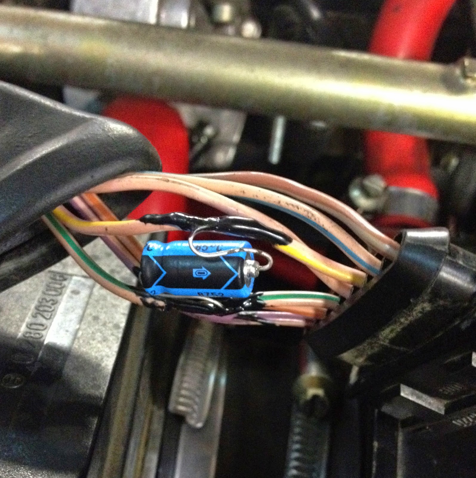

Per advice from a parallel thread on Jag-Lovers, I've had the "cap mod" installed and the cold-to-not-so-cold stumble seems to have vanished, hopefully for good.
I found the photo on the cap mod write up a little hard to see clearly (camera movement maybe)so here's a couple in progress shots, in case they're useful to anyone else:
wires stripped:

The capacitor soldered into place and sealed with liquid rubber:
http://3.bp.blogspot.com/-cB5F3ESXVF...0/IMG_0810.JPG
wires stripped:

I got the capacitor here: Electronics Plus - Hard to find parts and accessories, available and ready to ship!
Honestly, I just asked for a "100 Micro Farad, 25 Volt Electrolytic Capacitor" and the man disappeared for a moment, came back with two versions; one with both poles coming out of one end and the other, which I bought, with positive and negative coming out opposite ends.
It was less than $2.00 U.S. with tax. Drop them a line, I'm sure they can help.
