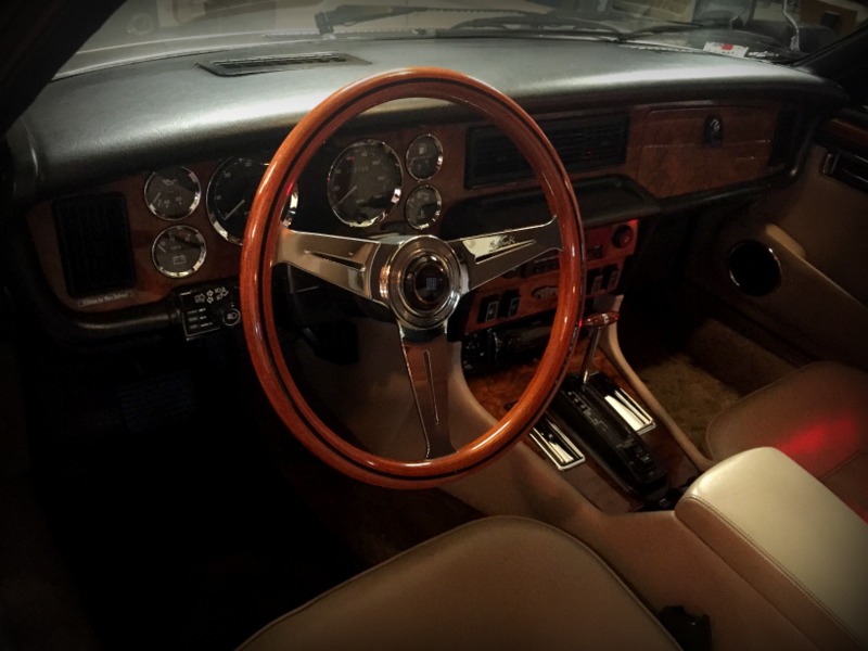

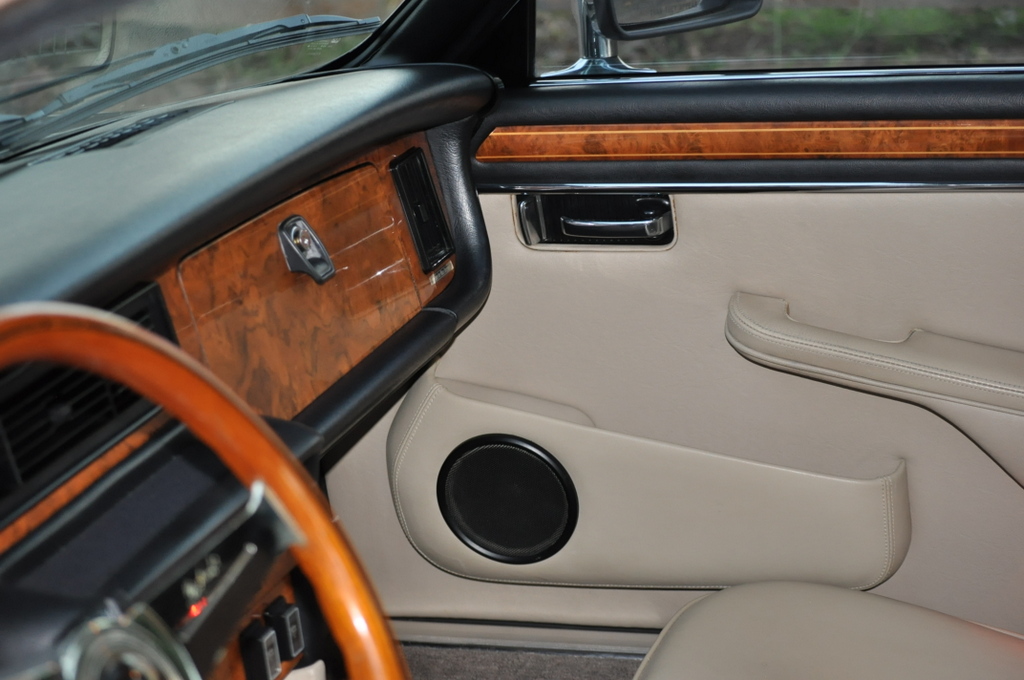

Have been chipping away at a few things as time and money has allowed. I am driving this car about 50% of the time now so did also attend to a few mechanical things like all new belts and hoses, new fuel injectors, etc etc.
Idling smooth and feeling very reliable.
But, I also have been working on interior. Here is a couple of pics, though apologize for the quality, hard to get the lighting/flash combination just right to where I am happy.

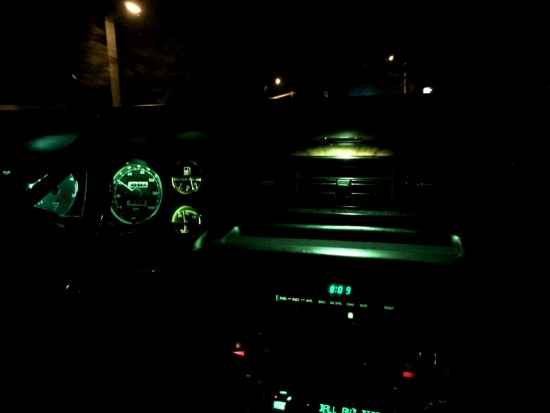

Since the last post I have changed all of the gauge lightbulbs to LED, as well as the rear opera reading lights and the Opticell light. I really like the ones I have done, but at this point don't think I will change anymore. The gauges are nice and bright and my a/c controls are now at least visible. But the softer glow of incandescents on the interior lights and the outside lights seem to be more fitting of the car.
But I did find that compared to a modern car, just the dash lights alone the car seemed dark inside, lacking the little ambient light touches most cars have today. So I popped out the bulb on the front center map light, right in the center of the dash. Then went and got special green glass paint at the craft store and painted the bulb.
Now, when I am feeling like a little ambient light at night I just turn on the map light and it looks very cool and does not interfere with my night vision at all, which these days isn't so good so I am a pretty good test case.
I also changed out all the black bezel trim rings for chrome. I did try stripping and polishing the existing ones - it doesn't work on these cars, see my separate thread on that topic! But, The Speedometer Shop (Home) carries brand new chrome plated rings in the right size and shape. They say they are for Smith gauges but they worked fine on the Veglia's. I did use some black silicone to seal them on but they fit and look perfect.
Also got some chrome ringed speaker grills from Dave at Everydayxj.com and installed them as well.
Ended up getting a new wood center console, didn't get the ones with the cupholders, still second guessing myself on that decision though the twin ashtrays are definitely a conversation starter. I mean, who sees even one ashtray these days!
Really enjoying the 1985 - affectionately known as Whitesnake in this household, in deference to the video of course! Driving it more than my 2006 Super V8 Portfolio, which is a pretty fun car as well!
Thanks again to all on the forum for the help and answering my questions as they have come up!

Nice work

That is a very relaxing looking cockpit.........nice!

Oh man, that is one VERY nice interior! May I ask where you sourced the console wood trim and the wood shift knob?

This is genius - I know its a very minor thing but the ugly bare white light of that map reading light has always struck me as well out of place even on my cars which normally have such other large interior problems, only I would ever notice or care. but WOW - makes a huge visual difference at night.
Thanks for the idea - added to my growing to-do list of interior work!
Cheers,
Thanks!
The console wood trim was an eBay find. The wood shift knob I got online somewhere but I would have to go back to my files to know where for sure. I got that well over a year ago and the ole brain cells just aren't what they used to be.
I know, cuz I have bought a few of these before, that the more expensive shift knobs (thinking $80-$90) are much nicer than the cheaper ones you find online. The quality on these varies a lot but if you look closely at pics you can usually tell the nicer ones.
Put the Nardi wheel on about the same time I remember....

Looks awesome!!! Do you have a summary of the bulbs you used??
You might be able to tap that map light to go on with the light switch to have full ambient. Ever since a 2000 S-Class I had, I've loved that ambient lighting look, so classy.

Let me see if I can find the list of bulbs I used, but I think if you search in the threads you will find at least a few postings with that info - its what I used to order them.
Regarding wiring into the light switch, I definitely thought about doing just that. If I go that route I may put in some footwell lights as well as lights under the seats. Have to be careful as its very easy to go overboard on adding lights though and pretty soon you look like a riced out Honda or Beemer. The plus side with leaving it as a switch is I have the option if I do want to shut them down, with the downside being I know at some point I will forget to turn them off and I will prob drain the battery. Good news is that if I do kill the battery it won't freak the car out like it does on my 06!

With regards to the bulbs, does this seem to match up to what you used:
Opticell Light
BA9S 5 SMD LED 1.5 Watt 12VDC - White 6000K
Tachometer Bulb
T10 Wedge 5 Ultra Bright SMD LED Bulb 1.5W W5W 12 VDC T3 1/4 - Super White
Speedometer and Gauges
E10 Screw Base 5 5050 SMD 3 Chip LED Light Bulb 12 VDC - White 6000K
The one concern I had was the tach bulb since it's a T10 wedge and I read in other posts that it might illuminate differently (less brightly).
Thanks Again!
Thanks Again!
Yup, thats the list. I found very little difference in the illumination between gauges. Not perfect but very close - and if anything the Tach lights up brighter than the speedo! I still don't find the Opticell bright enough, I just found a Cree bulb that should fit. More $$s ($35 vs a couple of bucks for most LEDs) but my Cree flashlights are amazing so I thought I would at least try it. Ordered it from Amazon but its a non-prime reseller so not sure when it will arrive.
The biggest bang for the effort though has been the green glass paint on the map bulb in the center of the dash. I really like it on, may go the full route and re-wire it so it comes on always with the dash lights.

Good to know! I think I'm going to follow your lead on the map light. It might be easier to just wire it to go on when the car is on. I've seen most of the ambient lighting on cars I've had on all the time, not just with the lights.
Keep us posted on that Opticell light. When replacing that bulb, did you remove the switches and console surround or do it through the storage bin? I'm reading conflicting info.
First time I did it I took the whole surround out but I was replacing the black surround with a burl surround I found on EBay. Since then have pulled the bulb out a couple of times just taking the cubby out. Should be right there near front. Easy.

Thanks for your help on this! Just installed the LEDs and what a great improvement. I agree with you the Opticell is a touch dim so I'm eager to see how you make out with your Cree light upgrade.
