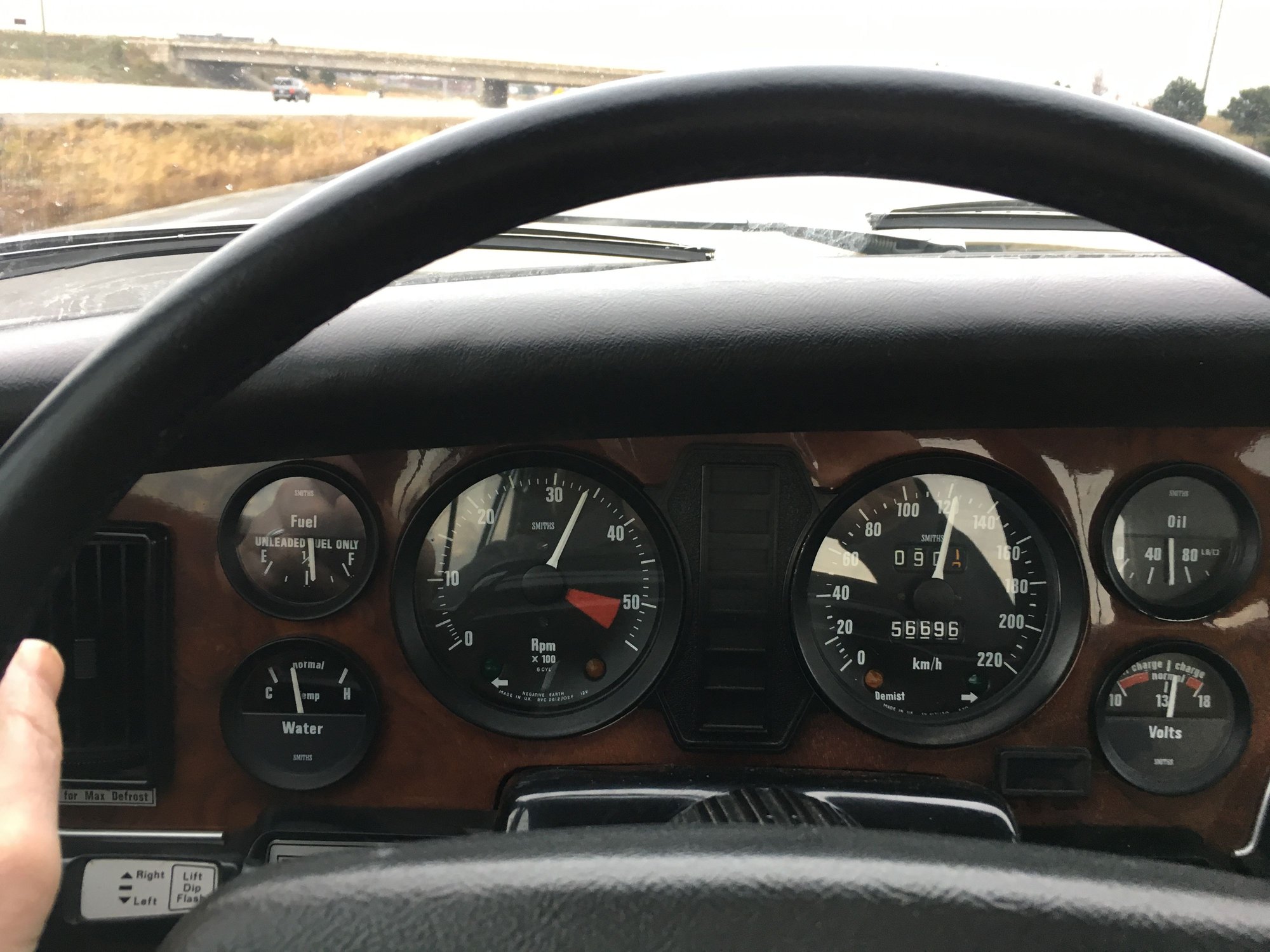

So drove the jag up to a friends place today. 2 hr drive on the freeway.
I noticed two things.
1) lots of wind noise from the windshield at 120-140km
2) lots of noise from the dash that sounds like the speedo
3) I still can't believe the auto 3 spd doesn't have overdrive. 120km is like 3300 rpm which seems high.
Is this Normal across the board?

Originally Posted by Doug
Air leak noise, like a whsle? "Wind rush" noise....like the outer rubber not fitting properly; ie: protruding and catching the wind?
No just wind on the windshield. I guess it's pretty upright.
What kind of noise?
A cable drive speedo can make a clicking sound, as can the cable itself
Yes that's the sound. Does it need service or is this just the way it is.
Is this a Series II car? If so, many had a 3.31 axle ratio...so your RPM at that speed sounds about right. In contrast, most Series II cars had the 2.88 ratio. 80 mph = 3000 RPM
Yes it's the last of the series II a 79. I guess I could change the ratio if and when I need to fix or replace.

Old Nov 19, 2016 | 03:04 PM
jordanmc's Avatar
Joined: Aug 2016
Posts: 175
From: Toronto
Default Rpm
