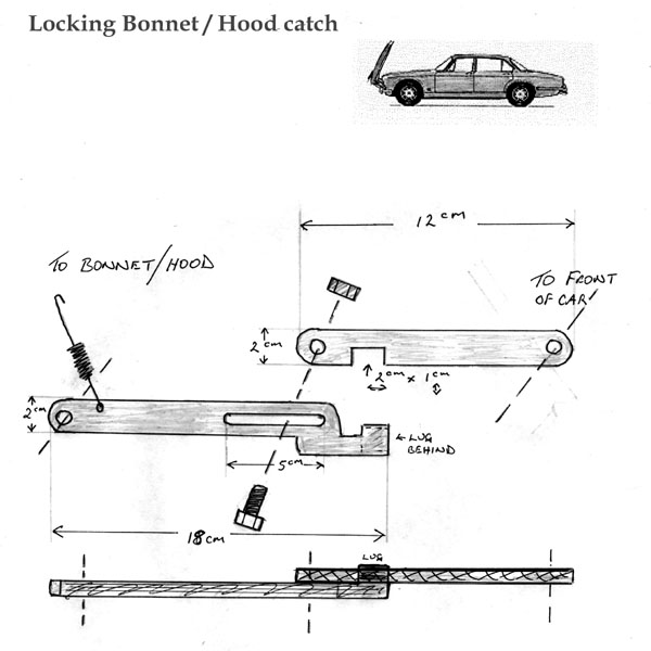

5) you can modify the Hood Stay Bracket to allow opening more than the stock 45 degrees and stay at maximum opening angle by fabricating a new Stay Bracket out of aluminum or any other metal you prefer. Below is a picture of the bracket measurements needed.
