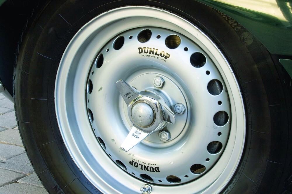

I wore out a set of Michelin MXW's, around 1988. They wore out prematurely and Michelin refunded the purchase amount.
I'm thinking about bumping the rims up to 16".
Maybe I could source some good tires for a lot less?
I have been looking at the reproduction Dunlop center-lock aluminum rims.
I am looking for some spline-drive hubs, right now, to make the conversation.

16" wheels will give much better selection of tires
DD

Your existing 205/70x15 should have a diameter of about 26.3"
Find a tire for the 16" wheels of the same diameter....or as close as you can get.....while still being appropriate width and load rating for the car. This will mean a lower profile sidewall. I'm sure there's something out there that is close
