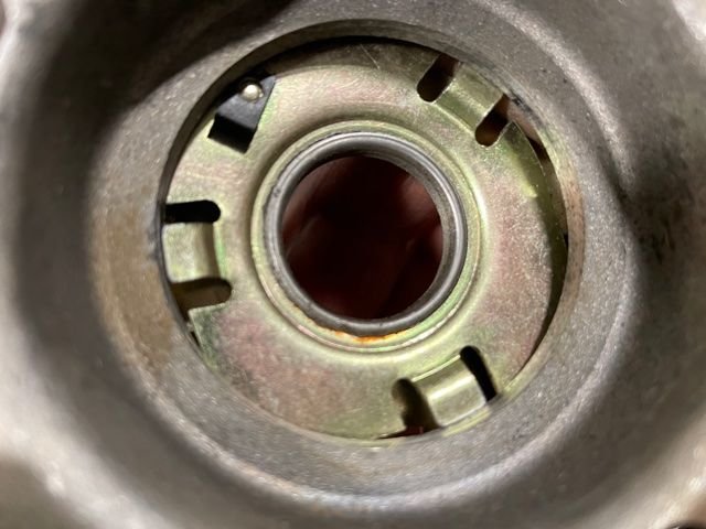

Base plate scuffing
On reassembly I was naturally attentive to anything that would account for this issue. I made a bit of a discovery on this.
The pickup coil base plate is held in place with two small screws but is located into position in the distributor housing by three tangs. These tangs are an interference fit into the housing. Very interference as it turns out. It is possible to install the pickup coil without the base plate being fully and squarely seated. This naturally throws the geometry off and can cause the reluctor wheel to drag against the base plate. The hold-down screws are tiny; nobody would ever dream of tightening them so hard so as to push the base plate fully home and, if they did, the threads would probably pull of of the aluminum distributor housing.
To solve this I carefully bent the tangs downward just a mere fraction of a fraction of an inch. This allowed the base plate to be reliably seated fully home, and perfectly flat, into the distributor housing using a bit of thumb pressure.
With this new insight I am convinced that the base plate was not fully seated when I replaced the pickup coil a few years ago.

I forgot to mention something.
The teeth on the reluctor wheel are becoming eroded. I forgot to take a picture but just imagine the tips of each tooth looking a bit jagged and crumbly.
I'm not sure how this effects operation. I'll be looking for a new one.
