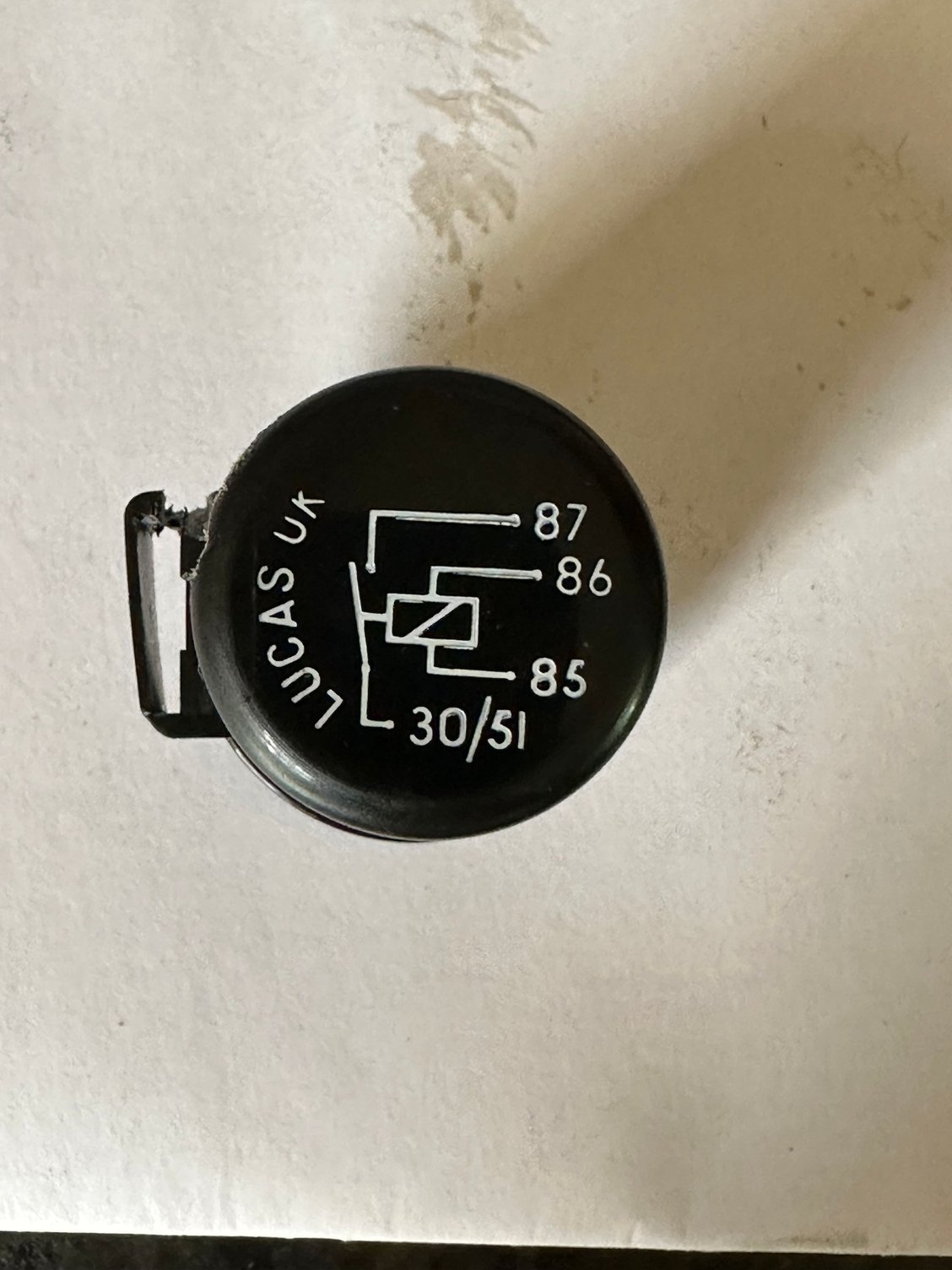

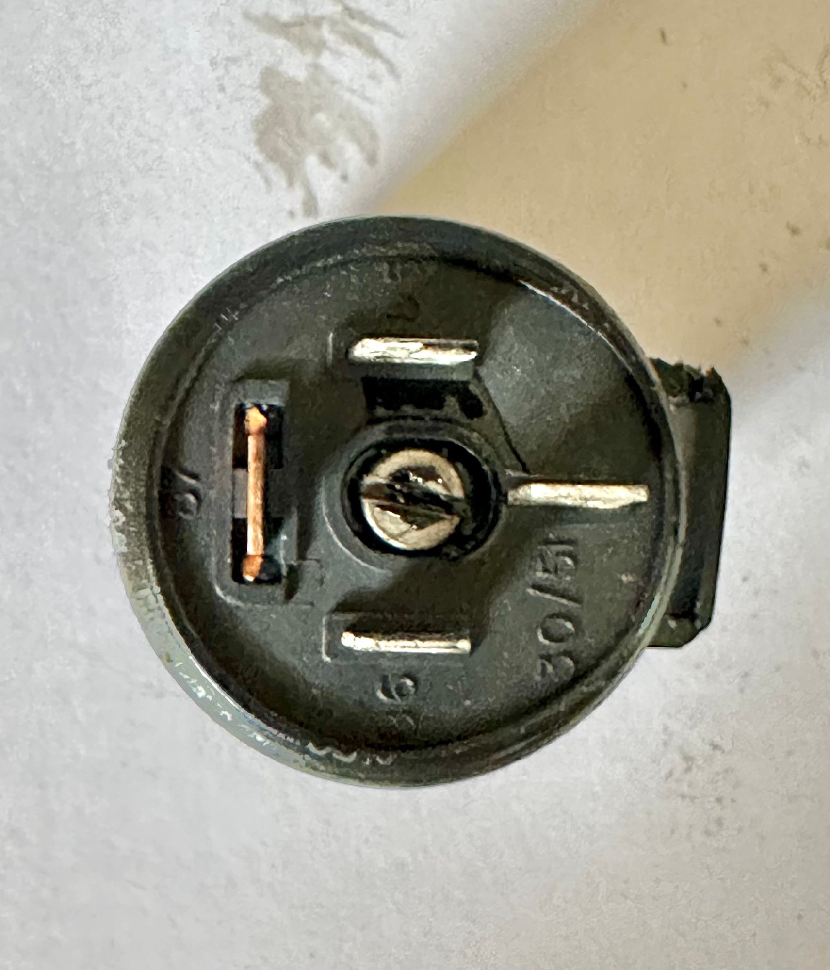

1977 XJ S2. Original turn signal flasher unit died. The Lucas replacement is currently unavailable so I got the DAC 1731. No schematic and the lugs are numbered differently. So I took a guess and hooked it up in the same order as the original. Turn the key, and it starts cycling on its own without touching the stalk, and neither signals or indicators light up? Any suggestions?

that does not look like a flasher, it does look like a relay.
do you still have the old flasher ? Post a photo of it.

That round device is it. I think. Any turn signal flasher of that vintage I’ve ever seen was a round canister.

I think a flasher is different.
In my 1984 XJ-6, the flasher is a Hella TBB44. It also has the following number and markings on it:
4DB003425-03
2(4) x 21W+0...5W12V
Made in Germany
A 71373 DOT
The terminals are marked 31 49a 49 C
