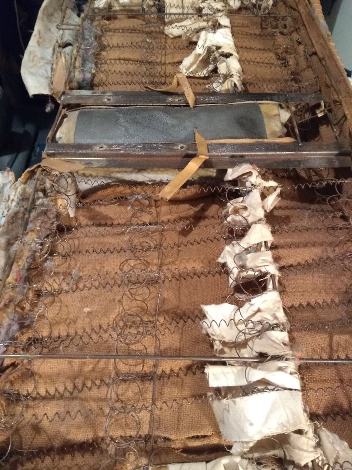

So I skinned the back seat, heck of the lot of little square nasty clips held the skin to the cylindrical frame bars. How I assume that I can get a tool that allows me to reattach this all in some manner?
Perhaps I should have asked that before I skinned her, but I like challenges. The top of the seat is cracked from sun perishing.

I want to say the tool is called hog ring pliers, but it’s been a long time!!

The nasty little clips sure have a hog ring vibe to them.

Yes, those clips are called "hog rings" and are a staple (no pun intended) of the upholstery industry. And following that, the special tool used to attach/engage them is the "hog ring pliers". Very readily available and easy to use.

You'll find hog pliers in a variety of configurations/shapes/sizes. My suggestion, FWIW, is to buy a longer style with a curve. The shorter, straight style may not allow the reach you need

Hog rings and pliers are usually available at upholstery shops. Sometimes at tool stores. don't buy the first one you see as better pliers make the job far smoother.

Like Doug said, buy a longer curved pair of pliers.
My experience recovering seats in the past is to go with leather. My experience with the reproduction vinyl seat kits was disappointing. The material is nowhere near the thickness and strength of original vinyl of the period, and I had issues with the stitching pulling out at a couple of seems. I eventually went with a complete leather kit from GAHH and while not inexpensive, the quality was top-notch.

XThe little rings are knwn as hg rings The tool is a hog ring plier i am aware of small ones and arge ones. m son borrowed mine!
Google for a suplier. i would be surprised if amazon did not have tem.
ny upholstery supply shop should.
In a pinch grid a groove in a chea ordinary plier

You can also use zip ties in place of hog rings. It's especially useful on areas where you need a precise amount of tension on the material.
