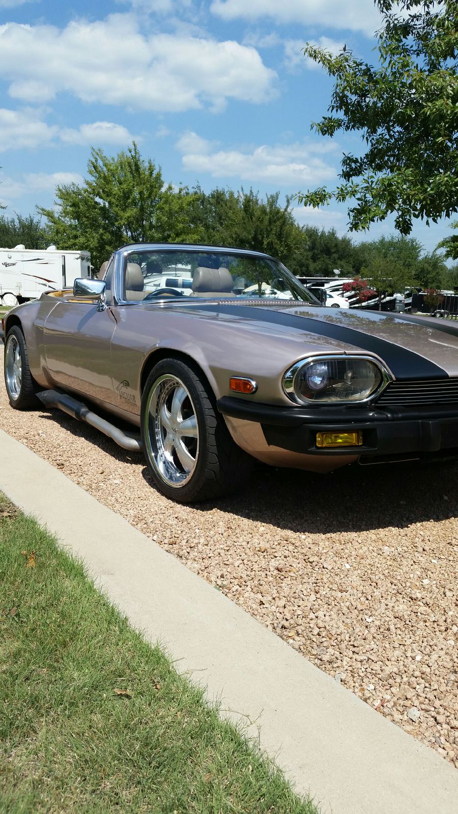

i have been able to pass some gas stations?
pre HE V12 i think is in love with gas stations, 3.73 ratio!
BUT it goes like hell , actually beat some Corvettes and others , i use a V12 for performance , and talk the talk!
MPG not important!
