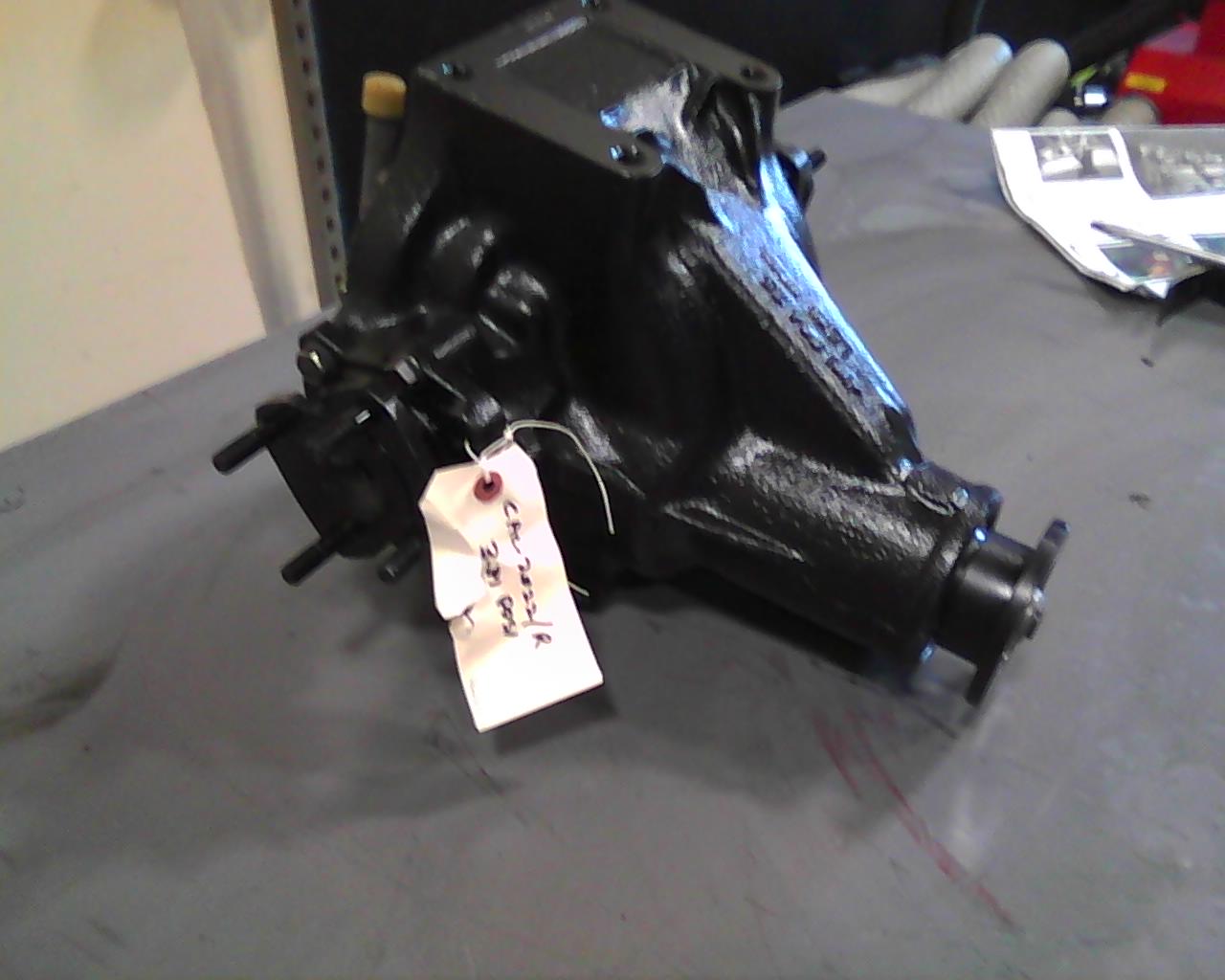

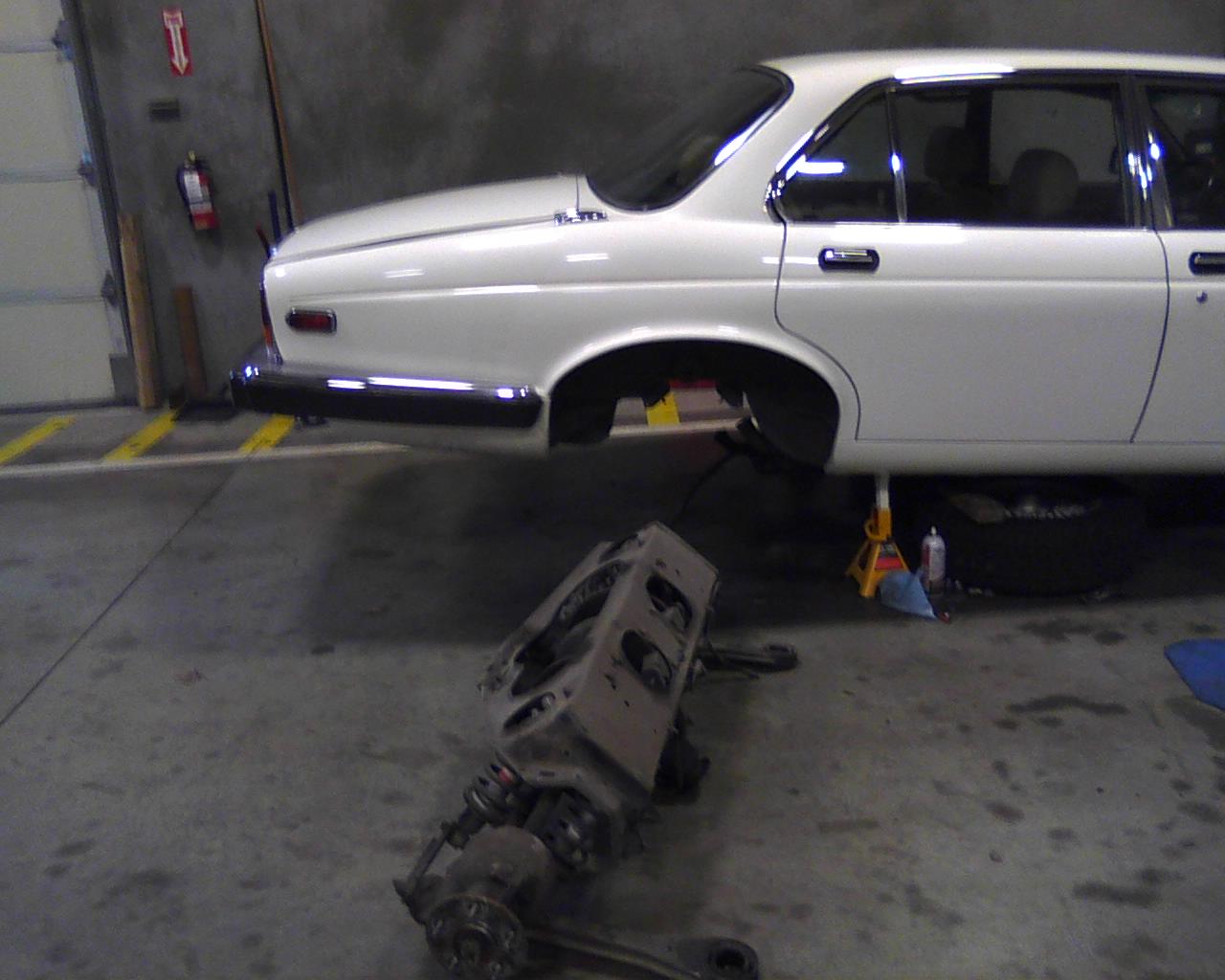

Differential replace and rear brake overhaul.
Removed the rear cage for the usual stuff: new brakes discs, pads, rebuilt calipers, flex hose, handbrake caliper repair. Also replaced the 2.88 differential with a rebuilt 3.31 limited slip unit.
As you can see it didn't 'restore' the rear cage....just a good rudimentary cleaning.
Had to replace two wishbone bearings, #18 in this illustration. All the other wishbone bearings were in fine shape.
Wishbones and Mounting-Rear - Parts For Series III Saloon | Jaguar Classic Parts UK
Replaced the seals for the wishbone bearings. Halfshaft U-joints were all in fine shape so I left them alone.
(One big aspect of this project is, for once in my life, avoiding 'mission creep'....getting carried away with "while you're at it" replacements. I'm trying to be very selective in this regard so as to stay on budget.)
The shocks are near-new KYBs that came with the car. These wouldn't be my first choice but they seem to work well enough for now. Replacing them at this point would mean spending money that is better spent elsewhere.
The hub bearings are smooth and quiet, and no free play. Left them as-is. The cage "vee mounts" show no signs of delaminating (or even cracking) so they were not replaced.
I also overhauled the front brakes and suspension....all the usual stuff there as well. However, the PO already replaced the rack bushings and they were still in good shape and left as-is, as were outer tie rod ends and, again, the KYB shocks. Front wheel bearings were in good shape and re-used. The large round subframe bushings were in bad shape and replaced but the rear subframe mounts still looked good and left untouched
Anyhow, the rear cage is reinstalled, needing only finish up: connect drive shaft, brake hose, exhaust, etc
More later !
DD

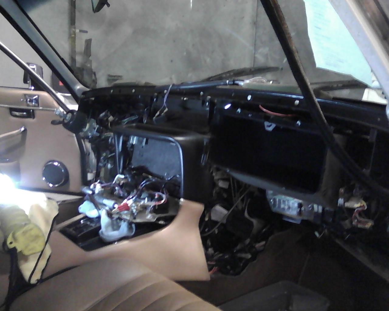

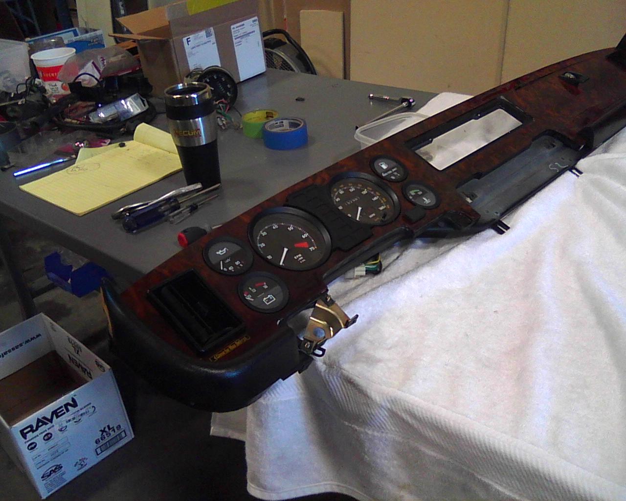

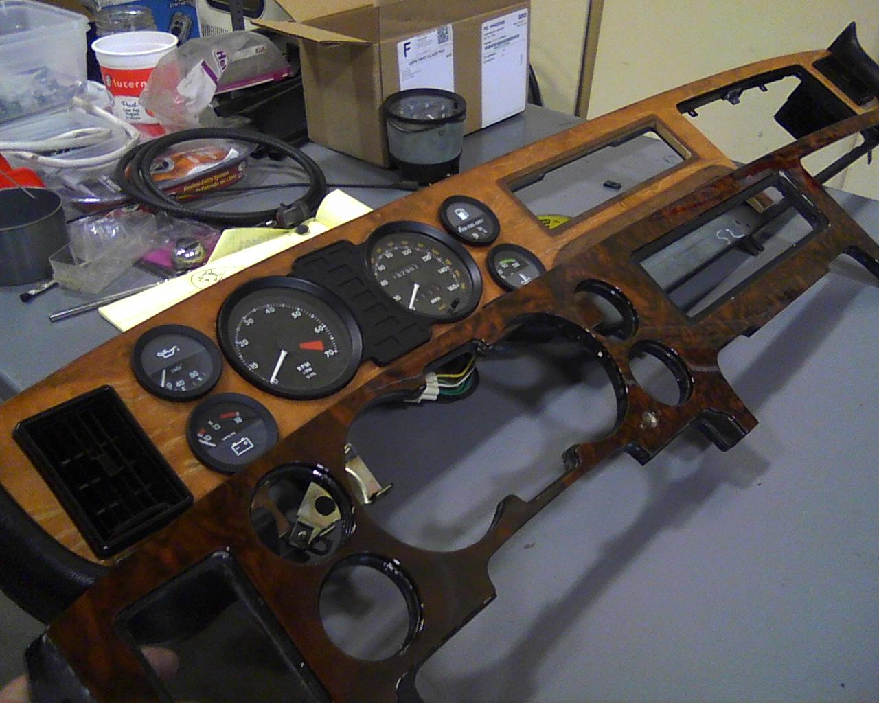

Dashboard replacement:
Nothing remarkable here but I thought those not familiar with the job might like seeing the pics. However, the task is nowhere near as intensive or dramatic as the pics might suggest. It's rather straightforward, really.
One of the pics shows just how faded and 'blonde' the wood becomes over time, versus the rich darkness of the refinished dash
I went from the standard XJ6 dashboard to the VDP/upper line dashboard because I prefer the look of the flush mounted gauges...and the 'figuring' of the burl is a bit tighter and more attractive
Sharp eyed Series III owners might notice the V12 specific tach and speedometer
DD
Attached Thumbnails V12 conversion project continued-dash1.jpg   V12 conversion project continued-dash2.jpg   V12 conversion project continued-dash3.jpg

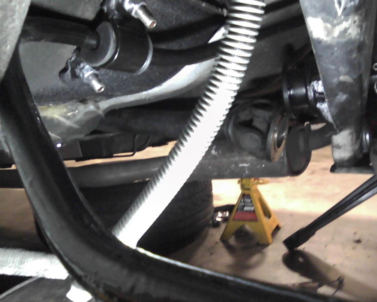

Rear anti roll bar
While the cage was out I installed a rear anti-roll bar from an XJS. This is fairly straightforward. The bar itself, the U-brackets to the body, and the end links are all right from an XJS. The brackets on the radius arms are from a Corvette ('63-82, about $7.00 each) welded in place. New end link bushings were installed (easy: just push 'em in with a bench vice) and new U-bracket bushings used as well.
The U-brackets are held in place with thru-bolts, as you can see. This part of the body is just sheet metal so .125" thick stiffening plates are used under the bolts on the inside of the car.
Some black caulking (seen in the pic) is used to ensure no water entry thru the bolt holes. You can also see that the bushings for the U-brackets didn't seat quite right....I'll have to reposition them jut a bit.
This area of the underbody has a large heat insulator panel...the kind that crumbles away if you so much as look at it angrily. I trimmed a large section away to install the bar. I have new, better material to fabricate a replacement.

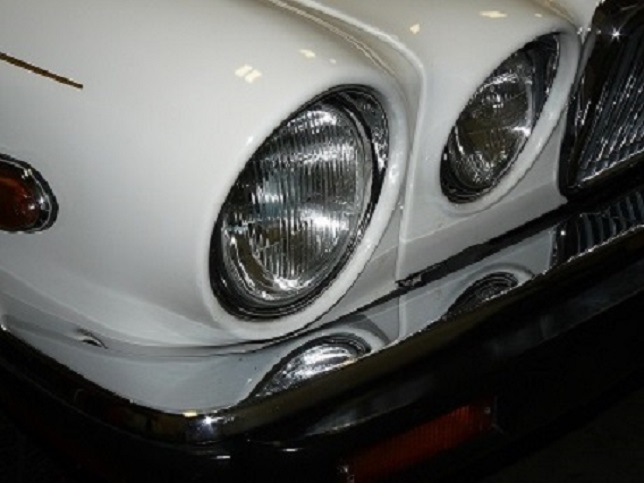

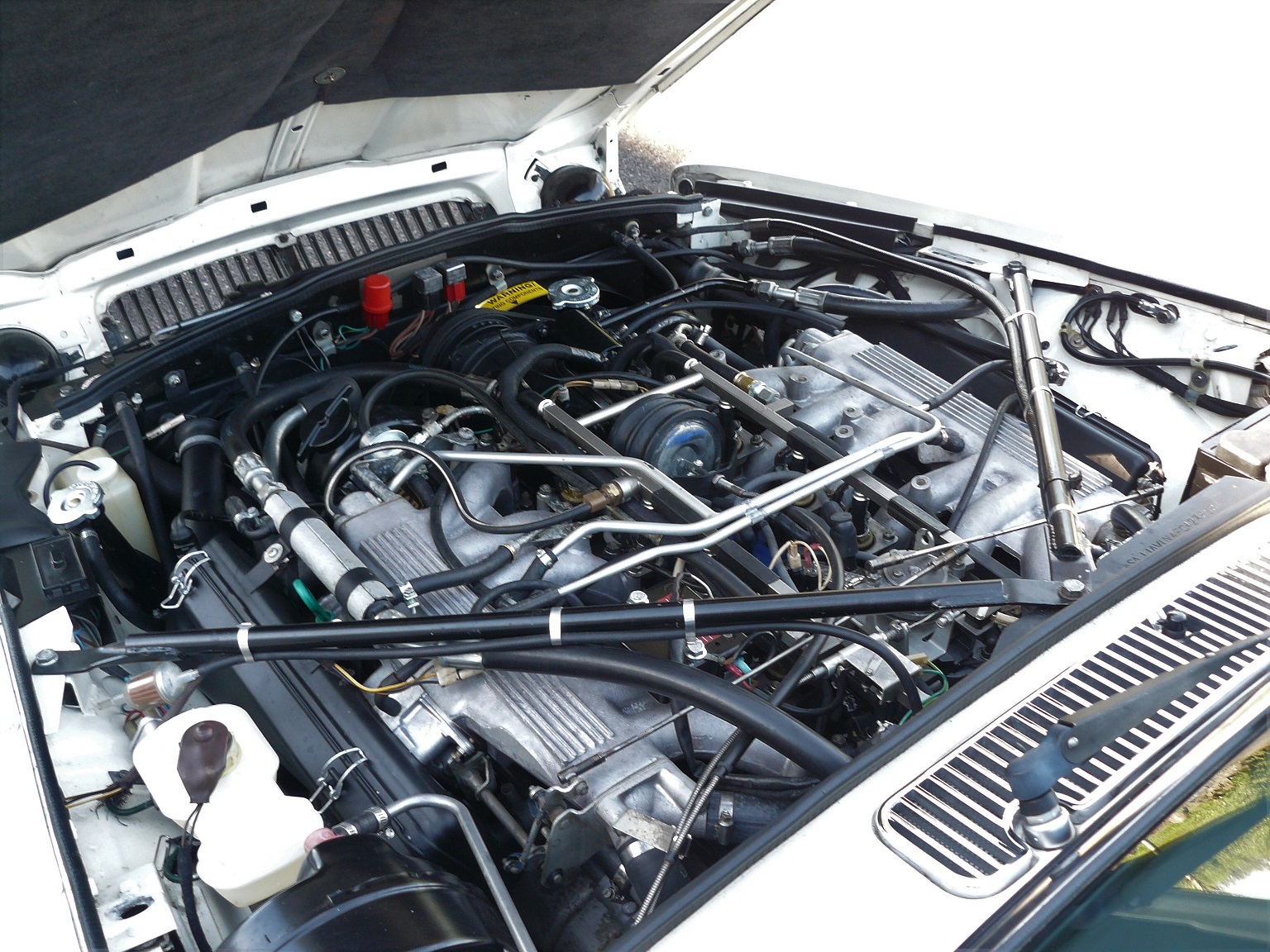

A few more, including some small upgrades...besides the 7" headlights already shown above...such as polished sill plates, XJS/late Series III steering wheel, chrome speaker rings and seat adjuster bars, rear headrests, refinished "VDP" dashboard, and the rear reading lamps.
DD
