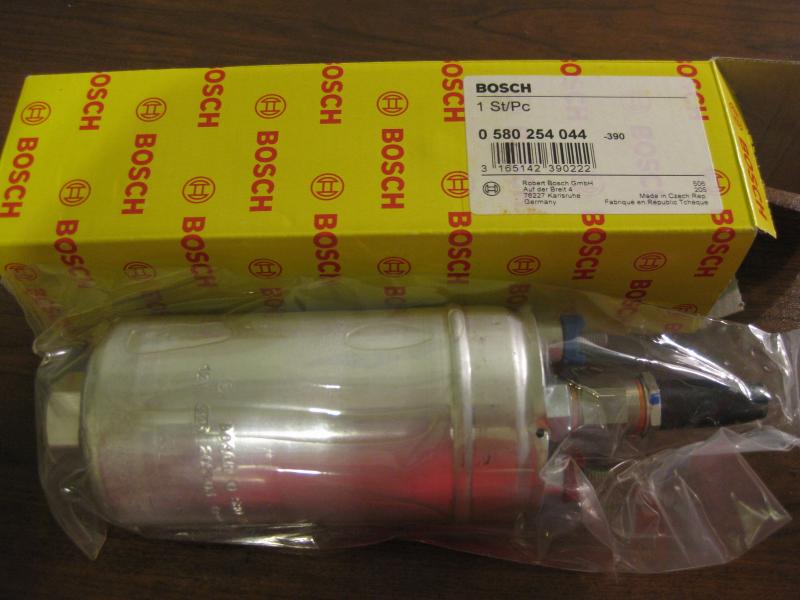

And.... my new pump came! It's the Bosch "044" pump, used by racers everywhere. It's also good for everyday use and was original equipment on many Porsche 911 cars. It's conservatively rated at 300lph free flow (which doesn't say a lot) and 200lph at 72.5psi, which is very impressive! It also comes with a one-way valve preinstalled.
