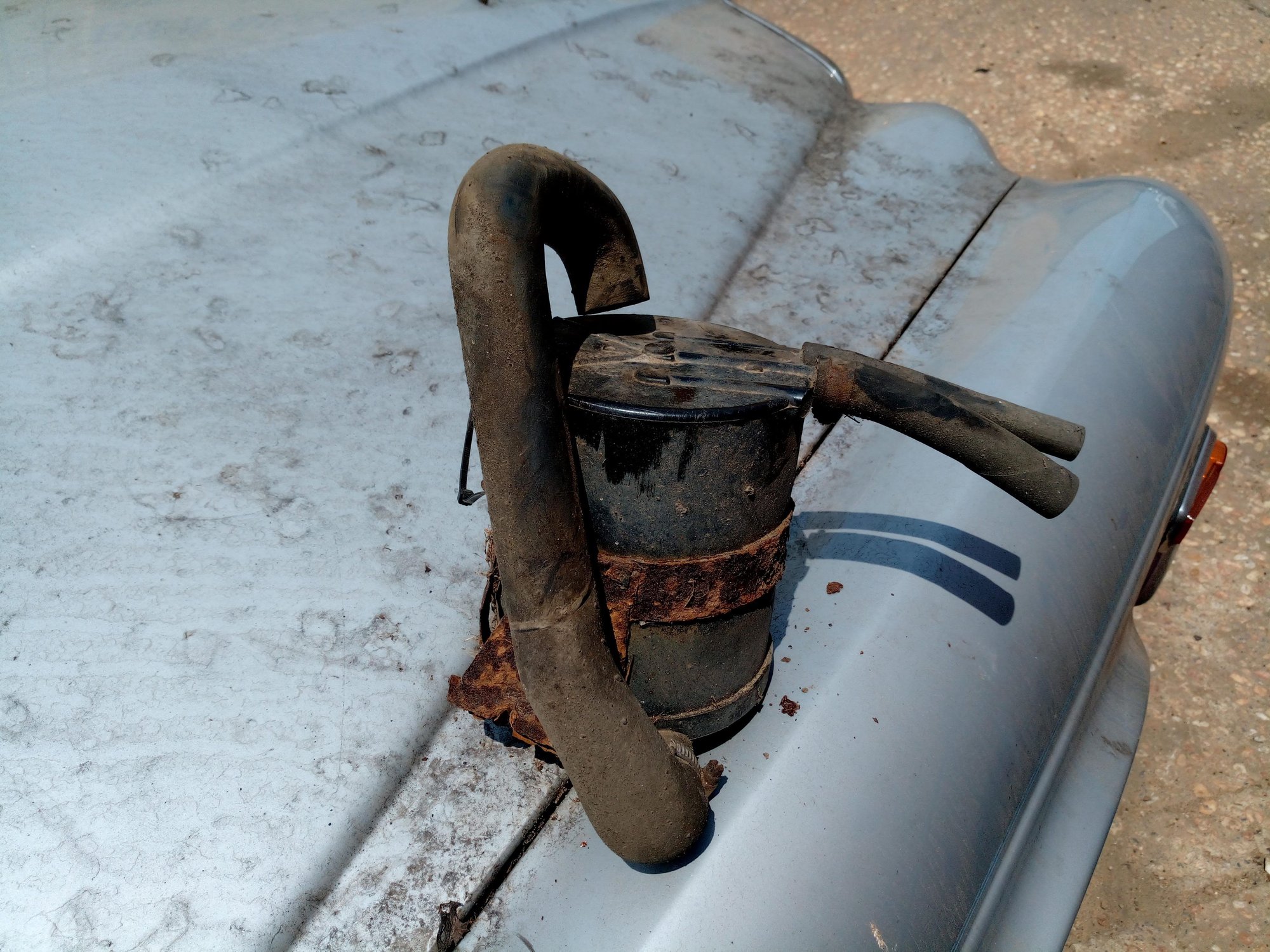

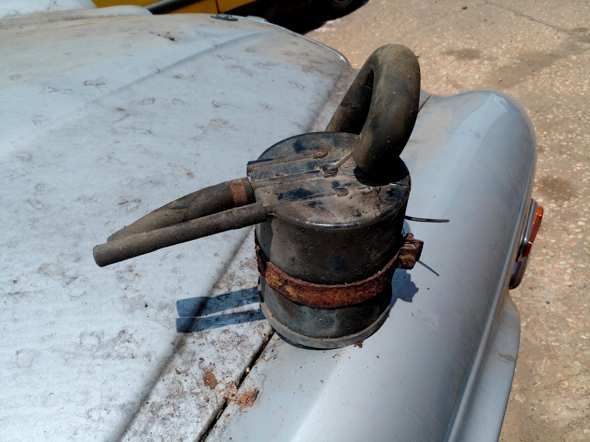

Hello,
please what is this part and what does it do on the car?
can the car run and drive without it?

Hi Mike, that's the charcoal canister, part of the fuel evaporative recovery system. It feeds fuel vapours recovered from the tanks to the intake manifold to be burned.

Car will run and drive without it
