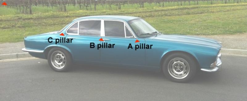

ok, you don't have to pull any parts, the plate would be affixed with rivets to the inside of the A pillar, visible through the front windscreen glass, usually on the driver's side.
if no plate there, look in the engine compartment, at the firewall/bulkhead behind the engine, or a plate affixed to the inner wheel wells on either side.
if nothing there, look for a sticker applied to the front door jambs or on the doors where the strickers are.
