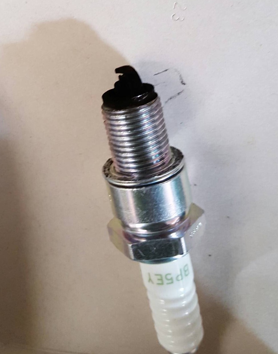

My XJ6 was doing the same thing...was running too rich (see plug). After adjusting the mixture screw no more problems.
