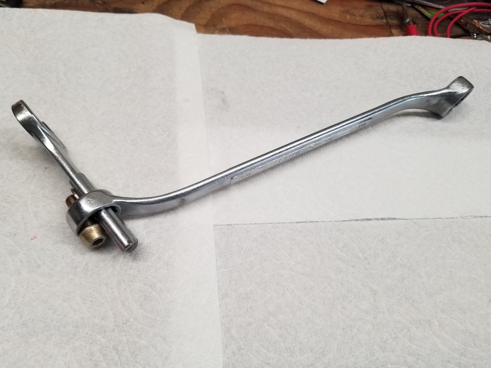

All good now with second installed sender. First URO part read full scale with engine not running, but ignition on??? Second one is spot on. Recommend you buy these parts from supplier with good reputation on returns.
Jacked up front end and blocked with wood, to around 2" under right front tire... Home made, Special Purpose 18mm (thin) shortened wrench needed to get leverage. Put a little sealant on copper washer to prevent it falling off sender as you are installing it upside down by feel.
Not too much strain on 80 year old joints. Second time, I did not remove the filter.
7/8s by 3/4th box wrench with 18" tommy bar did the trick.
