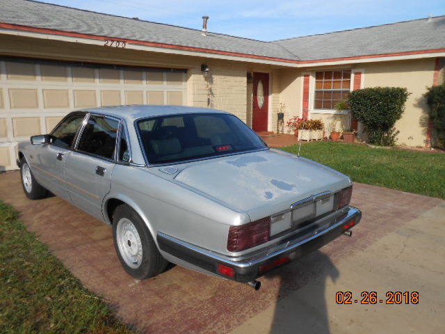

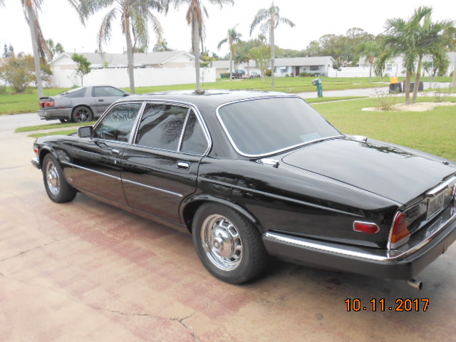

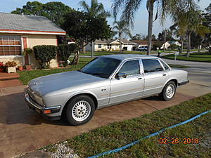

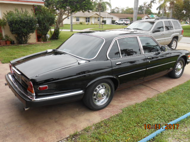

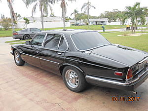

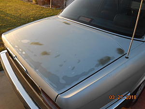

Jose: Taking your car to MAACO will be one of the biggest mistakes you will make. Do it and a year from today you will wish you had done it right the first time.
If your paint is not cracked like ALYN described and I have personally experienced, and it is only the clearcoat has deteriorated, (you have to really inspect it carefully) you may be able to do what I am doing with my recently acquired XJ40. On my series 3, I had good surface paint to start with.See pics.

I don't like hijacking a post but...........
@ Jose: It does not work like that. It would be very difficult to get the the paint to match.
The paints today are totally different from the paint from the 80's.
Here is what you do.
Cut and buff an area of your car that has no paint damage then go to the automotive paint store and have them mix a half pint of the base coat color to match the area that you cut and buff.
Have them do a spray out.
You will see what I am talking about.
You may have to respray the complete car.
Then again, I think that your car is Grosvenor Brown so you may get away with it.
Case in point:
Color matching is no easy task.
The paint code on my XJ40 is MDF and it took the paint shop 4 trys to match the silver on the car. Using the paint code MDF it came up darker than the area that I cut and buffed which was the inside of the rear door where the elements did not damage. Fortunately for me, I know the guys at the paint store well, so they kept at it until it was just right. I did not have to do this because I am repainting the complete car but the paint had to match the paint on the inside of the car. After each mix they did a spray out to see what it looked like.
On top of that, if you scrimped on the clear coat like buying the cheap brand it will have a yellowing effect over time on the paint making it darker.
3 quarts of good quality base coat = (6 quarts. mix is 2:1) is over $250.00 and a good quality clear coat is about $140+ for a gallon.
In a nutshell it is not as easy or cheap as you think.
Its been over a week (4-6 hours a day) prepping the car and it is still not ready for primer much less paint, and I am doing this on the cheap.

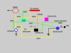

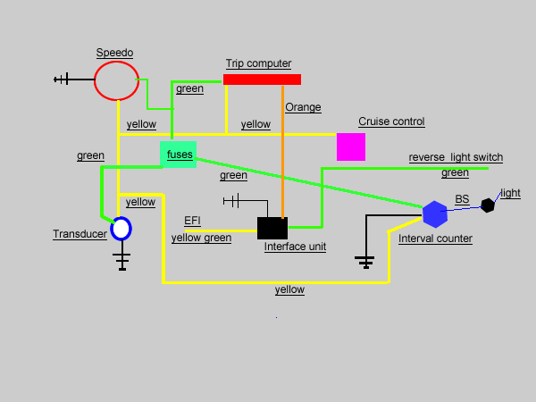

Carl,
The mods required to allow the TC to function with the V8 engine are all in the INTERFACE unit.
I sent you a wiring diagram showing what items are interconnected (yellow lines in diagram) There is quite a bit of info as to what has to be changed to make it work with a lump. Going to do mine shortly - because I like things to work properly.
Yellow - ECM to interface = raw injector value
Orange - Interface to TC = processed value to TC
