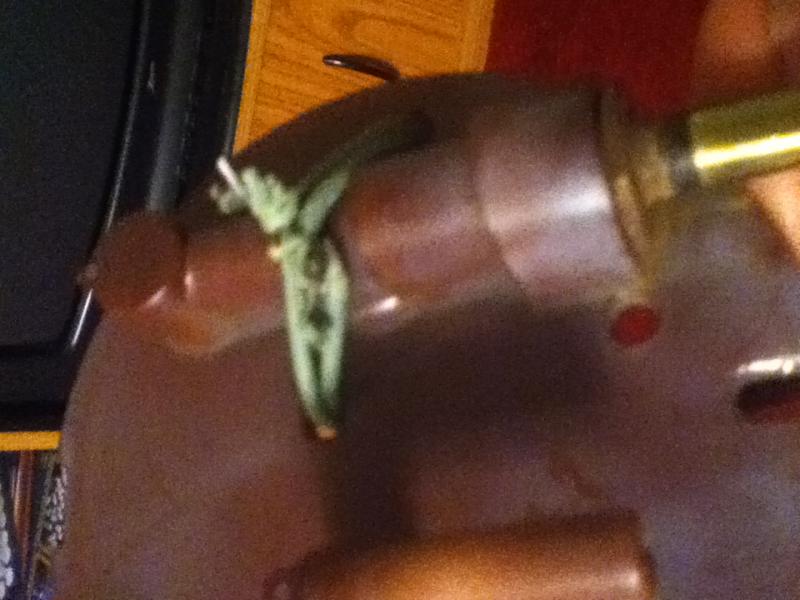

i found what the problem was!. i'd took the Tank out Again -_- it was the fuel pump Canister Lid! first time i took the tank out, i didn't paid No mind to it! But anyways, the pics below is the lid. that i fixed With Heavy Duty Insulated Wire on the non return valve. it's that silver part that broke off from it. i put everything back together and it Started Right Up and Runs great!!!
