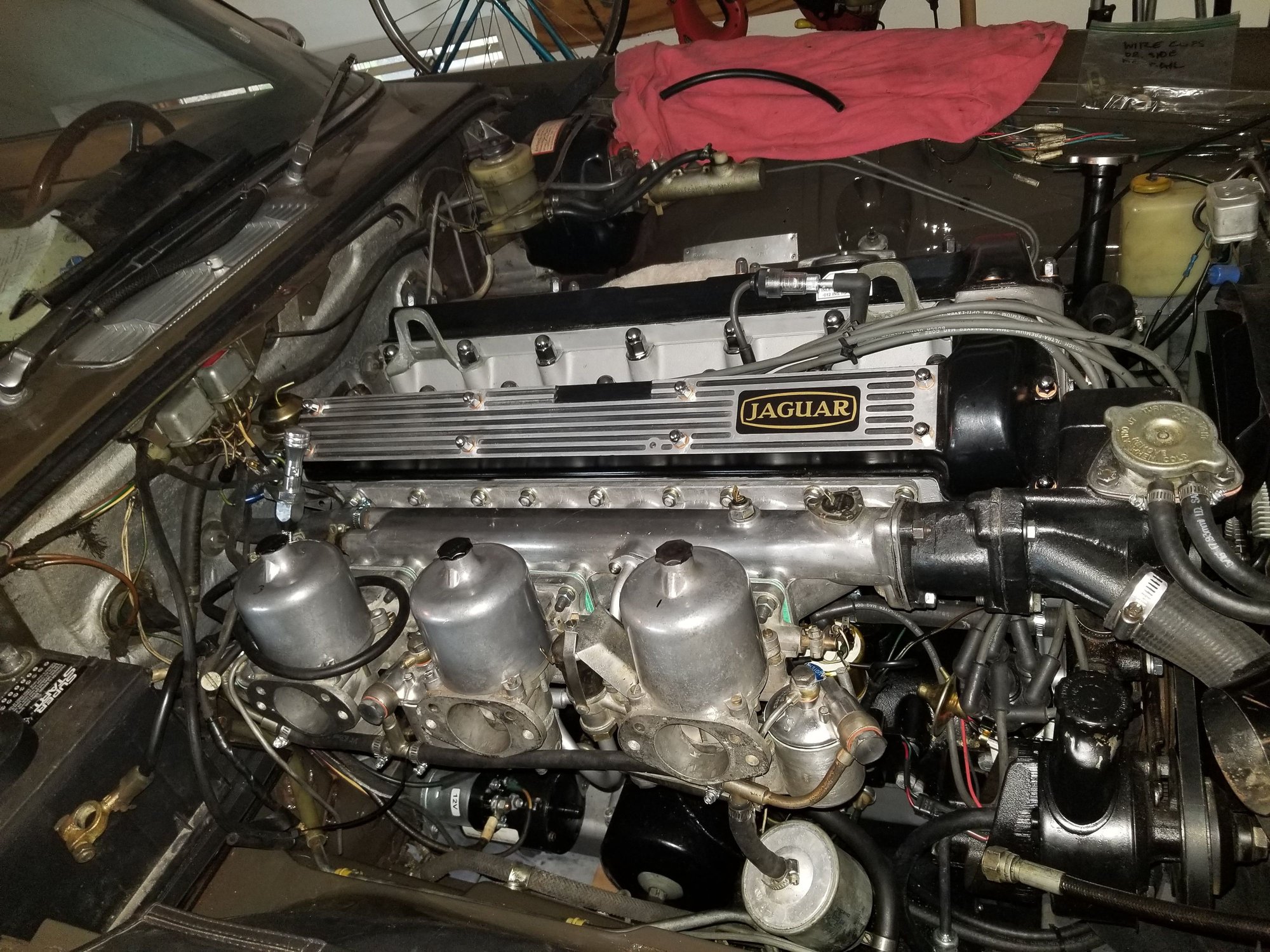

Latest pic. Had the stock exhaust manifolds ceramic coated inside and out and will not be adding the heat shield. I'll add the AC back at some point, but leaving it off for now.
New exhaust that eliminates Catalytic converter and front mufflers. Still surprisingly quiet!

Car now has the hood on and has done about 6 miles of tuning/ driving. Mixture still isn't quite right. Been tuning, then drive, come back and check plugs. Seemingly no matter what I do, front carb is rich, middle is good, rear carb is lean. I'm wondering if the fuel pump is not supplying enough fuel to keep the rear carb float bowl full? Fuel flows to the front carb first... The car runs smooth and fine until there is an uphill grade or you step on it, then you get popping through the carbs and stumble. Much less prevalent when it is warmed up fully. Starting carb shuts off way too soon on the Otter switch, so I may have to wire a switch for control.
I had issues with the header tank hitting the hood, so I removed the fill neck and cap completely, and drilled and tapped the side for the overflow and radiator drain back hoses. Is there any issue with this setup? Scared because I still cannot get a temp reading, car doesn't seem to run hot, but really would like the gauge to work. Can't seem to find the green/blue wire in the engine bay that runs the gauge.
Header tank re-work to clear the hood. Does the cap need to vent here?

You might want to get an inexpensive but name brand mechanical temperature guage and leave it under the bonnet for a while to make sure you are not overheating. Obviously you can't read it while you are driving but you can stop and lift the bonnet and make sure everything is ok.
Then when you do get the dashboard temperature guage working you can see if it is reading close to what the mechanical one was reading.

What needels do you have in the SU's? UM's?

I believe they are UM. Car is up on my lift, will have to get it down and check. I'm hearing that the richer UO needle is probably what I need.

Update: I changed the carb needles to UO from UM, and that fixed the mixture issue! The car runs great at every speed and throttle position now. More power too. Lots more. The trans is shifting too early at WOT, so I may have to change the governor weights in the trans.
All I can say is that the performance is WAAAY improved over the old motor/ trans combo. 9 to 1 compression, big valve head, triple SU's, better exhaust and better gearing all made a huge difference.
