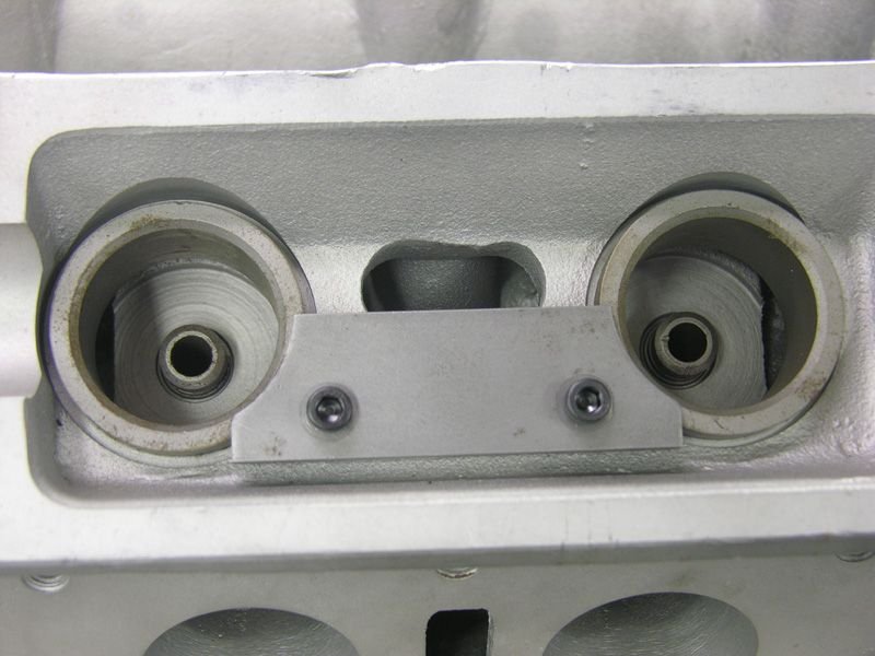

Despite what others say, forget about the "stakedown kit" Its a $100 set of plates to hold the tappet guides down. Needed on late engines that ran lean and hot due all the crap in the engine bay. Not invented when I had my E type, and used to drive that hard. Never any trouble with the tappet guides.

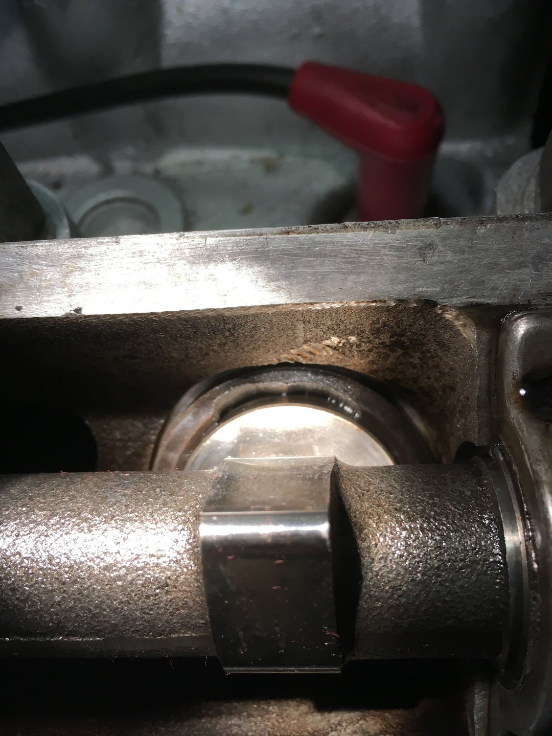

I agree you don't need as takedown kit if your tappet guides are installed with a proper tight interference fit.
I had my top end rebuilt after the damage you can see in this pic (if I attach it properly), caused by the guides drifting up and being hit by the camshaft lobes. Now rebuilt so no need for a stake down kit. I hope.

And here is a stock pic of a shakedown kit:
