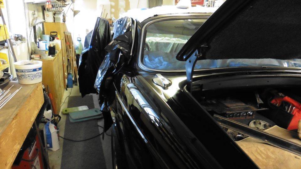

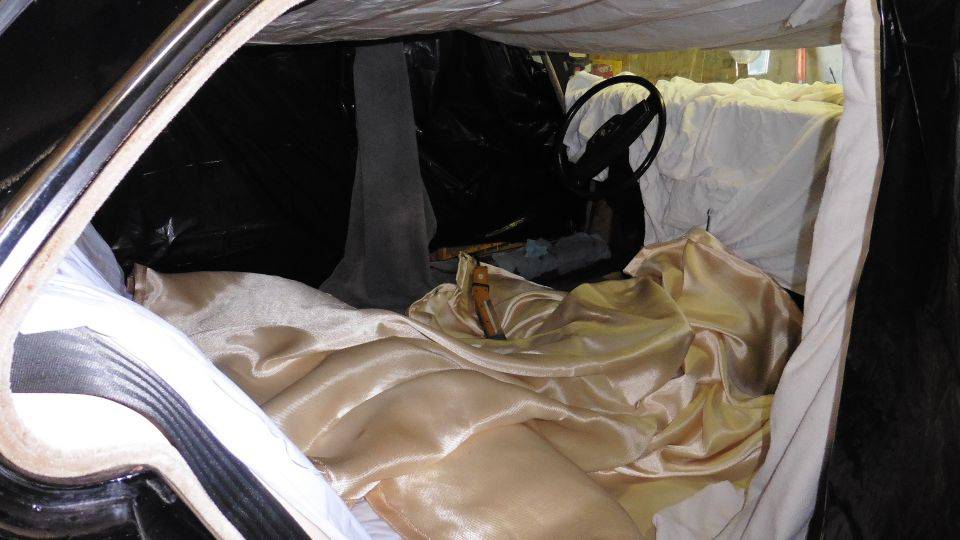

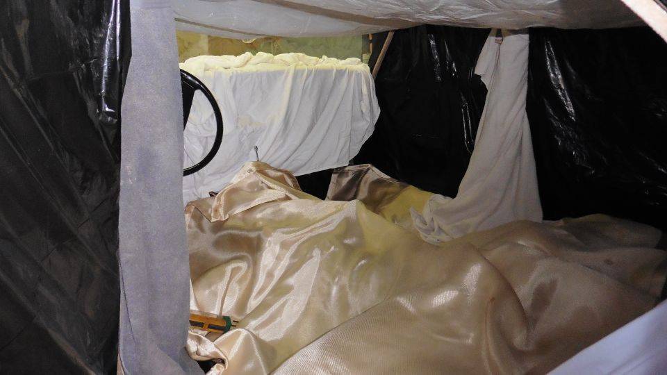

The wind stopped blowing through the garage today so I could actually work out there without catching frost bite.
Following advice in here, I first covered *Everything* on the inside of the car against sparks; including the headliner, door cards, B-pillars and under the dash. Getting it right took a bit of time.
To protect the headliner I suspended a cloth, slitting it and wrapping it onto the roof. It's held there by magnetic parts dishes which stick to the steel roof and hold the cover better than I expected.
Under the dash was the most difficult part because there's nothing to hang anything on as I took the underskuttle down earlier. But with the judicious use of clothes pins and tape I got it to stay. Hopefully it will stay put till I'm finished.
All the inner doors and pillars are protected. I've even covered the outside of the doors to keep from grinding steel dust into the clear coat; basically laying a drape over and securing it fore and aft. Nix is Shrouded until further notice.

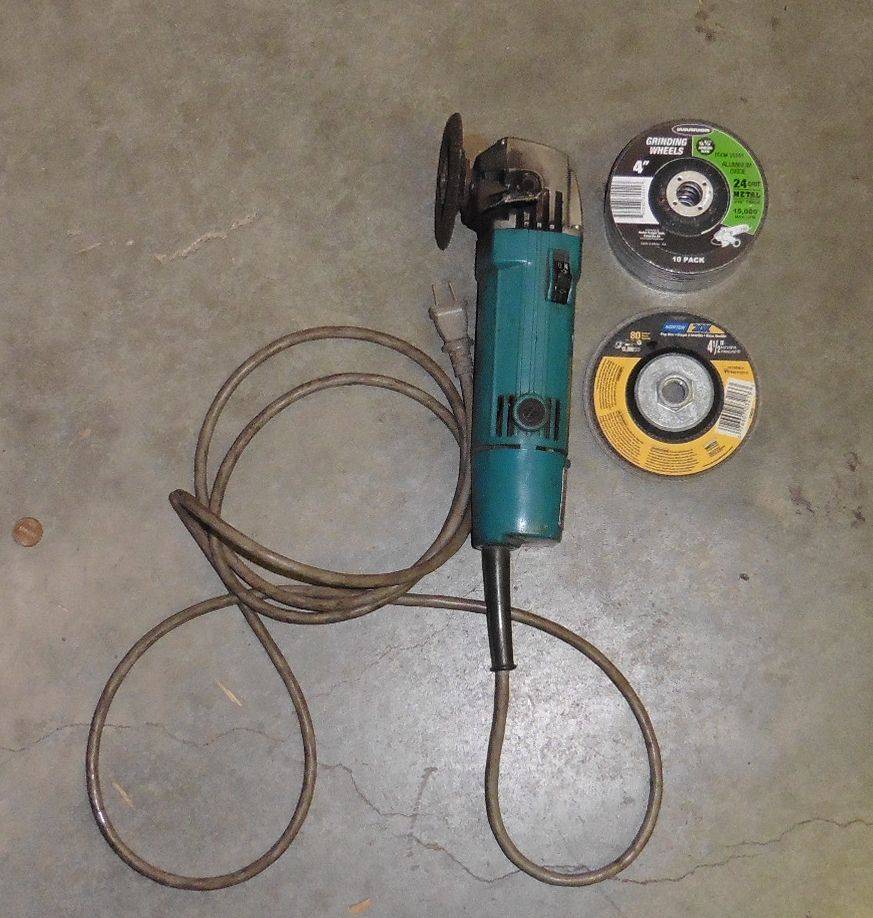

Then I got husband's Makita angle grinder which I've never used before because he's been a bit possessive up to now. But I took it to town with me Monday and picked up more discs for it so now he says it's mine. It could become my favorite tool next to my chain saw.
I've got all the lumps ground off and it looks heaps better! Next I'll tackle the sill with the flappy disc but that fits a different grinder which is heavy, awkward, noisy, ugly and rude. He tried to give me that one too but I don't want it.
The Pictures: The first 5 show the outside of the car covered; the next 4 show the inside protected. Then the Makita, and the last 2 are before and after where I ground off the remains of the lacy old floor pan today.

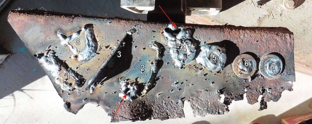

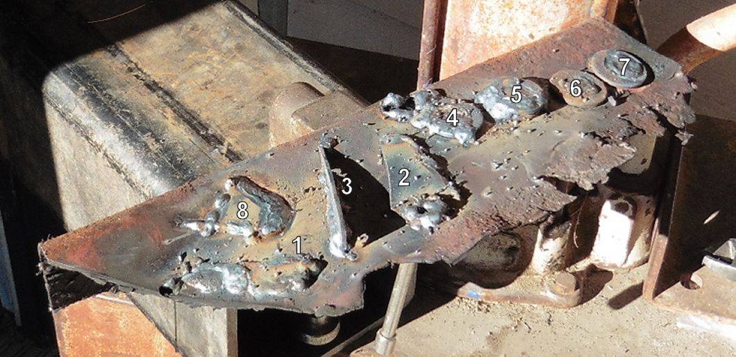

Today seemed like a good time to start learning to use husband's MIG welder which he calls his Hot Melt Glue Gun.
He had some scraps already cut up for other things and a shard of the original floor for me to practice sticking things together.
He showed me roughly how to proceed and left me on my own. Below are pictures of the results. There are two reasons I'm posting this mess, one is so all you experienced guys can have a good belly laugh, and so that Anyone seeing it can be Supremely confident that they can do better than this!
1 and 2 were abysmal. The Iron Bird definitely flew over and dumped a load on the way by. I blew a hole (red arrow), tried to fix it and only made it worse. 3 worked a little better until I started second guessing myself and blew holes in the upright as seen by the shadows.
Then he brought me some washers and said to stick them down and then fill the holes. 4 was a complete disaster. The red arrow indicates a Huge hole that I tried to fill and only made it bigger. So I moved on to the next washer.
At 6 I was beginning to get the hang of it, stopped going around the outer edge and only fill the center. By the time I got to 7 I was pleased with my progress and thought I would try one more flat piece just to see it wasn't a fluke. The 2 left sides on 8 were done first, the 2 right sides last. Husband took a look and said, "OK, you're now the welder in the family." (An incredibly frightening thought!!)
I'm in no way ready to try this on something as important as Nix's floor but a couple more days' practice and I'll be confident enough to try. If it's terrible I'll cover it with carpet and it'll never again see the light of day.

Elinor:
looking pretty durn good. It helps to have a great tutor and great equipment. You clearly have both as well as being a quick study.
Welds 1-8 show clear progress. Look at the backside. that is where you will see if you have good penetration as opposed to merely deposits "bird poop".
If you have oxy/acetylene or even a Mapgas torch, application of flame to the red rust buns it off and allows better MIG. MIG is really sophisticated stick welding.
All welding is differentiated by the method of shieldng the arc/flame from oxidation.
This unexpert says you are almost ready to hit the car.
Carl

The holes were Definitely good penetration! The blobs lying on top, not so much. The flat fillets show on the bottom where they got hot but didn't blow through.
I'll get more practice tomorrow on thicker stock as anjum suggests. I really don't have the confidence at this point to try it on my car.

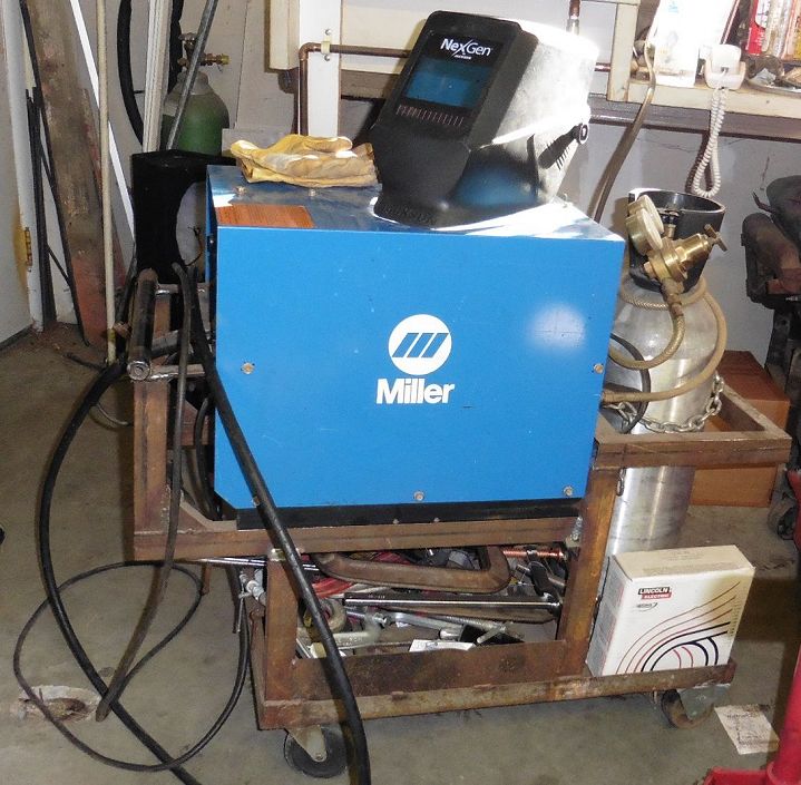

It also looks like you are using a very good Pro Mig Welder, 'Miller' is a very respected make.

No.7 looks good for a plug weld
No.3 looks very impressive for welding that plate at an angle but you need to keep the shroud in nice and close.
No.8 looks promising but you are maybe moving the torch a bit too quickly, which can make the weld look a bit stringy.
The Thicker one on No.8 shows you are getting there!

Thank you, OB,
When husband buys tools, especially major ones like this, he buys the best he can afford for the intended purpose.
At the time he bought this welder, the manufacturer was having a special connected with a class at the local distributor. He took the class just to take advantage of the special as he had been lusting after one of these for some time. The first thing he made was that cart. It's made of bed rail, some of the highest quality steel available.
As I mentioned to anjum, the center of that steel was buffed with a wire wheel until it was so shiny I could almost see myself in it. The edges are a bit rough, but I wasn't trying to weld anything out there. (What looks like rust in the center is some sort of smoke I guess.) I've ground and polished all surfaces in the car that will have any welding.
I need to stop being afraid I'm going to touch the metal with the tip. I'm sure you're right, that's why there are so many splatters, the gas can't shield the spark. The best of those welds were where I found something to rest my hands.
I had no idea one moved from right to left with the torch tilted to the right! Now I think about it though, it makes perfect sense!
I'm sure it's just a matter of more practice until I gain confidence. I had to kill several other snakes for the past 2 days so I haven't got any practice in but hopefully Monday afternoon will be a good day.
Thank you for the comments, the encouragement and the hints. I'll be pressing on.

OK, we have a lack of communication in terms, probably because of my ignorance of the proper names.
I'm not talking about the part the wire comes out of, but the bigger part on the OUTSIDE of it all (shroud?). THAT'S what I'm concerned about touching to the metal.
In fact, while I'm thinking about it, if I'm moving from right to left, with the 'torch' tilted to the right, I'll Certainly be pushing it through molten metal! That also concerns me.
Anyway, it doesn't stick out beyond the shroud at all so that's not my problem. I'm still afraid of wrecking one of husband's favorite toys (although he's not worried at all -- Yet). I'll get over it soon I'm sure.
He has a couple of the nod helmets but when the price got down where he could justify it he had to have one of the auto-darkening units -- just because (a guy thing I'm sure). After using this I can't imagine using one of those heavy monsters they used on the farm!
I'm hoping tomorrow afternoon will be warm enough to open the garage and try again.
Thank you, OB, for the advice encouragement.
That's the idea!
Welding into the molten puddle, as you move the Torch from Right to Left is the way to do it.
That way you are able to keep the molten bead of metal flowing, with the head of the Torch slightly tilted over to the right.
All sorts of factors determine the angle of Tilt: Voltage/Wire Speed/Thickness of Metal/Penetration etc.
But it doesn't need to be much, just enough to get that river of molten metal flowing as you move the Torch from Right to Left.
That is why you need to look at the molten puddle of weld, (with a Welding Mask on of Course) as you put down a bead of Weld and make some slight adjustments 'on the hoof'
Moving the Torch from Right to Left, seems such an unatural thing to do, especially if you have done any Stick Welding, where more often than not you are moving from Left to Right.
But with MIG you move the Torch from Right to Left, with the Head of the Torch 'slighty tilted to the right'
The idea being that the Wire is melting itself into a pool of already melted metal.
I will qualify that by saying that you 'can' move the Torch from Left to Right but I would take a 'rain check' on that, until you get more experience and as such get to know what you are doing.
As Right to Left is the 'preferred technique' at least while you are learning.
