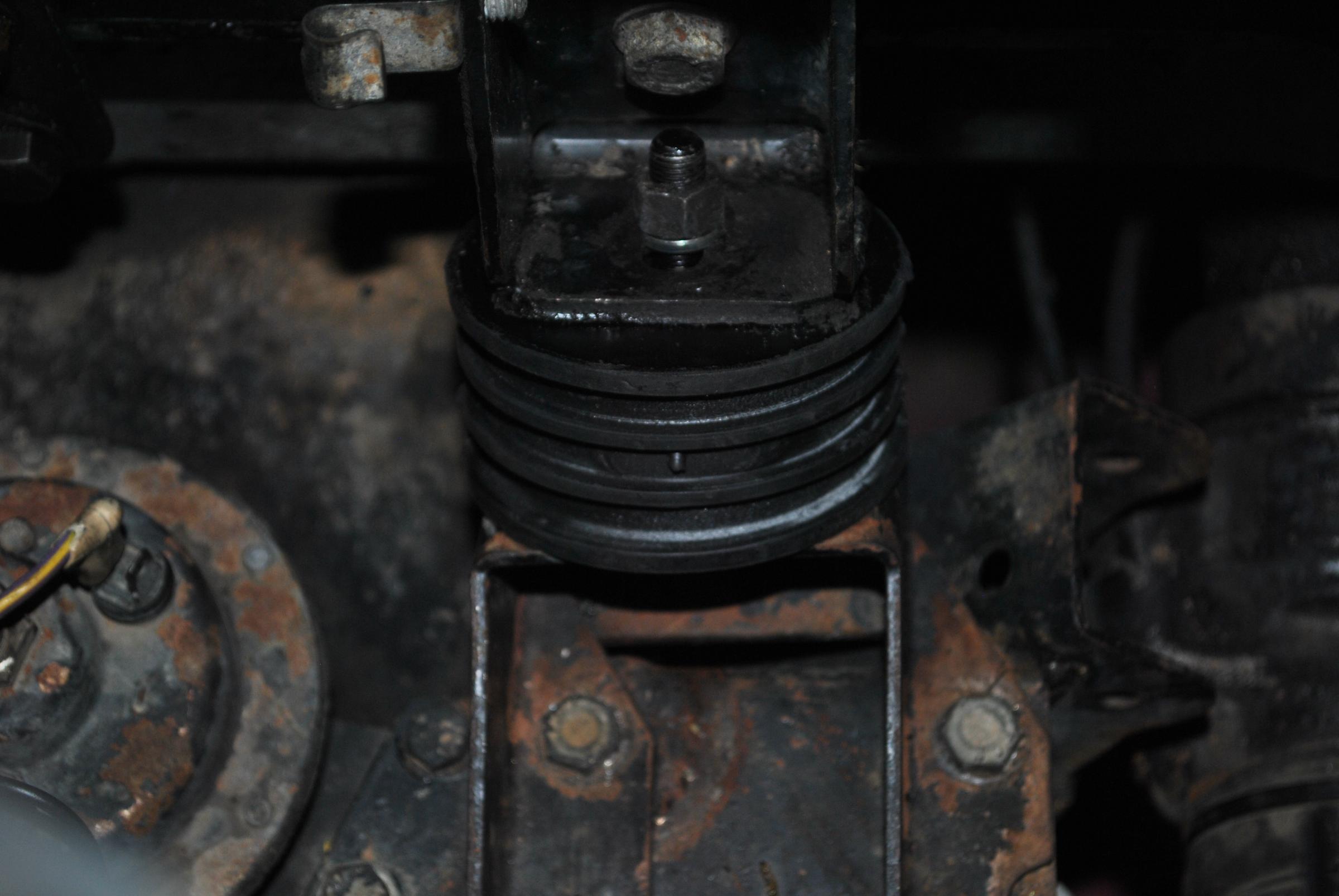

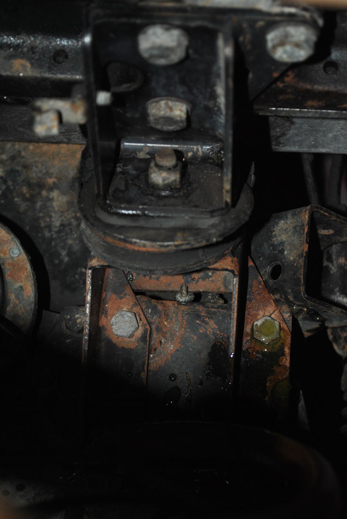

Fitted the new engine mounts today, two layers of the rubber were missing on each side. Engine is sitting about 20mm above subframe now, idle is almost smooth. Drives much nicer(I thought it was nice before), and the slight shudder has gone when moving from a stand still. Oh,and quieter.

The XK engine sump "hollow section" should clean the top face of the subframe by about 20-25mm.

Grant, I have about a thumb space between subframe and sump,so about 20mm at a guess. Makes a world of difference.

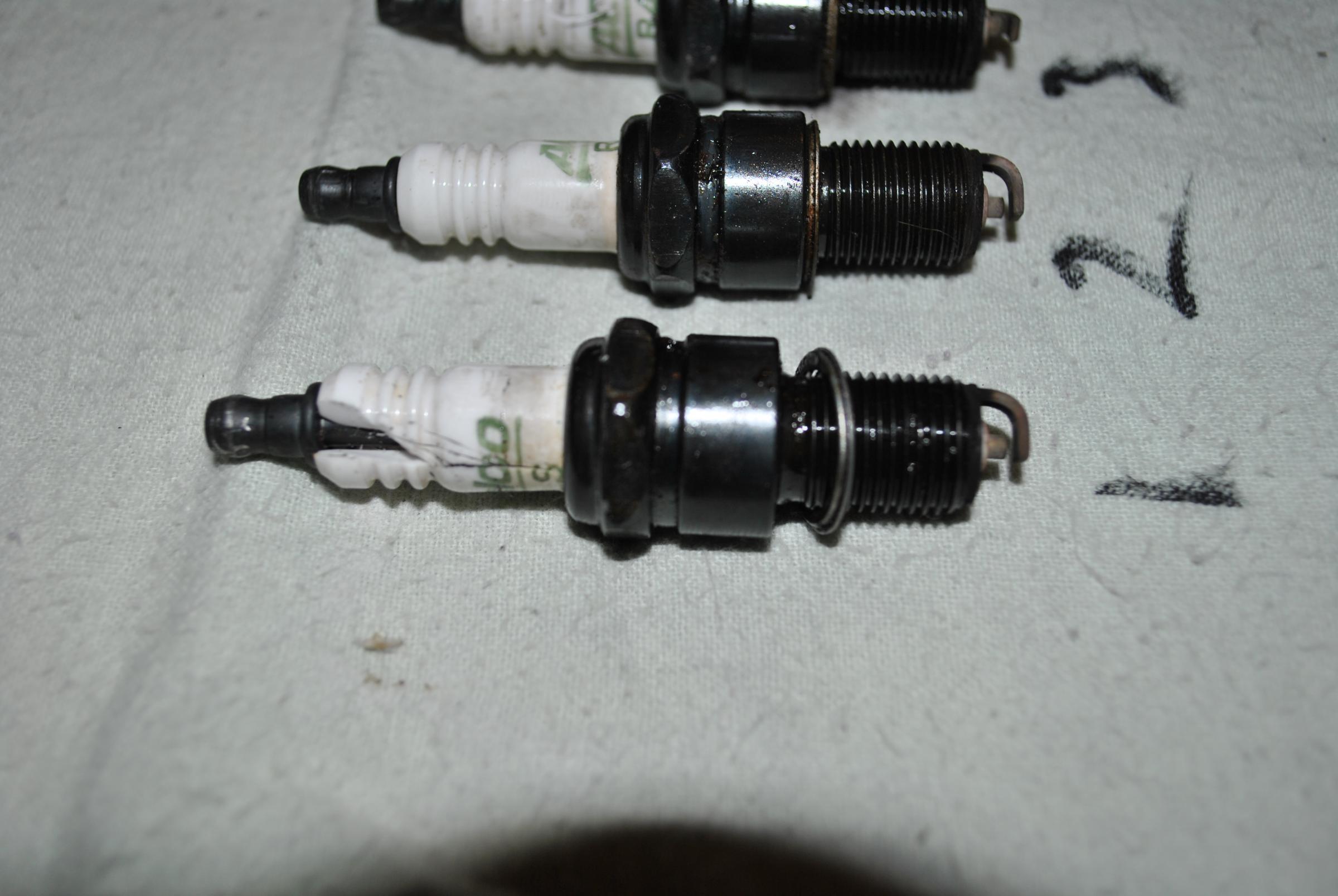

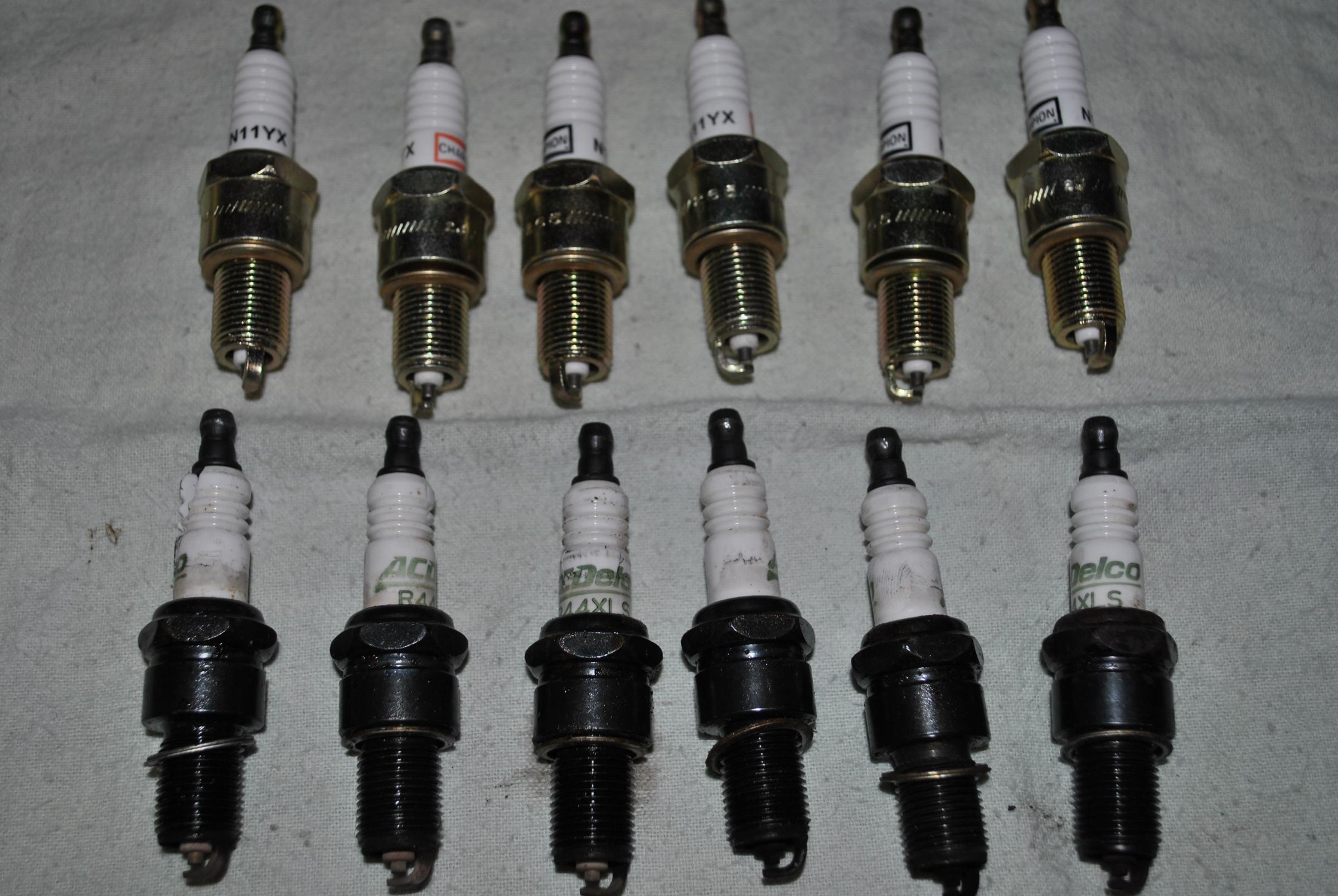

Only problem is when I removed the (new) spark plugs when I got back the rear 3 were carbon black again like the picture of the old ones further back in the thread. This is telling me the rear carby is too rich,correct me if I am wrong.
It just doesn't add up as engine is running smooth,does not seem too rich or too lean, could there be something else wrong here.

I agree that the rear carby is a tad rich, and it dont take much.
The adjuster from underneath is the older H series carbies, as in the old Morris Mini, 1100 etc. Not aware of the H series being used on an XJ series Jag, maybe the real early models??.
The HD series still has the adjuster at the side with an air bleed screw for the idle speed.
Make sure the choke is not holding ON a tad. Make sure that the jet is properly in the UP position.
Failing that, I reckon a combination of jet/needle wear is the culprit.
I would go for a reset of the mixtures again, coz if the front is a tad lean, the rear can be set a tad rich to compensate in the big scheme, and the sooty plugs adjacent to the richer carb will tell the tale.
