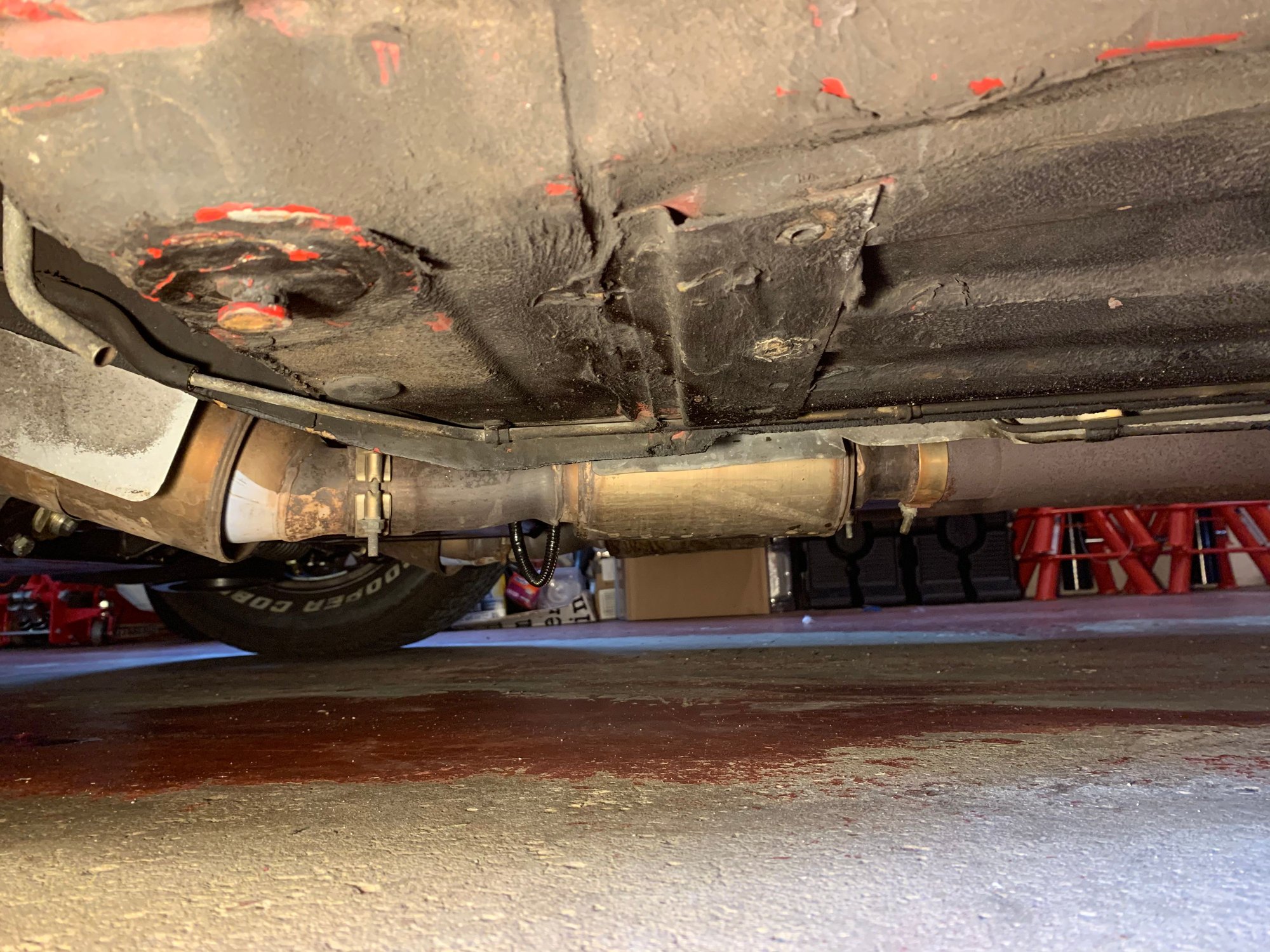

Ok, so working on this car been a bit of slog lately. The process of replacing the radiator hoses led to a problem with the distributor which led to a problem with the injector harness.
But finally got it all sorted and decided to take the car for a drive.

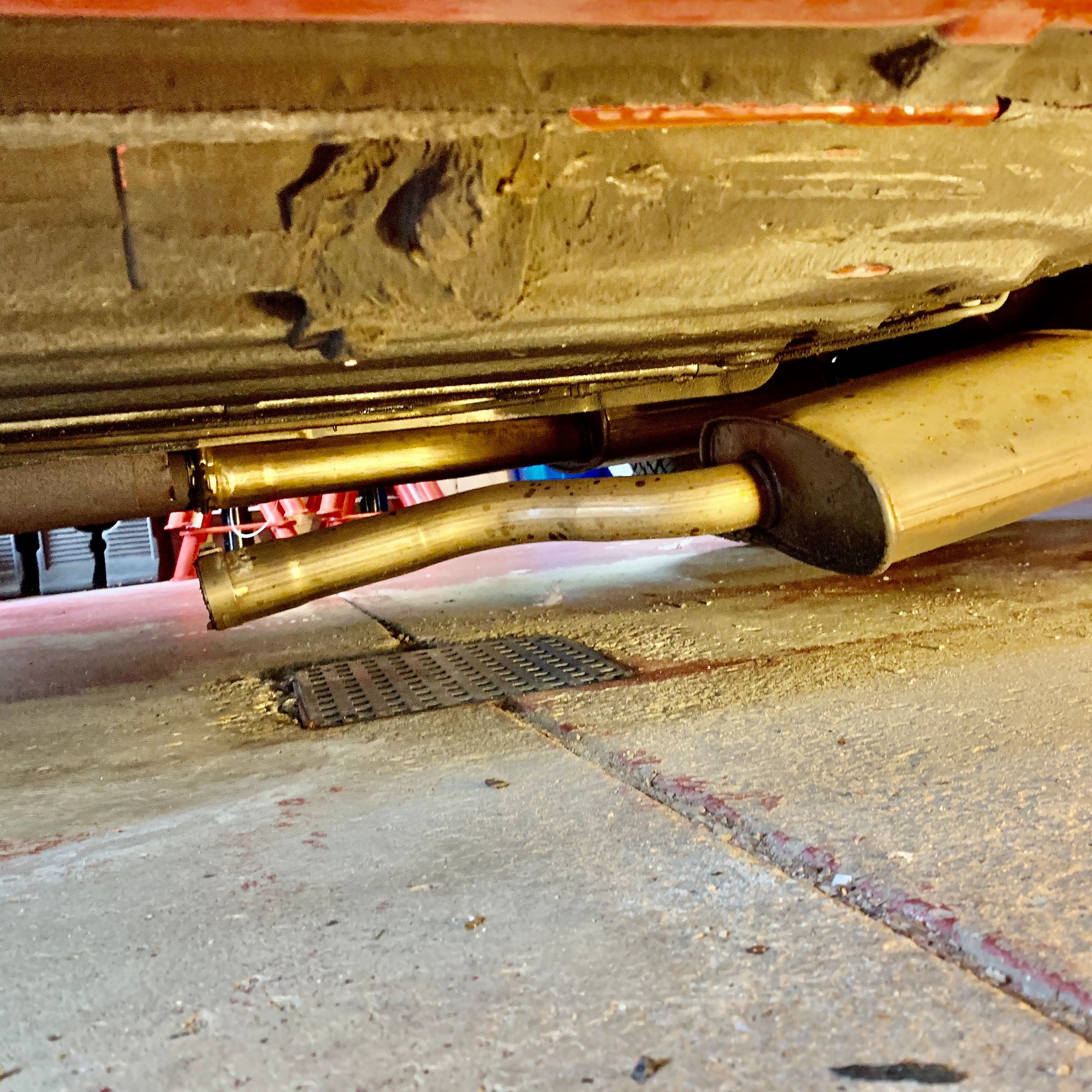

Getting on the highway, I hit a small bump which immediately resulted in a distinctly “throaty roar” when I mashed down the accelerator. Quickly exited and returned home driving cautiously the whole way.
The root cause wasn’t too hard to determine...
I think I see the problem!
I had been contemplating removing at some future date the forward silencer using a kit from Simply Performance. But the way it sounded with the second silencer hanging down was not at all pleasant, especially with the top down.
The forward silencer in question
I would eventually like to remove or gut the cats, but not ready to tackle that at this time.
Does anyone have experience modifying the exhaust on a convertible to advise how it sounds? Any recommendations?

Clarification
Sorry, what I thought was the forward silencer is actually the intermediate catalyst.
So can I eliminate half of the cat restriction by simply getting a longer intermediate pipe?
Still curious if anyone has experience eliminating the first silencer and how it sounds.
Thanks
Just something that caught my eye in this. That covered wire hanging down I think is the rear CPS cable... It can and will come into contact with the very hot area just after the down pipe, melt the insulation and short... The slack can be pulled up from the top and zipped to the cross pipe, and below the cable/wire and covering can then be zip tied away from the pipe to a small hole, I'm guessing designed for this purpose, in the area of the inspection cover at the bottom of the bell housing.
Reply 2
Sep 13, 2020 | 10:53 PM
Well spotted that will snag or hit something hot and lights out for the engine!
