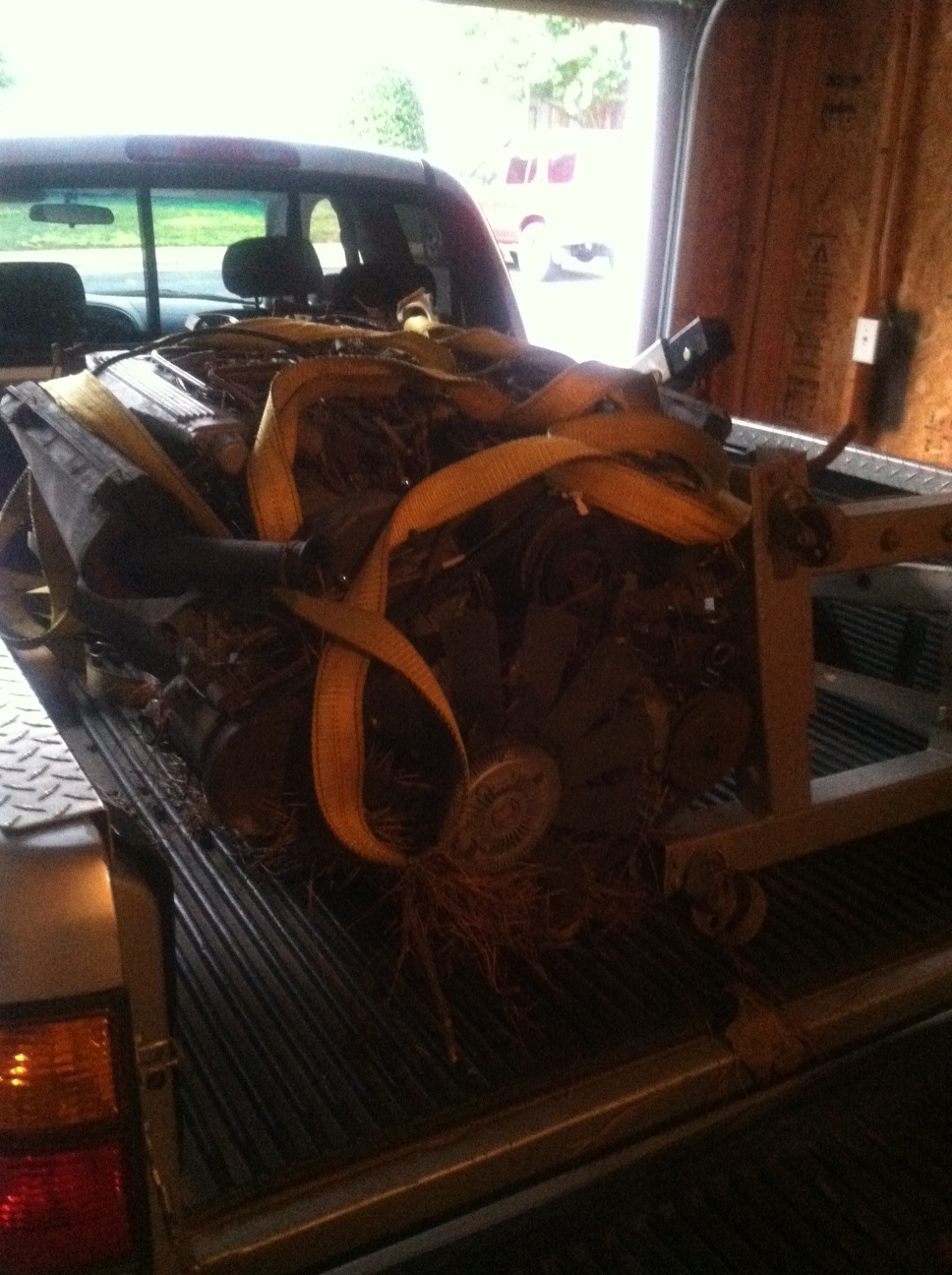

So I bought myself a V12 engine out of some 1976 Jag. They guy had it laying around and finally decided to sell it. He said it was in running condition 3 years ago when he took it out of his car. So I bought it and brought it to my garage and started to take it apart. Here are some pictures, sorry the bad quality I was using a phone with bad lighting.
The day I got it:

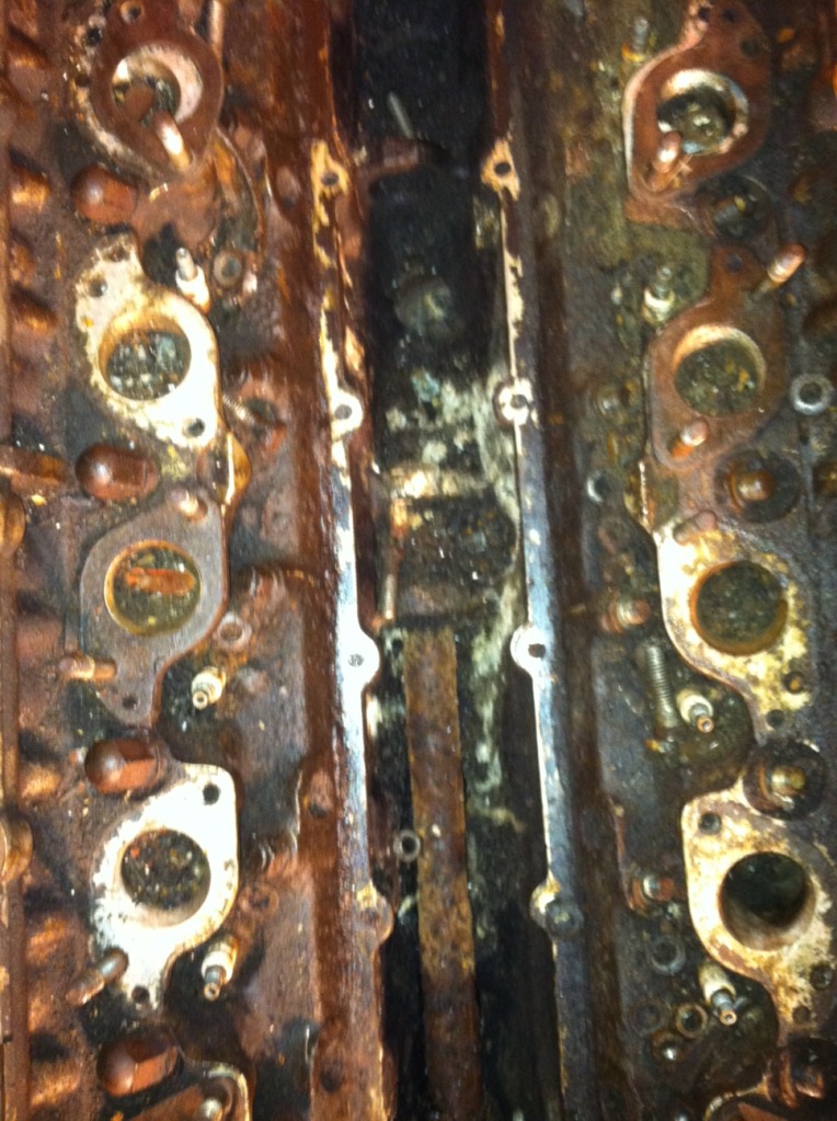

After taking out all the wires and the intake manifolds and pin needles and an ants nest this is what it looked like.

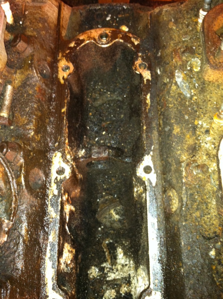

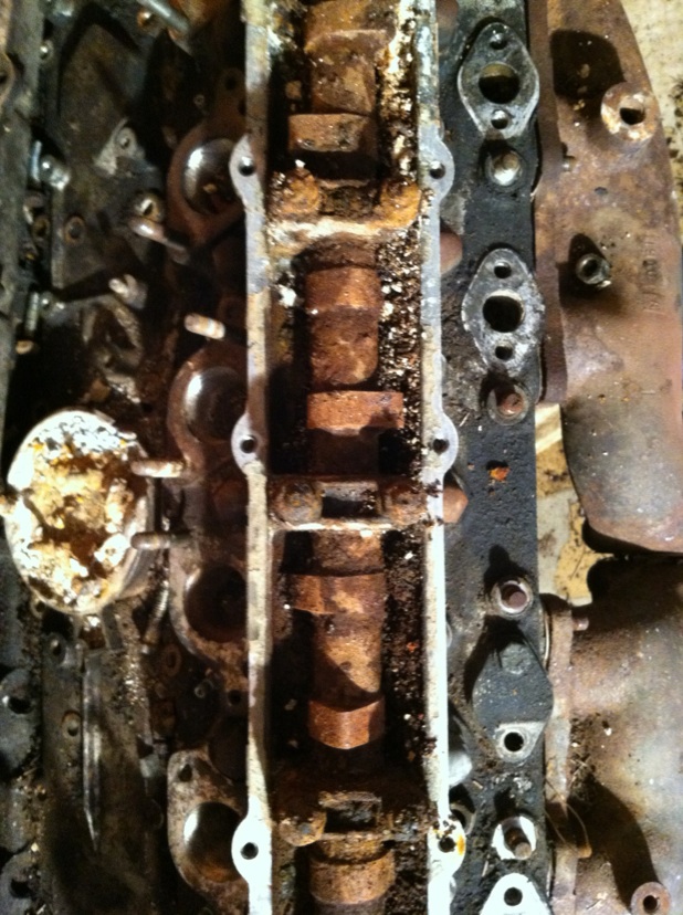

Then couple of days later I took off the cam covers and this is what I saw.

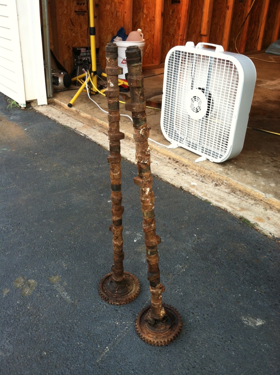

After several more hours of trying to get other parts off this is what I saw and how its sitting now.

So next im trying to take the heads off but they wont budge..any ideas of what I should do? I think I took all of the bolts off. I also cant get the bolts off under the exhaust manifolds because of the rust. What are your guys thoughts on my project?

Sorry to say this, but that engine is toast. You'll spend more time attempting to salvage parts than is viable - much easier to buy another engine that runs.
I've seen some grotty engines in my time but that's another level, and sad to see.

What happened to this motor? I can bet you comrade that it was submerged for a couple of years.
BTW, heads are super hard to pull even on a perfect motor, so even the coffee table idea is not an easy one.

The head and block castings are most likely corroded internally beyond all use. If that is the case sell the block and heads to a metals recycler for their aluminum value. The rest of the parts go in the trash.

Considering you aren't going to be able to salvage it and only want to keep it as a potential coffee table, you might try this: Block off all the coolant ports and fill it with CRX or some type of calcium/rust dissolver. Let it sit for several days, then try pulling it apart. It should remove/dissolve most of the corrosion on the head studs and you may be able to pull the heads off.

i agree. this motor is corroded beyond all repair. the fact that its a V12 has nothing to do with the problems youre looking at as far as a rebuild is concerned.
cams, cam journels, valve seats, everything is totally ruined.
