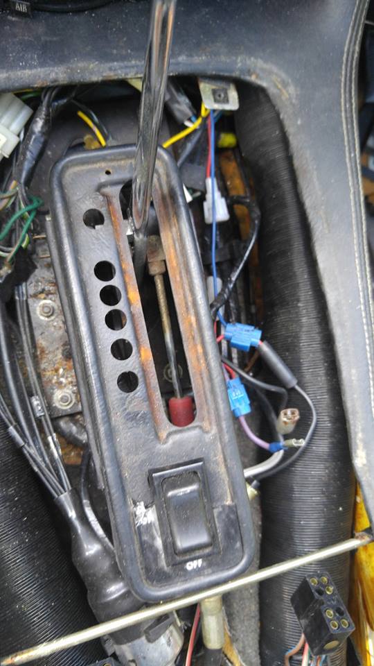

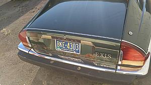

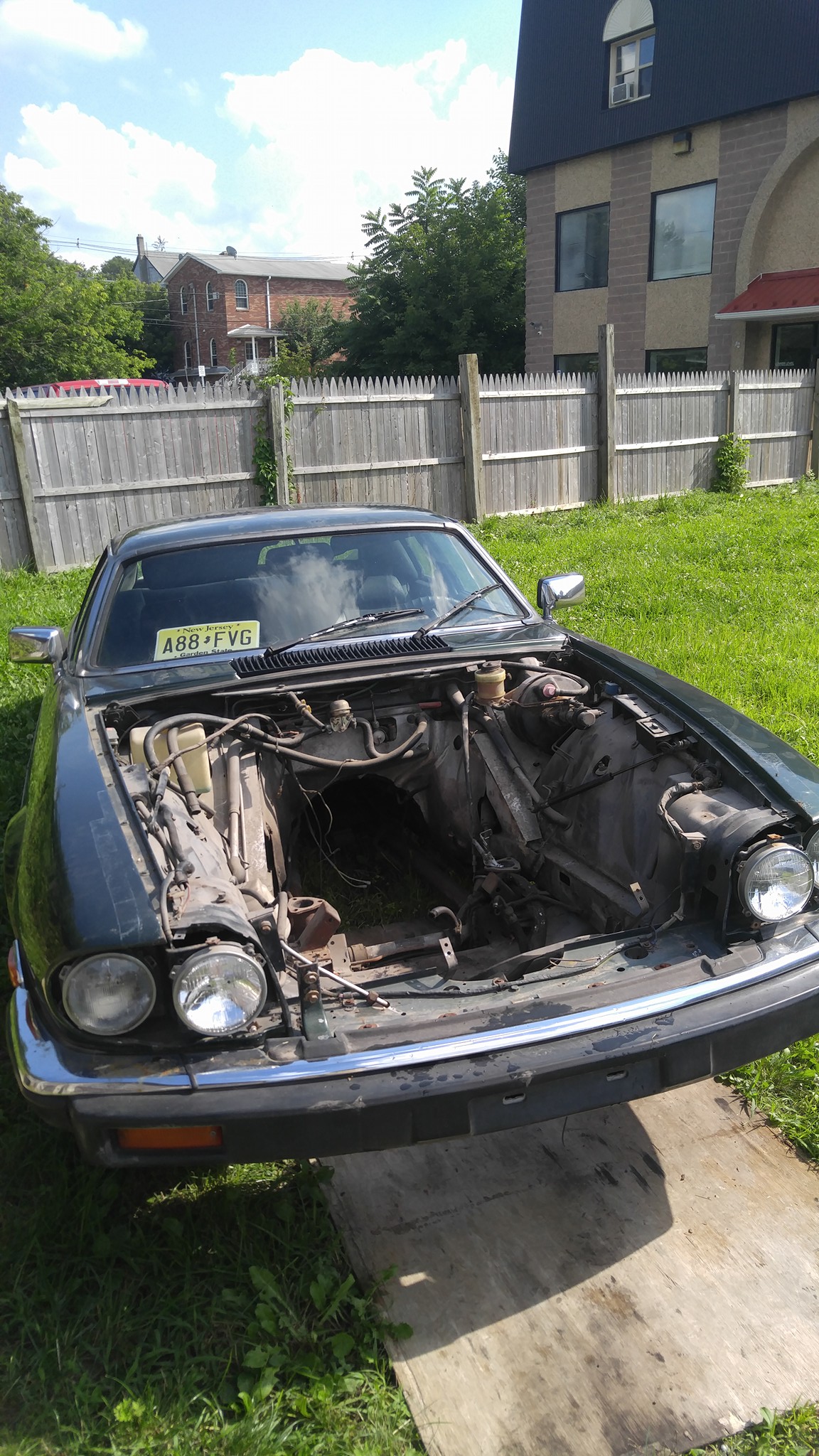

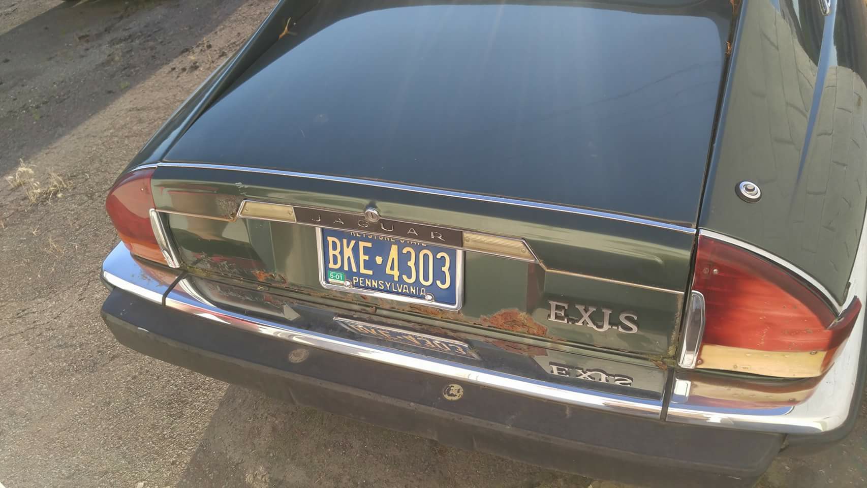

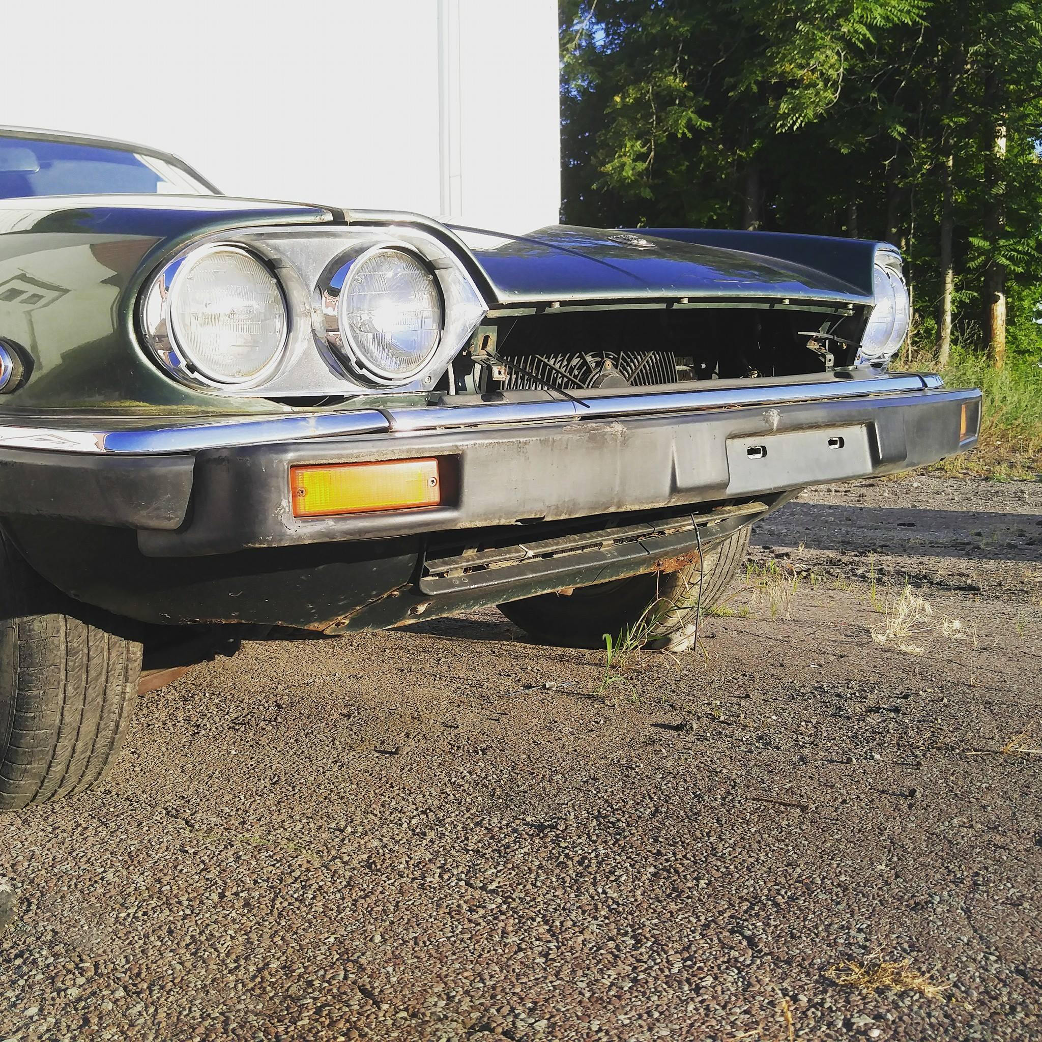

Hey all. I made an account with the facebook button but didn't like my name being my username. So here i am again!

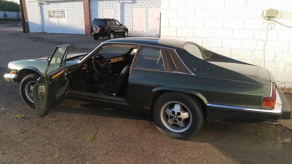

I recently bought a 1983 XJS for $250. It has minor rust issues and i can see grass through the rear seat floor, and the engine and trans are completely gone. But thats fine! Because i didnt want them anyway.
My goal is going to be long and hard to achieve. I'm trying to cram a 5.9 cummins into it along with a manual conversion not using OEM jaguar parts.
Anyway, here's some pictures to start. I'm still debating on which cummins i want (theres a 1st gen near me but i have a friend who can help me out getting a p pumped engine). Gotta aquire the trans and driveline parts too. Gonna keep the exterior mostly stock but i might throw a big *** wing on it for fun
Only progress so far -
-got AAA to tow it to my house lolol
-started removing ski slope and dash board
-removed washer and coolant bottle along with radiator/condenser/AC lines
Might be picking up the engine next paycheck.

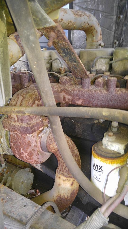

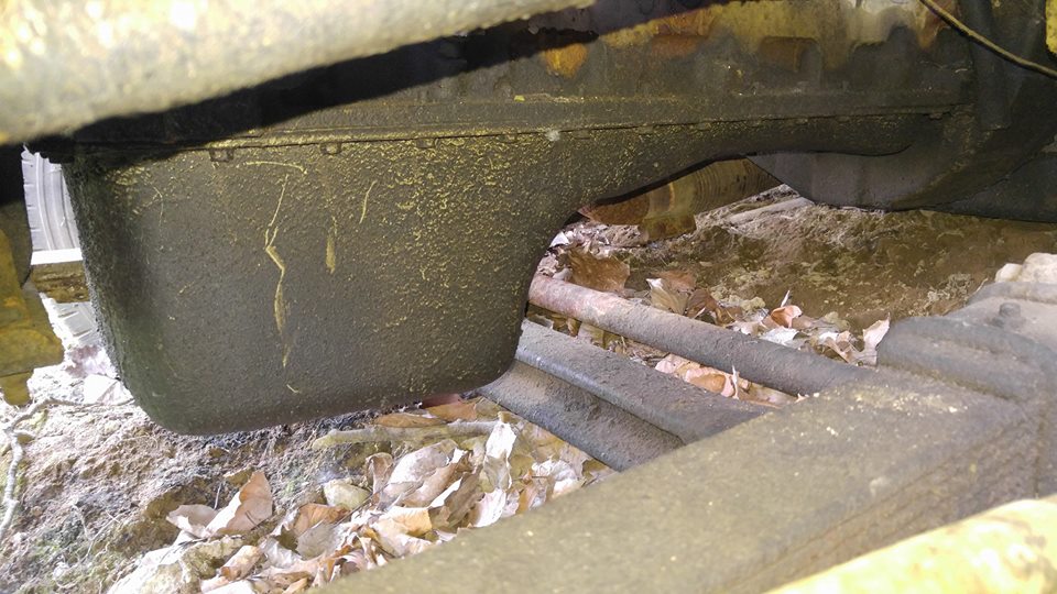

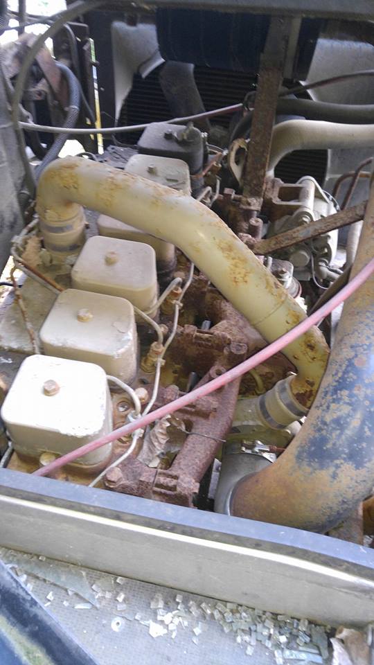

Anyway, found myself an engine!
Attached Thumbnails 1983 XJS v12 to Cummins build-cummins2.jpg   1983 XJS v12 to Cummins build-cummins1.jpg

Removed the stock front sway bar from the car today to make room for the oil pan from the 5.9.
I should be getting the engine tomorrow if all goes well!
Right now the jag has these ghetto *** chevy engine mounts in it from the last hillbilly that had it. They pulled their motor before they sold the shell to me but left the conversion mounts. I'm going to add some plating to the chevy mounts and move the mounting area of the cummins forward about 3 inches to put the oil sump between the front radiator support and subframe where it shouldn't have any issues. I removed the sway link to make room. I'm not going for a crazy lap timer if anyone hadn't guessed so im not too worried about the front bar missing. One of the contributing factors to the cummins' height is also that some motors have a pipe from the turbo to the intake that raises the engine height by almost 4 inches. I'm rotating the turbo and adding an intercooler to avoid that issue and gain some wiggle room. I had considered the rear sump idea but the power steering rack is on the back of the subframe and i did not want to risk damaging that in the process, and the front sump gives me more engine to firewall clearance.

xjs has engine bay does not have a lot of vertical clearance, i would bet a 5.9 is going to have the valve covers sticking threw the hood. also a extra 400lbs is a lot. of weight to add on the nose of the car. also front sump the engine is going to be way far forward. i don't see this working at all,

Major props to white shirt dude! he helped torch off the weird torque converter adapter and transmission adapter that was in the truck.
Also major props to my dad and my friend Jeff for their help in disconnecting it from the truck.
Engine needs some minor work, gonna do all the gaskets i can before i install it, wire wheel off as much rust as possible. spit shine it hopefully
