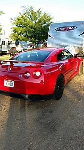

FLINT, in todays world of hard acceleration, its all about all-wheel drive, at least for the 1st 100ft or more!
pic of a 2017 Nissan GTR-Nismo AWD, nothing can beat it off the line , and i guess top speed also!
dynod 1400wheel HP(thats one thousand four hundred HP, plus it goes around corners , and stops very quickly,
Attached Thumbnails 1983 XJS v12 to Cummins build-20170818_193228.jpg   1983 XJS v12 to Cummins build-20170818_193240.jpg
