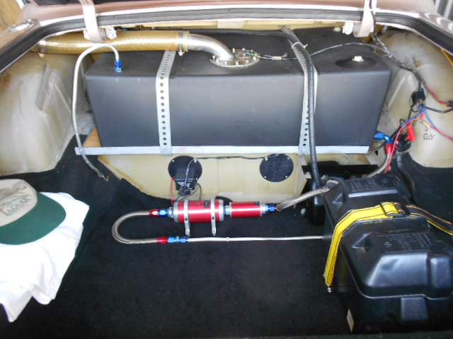

good idea, my original tank was full of rust!
so got a Nascar Plastic fuel cell 20gals, hi pressure filter and pump.
works great.
Attached Thumbnails 1983 XJS v12 to Cummins build-trunk-xjs-fuel-system-union-jack-001.jpg
Old Sep 18, 2017 | 06:11 PM
  #90
Pud's Avatar
Pud
Joined: Aug 2017
Posts: 68
Likes: 26
From: New Jersey
Awesome. How much pressure does that pump run? looks like there's no tilt to your tank.. how does it empty more? Or do you just not let it get that empty?
Looks great by the way!
my fuel system has a small gravity fill from the main cell,its a slosh tank, below the upper cell, mounted behind the battery, so its always full,, any bubbles returns to main cell bypass line,in pic.
also my setup is for gasoline, no reason it wouldnt work for diesel.
i happen to run 45psi for EFI, but VE low volume system around 4.5psi.
if you over pressure them they just shut off pump, holding the plunger off charge.
as you know never let a diesel run out of fuel, becomes a PITA.
i use a 1/2" inlet lines, and 3/8 return, but thats overkill! unless you runnin 3 turbos or sumthin silly!
